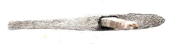

It won't be a shrink fit if a pin or key has been used.
It will be a press fit, ie, cut to a very neat fit, but not requiring heat to put in place over the pesi.
If you use a pin after a shrink fit, you actually run the risk of weakening the joint.
It seems that this whatever "sundang" was fit with (probably) a key, not really like a needle-sized pin. A flat key at one side of the square hole. (picture below)...
GANJAWULUNG
Old 1st April 2010, 11:38 PM   #35
Posts: 7,230
Thank you Pak Ganja.
I had a bit of difficulty in seeing the piece of metal used to tighten the ganja, so I have taken the liberty of playing with your image a little in order to clarify.
Please accept my apologies.
Of course no problem at all, Alan. The half round pin-hole near the flat key, do you think it was intentionally made for technical reason?
Thank you in advance, Alan...

Posts: 7,230
That half-round cut is where you would expect to find a keyway.
There are a number of possible explanations for it being there, but we cannot really say with any certainty why it is there.
If the blade is truly old and genuine, something that from the photos I am inclined to doubt, the original fit of ganja to pesi may have been done with keyway and key (pin), on the other hand, if it is not old and genuine, perhaps the maker may have tried to fit with a key, but found he had made the ganja hole insufficiently neat to allow a key fitting, so he resorted to using a slip, or a wedge of metal, as we can see.
