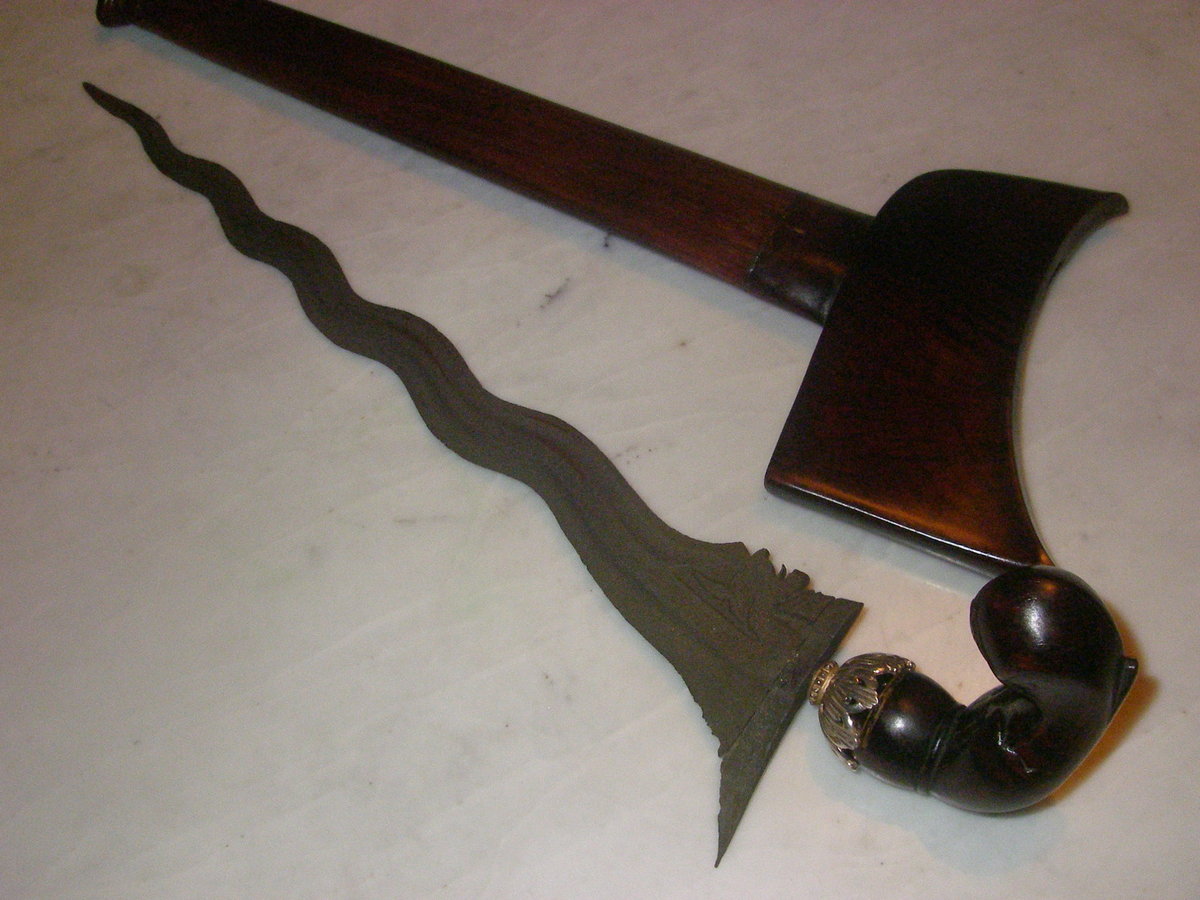

Alam Shah, Greybeard and David, thank you for the comments
David, I have really no experience with this. I thought, it would be a peninsular keris.

Hi Gustav, it is indeed a very nice keris naga bugis, you got there. It has all the features of naga that is almost similiar to mine with the distinctive 3 "clove of leaves" on top the naga head. Congrats

Are the blades tempered (sepuhan)? for such Bugis type blades with no pamor, the temper mark shd be fairly obvious.

Btw, from the dress and hilt, these do not look like peninsula kerises.

Likely to be Sulawesi, judging from the bulge in Gustav's keris sheath, and hilt.

Sumatra was going to be my guess on Gustav's keris based on the style of the greneng, but i wouldn't place a bet on that.
As i know many of us are already aware, dress does not necessarily reveal the origin of the blade itself.

Hello Blu Erf,
could such greneng be expected from Sulawesi?
Sulawesi kerises tend to have bigger greneng. The one on your blade is unusual for Sulawesi. I've seen some of these keris blades attributed to Sumbawa, but then again, this is not verifiable.

I based my observation on a Sumatra blade that i have that has very similar greneng both in form and size. I have rarely seen greneng on Sulawesi keris at all.

Blu Erf,
there is no temper mark on my blade.

the keris from Tengkurizan collection is descripted as Riau Bugis, but you are wright, such greneng recalls a "Sumbawa feeling". Is the hilt probably Banjarmasin?

In any case, the greneng on my keris seems to be smaller then every bugis I have seen...

Ah yes, I didn't notice the description But I've not really seen such kerises from the Riau region.
I do not know where the hilt comes from.

But even if this were a "typical" example you must admit that it is not really all that "common" to find greneng on Sulawesi keris.
And it is nothing like Gustav's example so i am curious why you think his keris is from Sulawesi. Is this just based on the dress form?

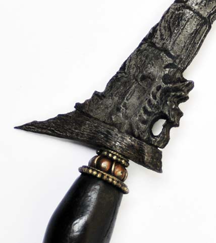

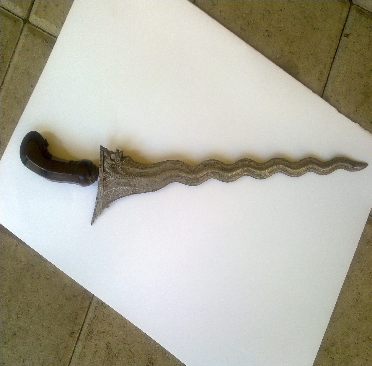

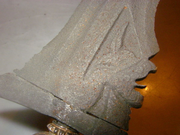

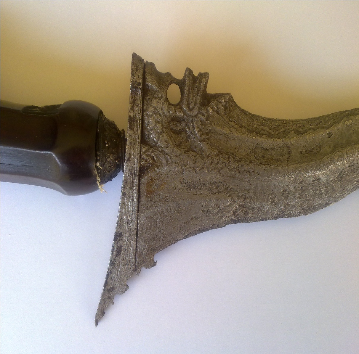

Now I can post some pictures of my Naga (Seluman?) keris -- old or recently
Maduran made?
Heinz

Yes, Naga Siluman (you may spell it too as 'seluman', although the correct spelling is 'siluman') Luk Tigabelas (13 luks). But surely, this is a javanese naga, I don't think it is Pattani.
Usually we count the luks, because the common Naga Siluman comes with 7 luks. But some Naga Siluman has possibility to have 9 and 11 luks too. Even yours is 13 luks. As does "carita" dhapur which usually 11 luks but some caritas also possible to have 15 luks (carita buntala) and 17 luks (carita kalenthang).
In daily chat among collectors in Jawa, this type of naga ornaments we call it as "naga primitif" (primitive naga), simple naga ornament. And the disappearing of the naga body -- we call it "naga siluman", invisible naga...
Could be old, could be recently made, it depends on the real keris in hand. I have the similar primitive naga, but not in keris size. Only palm-sized keris, or small patrem (pictures below), an amulet type of keris with rough naga carving...

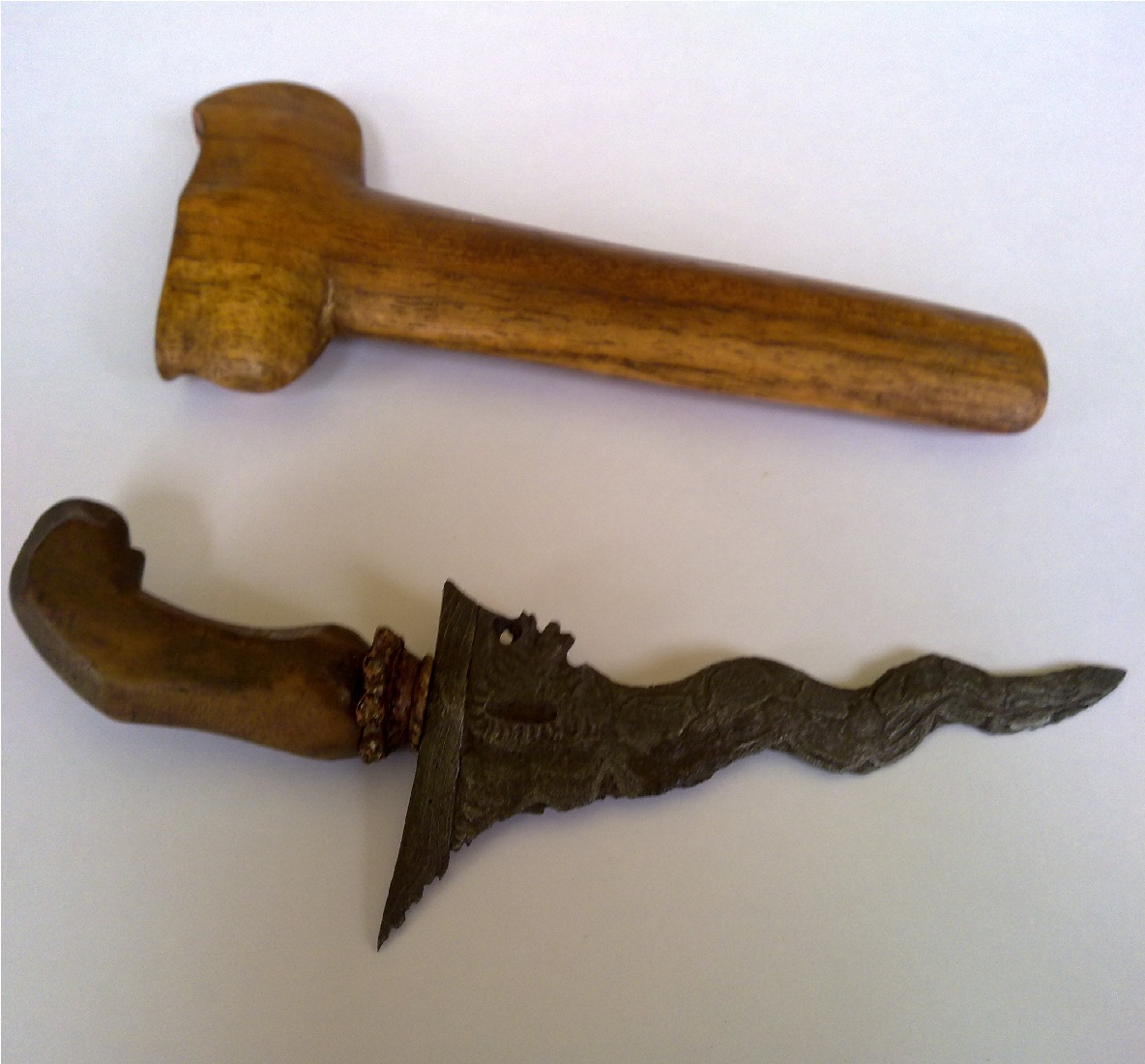

Hello Ganjawulung

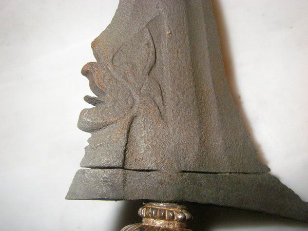

Naga Siluman or Naga Seluman -- I'm aware of both terms, but I never knew which is the correct one. Thank you for clarification. Then I have a keris
Naga Siluman with "too many luk" ...

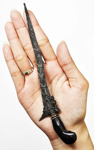

My 5-luk "Jimat" keris (length of the blade without pesi: 11 cm) shows the same style of "Naga primitive". Interestingly, when looking at this relief upside-down there seems to be a human face in profile ...
Heinz

Naga Siluman or Naga Seluman -- I'm aware of both terms, but I never knew which is the correct one. Thank you for clarification. Then I have a keris Naga Siluman with "too many luk" ...
No Heinz, I don't think 13 luks are too many for javanese keris. The number of luks in javanese kerises commonly until 13. And from 15 luks or more, we call it as "keris kalawija" or anomali kerises, and does exist. Dhapur of Naga Sasra, Naga Lare and Naga Penganten also comes with 13 luks. It is still common, Naga dhapur with 13 luks...

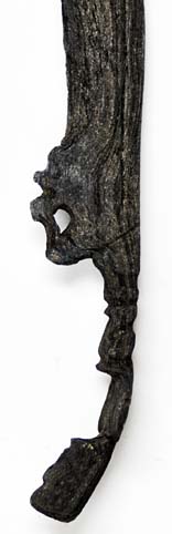

The primitive motif of this old cundrik -- a variant of sajen kerises -- also reminds me of the primitive motif of Naga. Or human head, under the Puthut? Just for comparison...
GANJAWULUNG
GANJAWULUNG
Very interesting! I wonder if this Naga type (or human head) has a special magical meaning or purpose.
