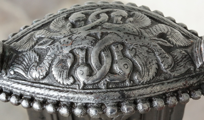

What you can often learn a great deal of is, if you take details. You will often see things, which you have not seen at first.
