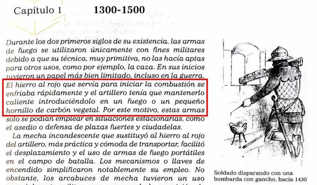

Just for fun, let me here post an image of a 1430 century soldier shooting his gun with the help of a hot iron, as a support illustration to the folowing (Spanish)text:
The glowing iron which served to initiate the combustion would quickly cool down and the artilleryman had to keep it hot, introducing it in a fire or in a little stove of vegetable charcoal.
This comes in a digestive book on early firearms by Vladimir Dolinek

Thanks for the interesting image. I have already seen it somewhere else here in the forum.
Primarily I am investigating for contemporary historical sources of such charcoal pans or fire vessels for heating up the hot irons, either as written form, illustrations or archaeological finds. The image seems to be a 19th century or later one and most of such "modern" illustrations are carrying slight modern interpretations.

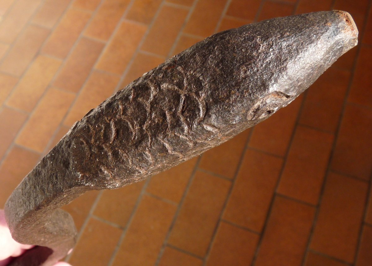

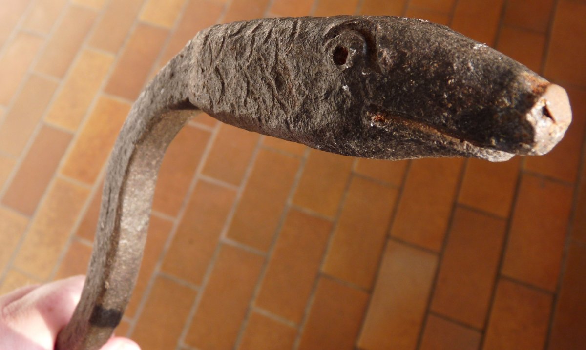

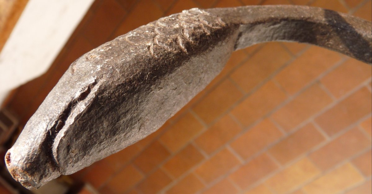

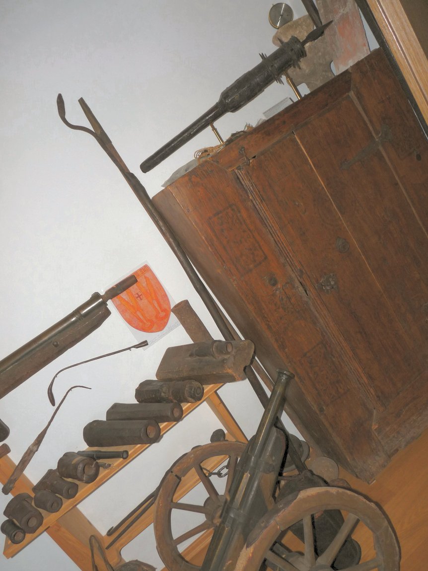

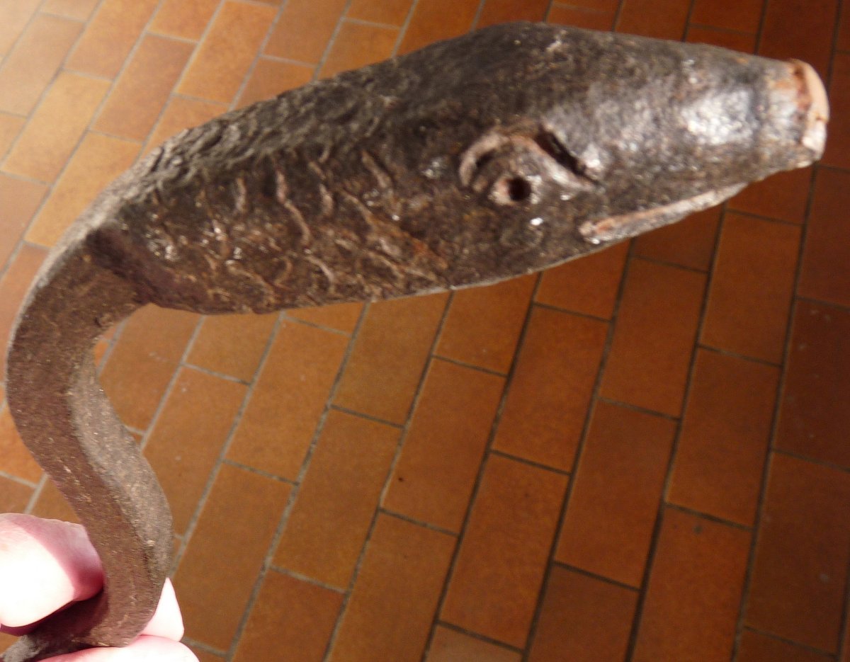

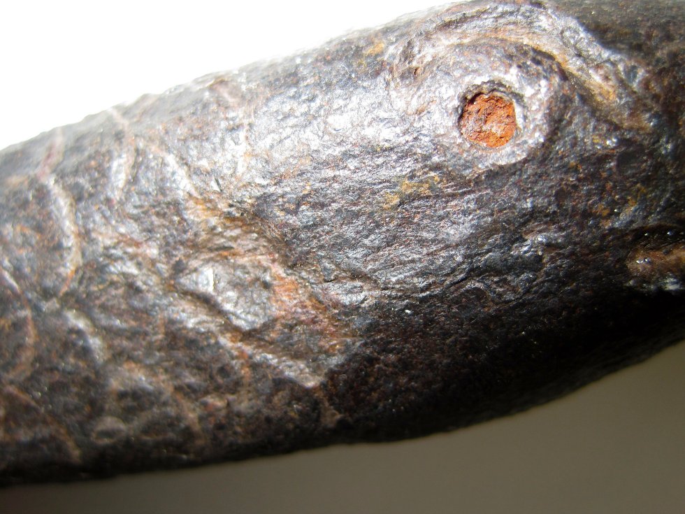

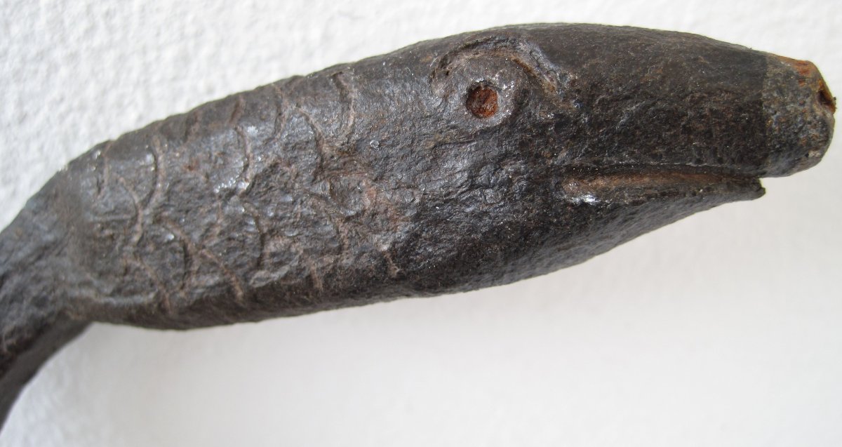

An unusual igniting iron finely carved to convey the impression of a sea monster's head with scales, eyes and mouth, 1st half 16th century; originally protruding from that mouth was an igniting prick to enter the pan and touch hole. On an old haft.
Leaning in the center of the first photograph, against an early-16th c. sacristy cupboard, next to my earliest handgonnes, and behind my small Giech cannon of ca. 1520.

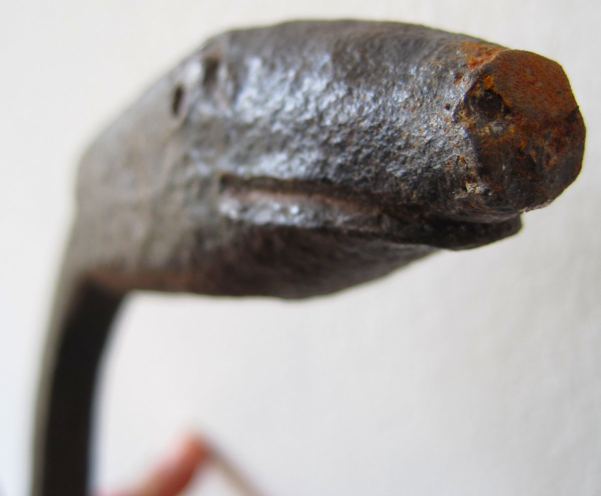

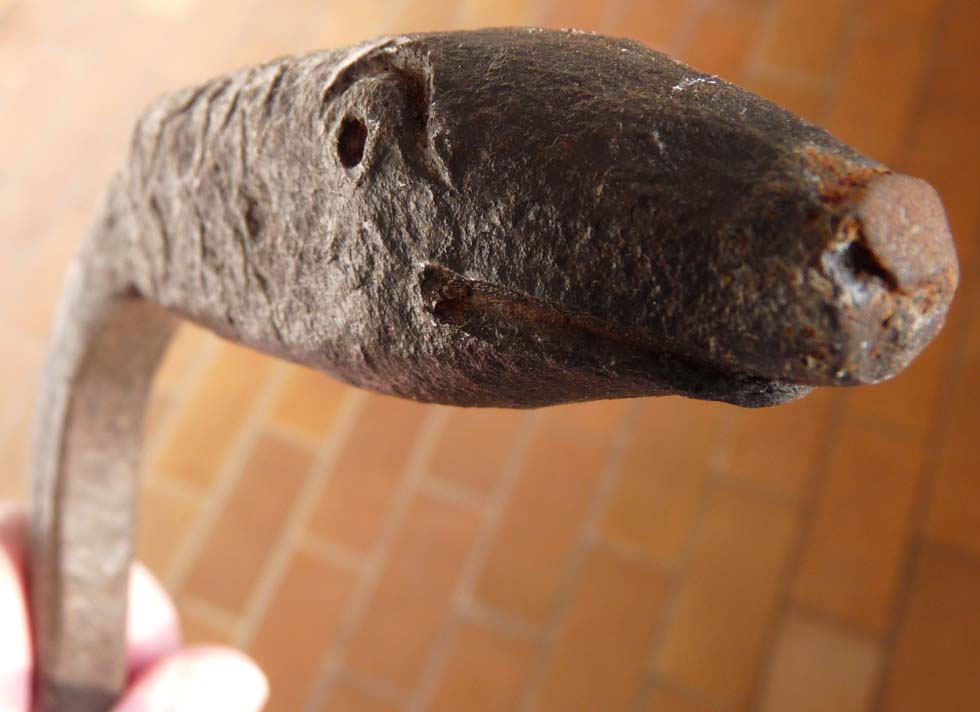

Just started reading this thread (again) and remembered this one. It was for sale at thomas del mar but was later withdrawn for unknown reasons (at least unknown to me).
Luckily i learned (somewhere ) to save items of interest, which was not a bad thing seeing as all the information was gone just a few days after the catalogue was put online.
It is missing the original haft but seems in otherwise good condition apart from it beeing a bit shiny for a "17th century" item as stated by the auctioneer.
