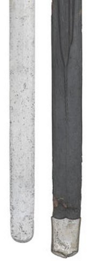

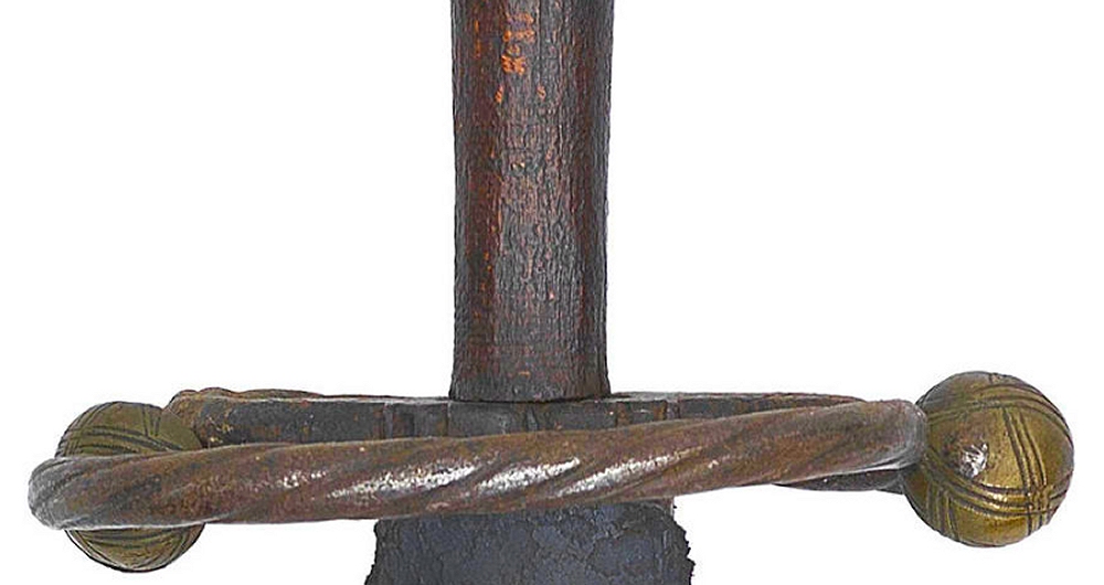

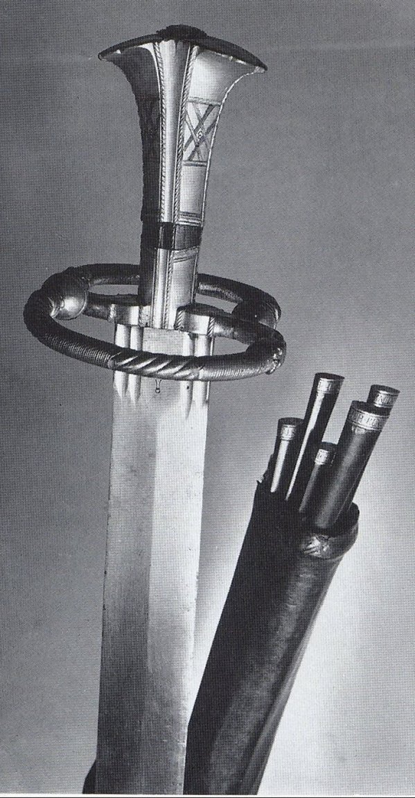

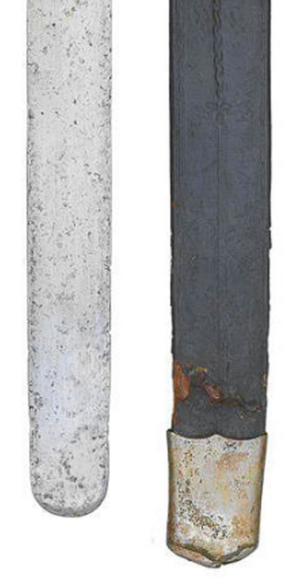

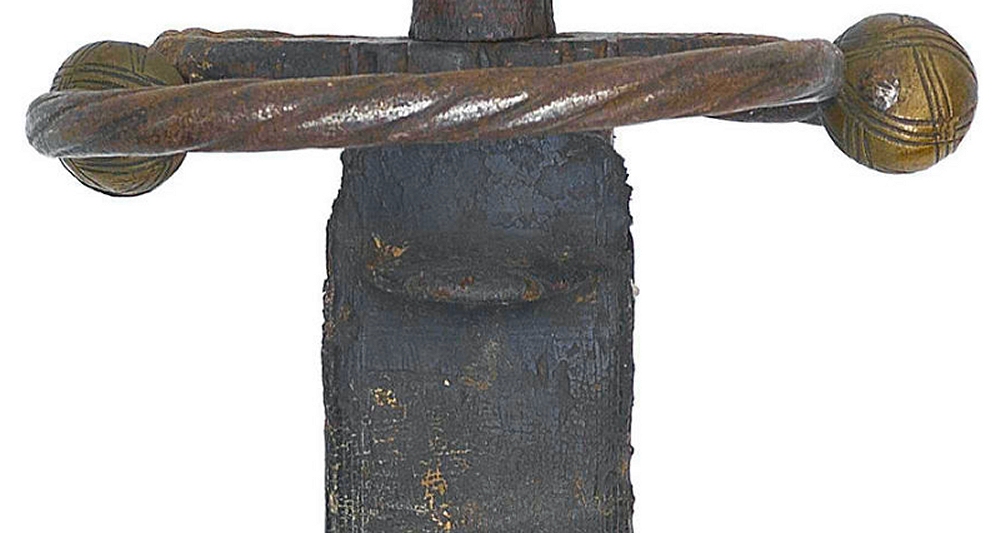

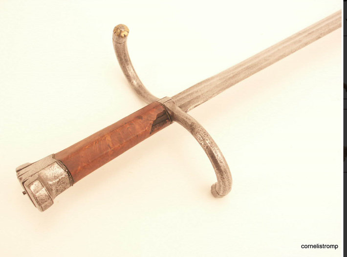

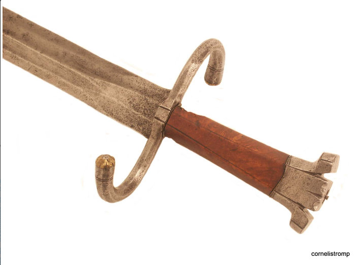

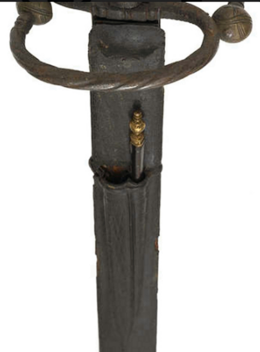

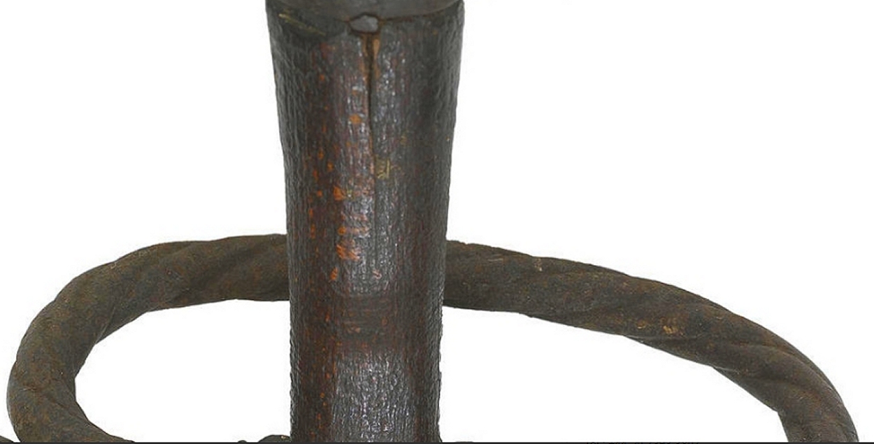

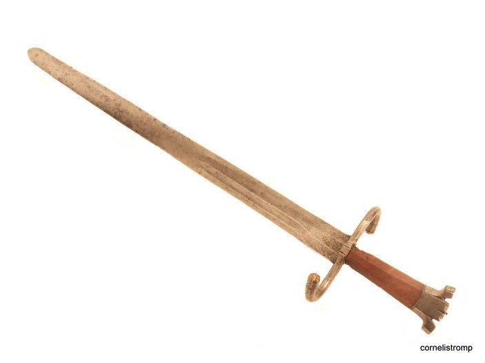

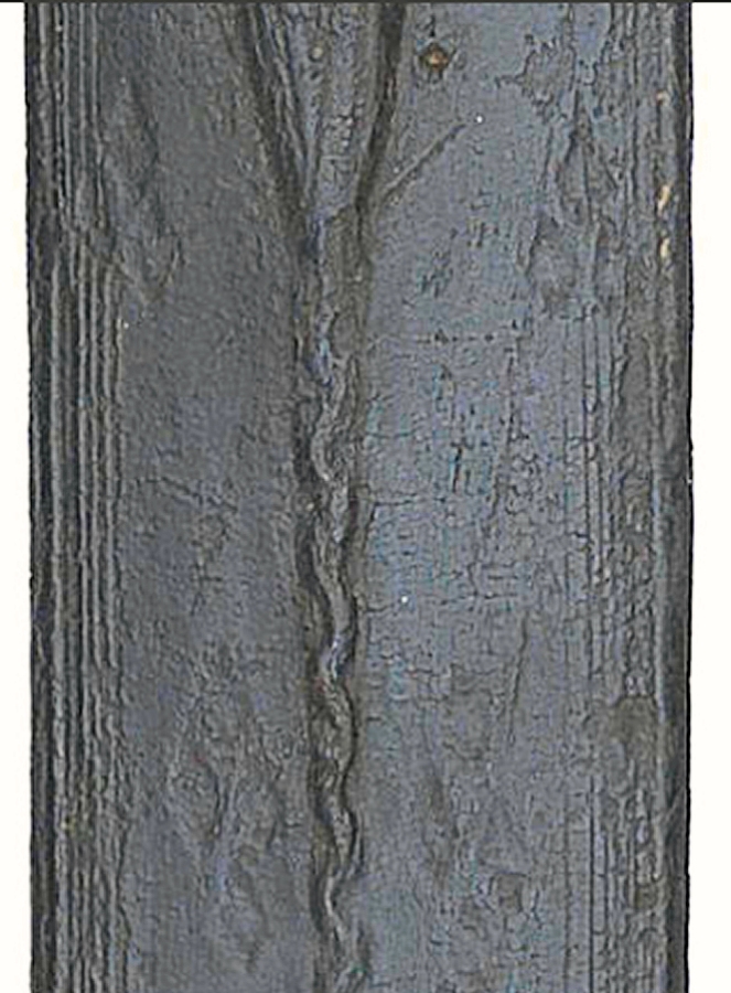

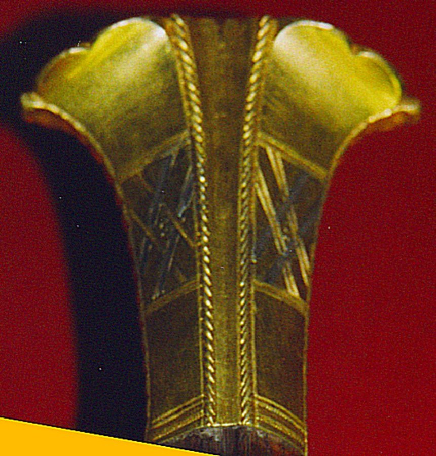

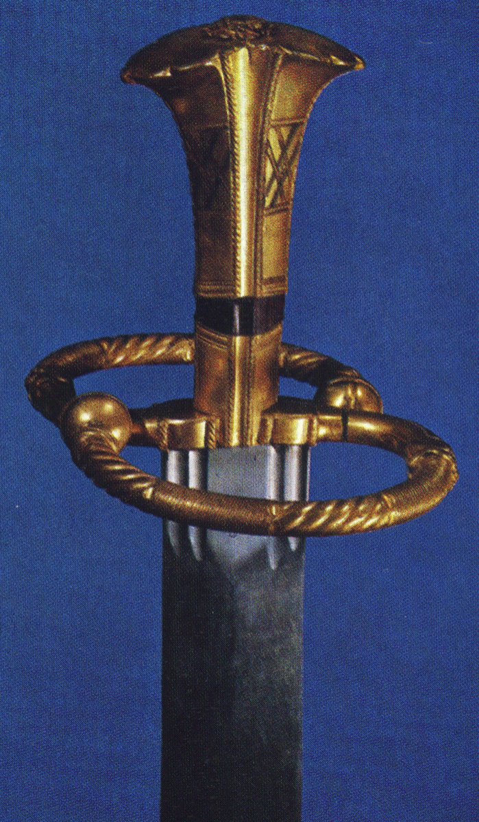

found that these Katzbalger has been in the collection of the MET!
donated to higgins armory now sold or perhaps part of the weapons acquired by Worcester Art Museum, who can tell?
See the pictures from the metropolitan museum, here the blade looks still beautiful ?
looks like someone has cleaned it too much with the wrong tools for the job and thus destroying evidence and patina.
Indeed, The MET also dates the Katzbalger around 1500.
Details
Accession Number3130
OriginProbably Germany, late 1400s-early 1500s
MaterialsSteel; brass; briar wood
MeasureO.L. 34"; blade L. 28";
blade width at hilt 1 13/16"Weight2 lb. 2 oz
Description
Infantry sword of the so-called Katzbalger type. Double-edged steel blade of hollow ground, flattened octagonal section tapering slightly to bluntly pointed spatulate tip. Ricasso of flattened rectangular section with 3 shallow, wide fullers on each face, becoming pointed & continuing as pair of fullers extending 1/3 of length of rest of blade. These are about 8" in overall length, and pointed at their ends. Pressing toward the tip, the blade becomes flat and lenticular, tapering gently and slightly to the point. One face is marked as noted under "marks". "S"-shaped octagonal section crossguard recurving in plane of blade, with domed, brass capped terminals. Quillon block, terminals of guard, brass caps have deeply incised line decoration. 1-piece briar wood grip of hexagonal section, widening towards pommel. The side faces are accented by cut axial lines at the angles. The grip is insulated at the ends by thin sheets of brass plate. There are no signs of a covering having ever been in place. Steel pommel, hexagonal at base & expanding into flattened mushroom-shape at end which is deeply cut into 3 sections. Where the blade tang passes through the pommel body there is a shallow rectangular cavity that might well have once held a finial both decorative and functional.
Curator's Comments
The swords appear widely in Germanic art of the day, depicted by famous artists such as Hans Baldung, Lukas Cranach and Urs Graf. Tip has been shortened. The cog-like brass mark on the blade is simialr to that which appears on an Italian roncone, of ca. 1510 in the Museo Poldi-Pezzoli (see Boccia and Godoy, p. 149, no. 461; this reference also notes similarly marked halberds given as German and Swiss, in Leningrad, Bern and Rome.) Katzbalger swords appear widely thoughout German art of the first half of the 16th century. Among other sources, see Lukas Cranach's woodcut of a Landsknecht, ca. 1510, at Dresden (Schade, Cranach..). The name is the source of some debate, but it was probably derived from a slang verb (katzbalgen) meaning to tussle ("mix it up"), or fight at close quarters. The open S-shape of the crossguard of our piece suggests an earlier date for the example, perhaps as early as the late 15th century. In its general form and execution it should be compared to that of a dagger given as Swiss (?) from the beginning of the 16th centuiry in the Odescalchi collection, inv. no. 1312. Rather similar hilts are depicted on the Harsdorfer gold and gem scale of 1497 (the footsoldier to the left of the arms as viewed; Gothic and Renaissance Art.., cat. no. 77) and on the St. Sebastian altarpiece by Hans Baldung Grien, 1507 (as worn by the yellow-clad archer in the right foreground of the main panel, ibid., cat. no. 178). The kriegstagesbuch discussed by Dilke and Closs shows rather similar hilts in figs. 5, 8, 9, 12; this work dates from the end of the 15th century, and in 1929 was preserved in the Thuringian State Archives, Weimar.
Bibliography
Claude Blair and Leonid Tarassuk (eds.), The Complete Encyclopedia of Arms and Weapons (New York: Simon and Schuster, 1982), p. 294.
Lionello G. Boccia and Jose-A. Godoy, Museo Poldi Pezzoli, Armeria I (Milan: Bramante Editrice, 1985), p. 149, no. 461.
Nolfi di Carpegna, Le Armi Odescalchi (Rome: DeLuca Editore, 1976), p. 37, cat. no. 210.
Guy F. Laking, A Record of European Armour and Arms.., vol. II (London: G. Bell and Sons. Ltd., 1920), p. 299, fig. 679.
Donald J. LaRocca, "The Renaissance Spirit," in Swords and Hilt Weapons (New York: Weidenfeld & Nicolson, 1989), p. 47.
A.V.B. Norman and C.M. Barne, The Rapier and Small-sword, 1460-1820 (London: Arms and Armour Press, 1980), p. 66, hilt 3.
Werner Schade, Cranach: A Family of master Painters. Transl. Helen Sebba (New York: G.P. Putnam's Sons, 1980).
Heribert Seitz, Blankwaffen I (Munich: Klinkhardt und Biermann, 1965), pp. 134, fig. 76, no. 28; fig. 77, no. 34; 135, fig. 77, no. 40; 173; 175, fig. 111.
The Metropolitan Museum of Art, Gothic and Renaissance Art in Nuremberg, 1300-1550 (New York: The Metropolitan Museum of Art, 1986), cat. Nos. 77, 178.
Helene Dilke and Adolf Closs, "Das Kriegstagesbuch eines deutschen Landsknechts und die Wende des 15. Jahrhunderts," ZHWK, n.F. 3(12) (January 1929): 1-11.
Publication & Exhibit History
Photographed while in collection of the Metropolitan Museum of Art, neg. no. 26624

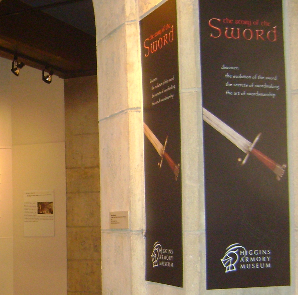

Originally Posted by cornelistromp
... donated to higgins armory now sold or perhaps part of the weapons acquired by Worcester Art Museum, who can tell? ...
Still highlighted by the Higgins (during my visit) on September 2012 ... before this museum tragic end .

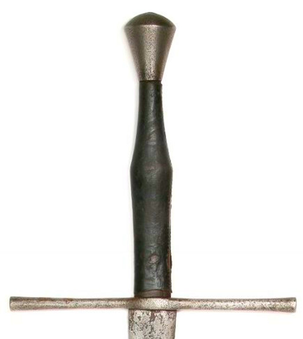

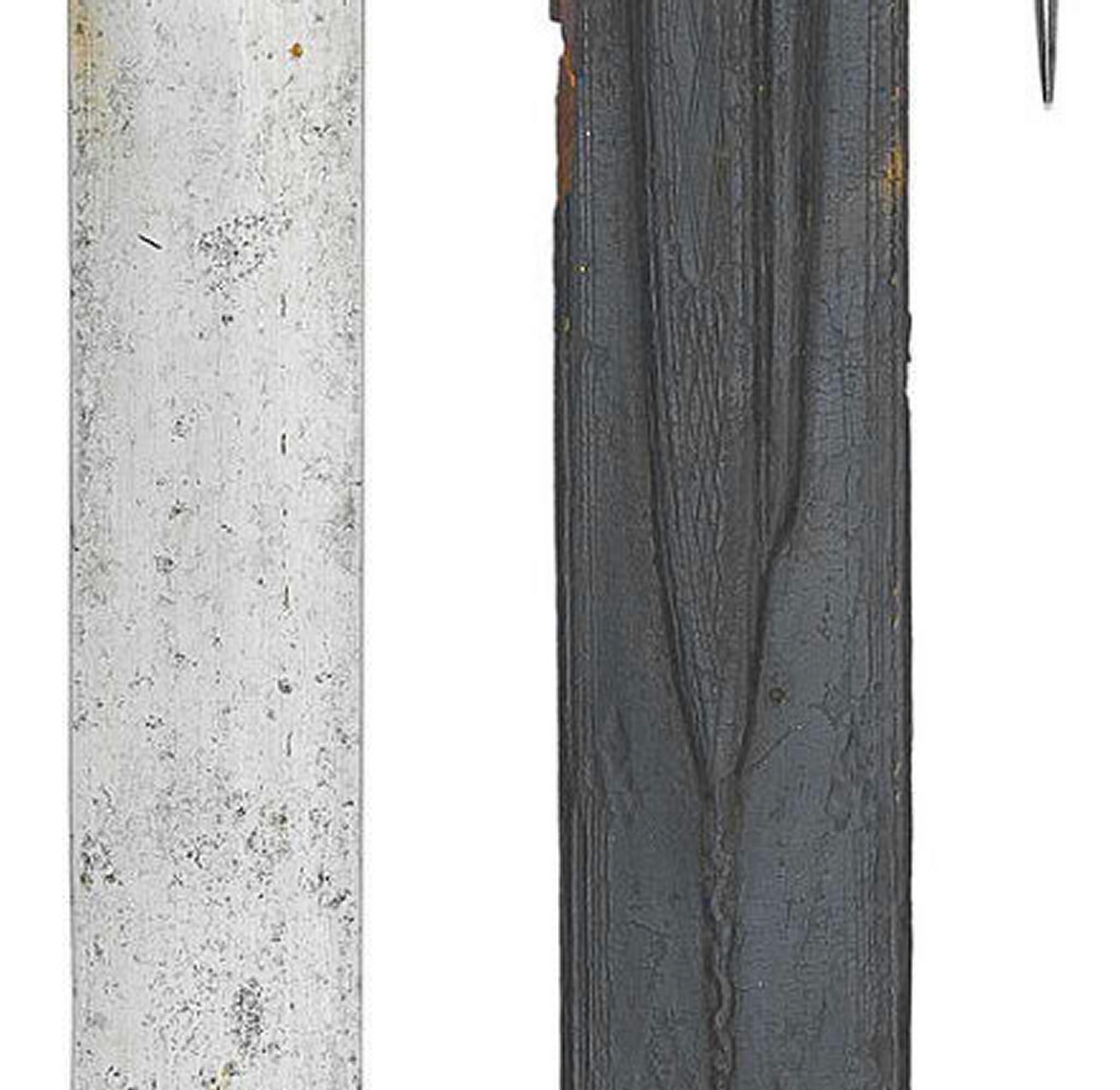

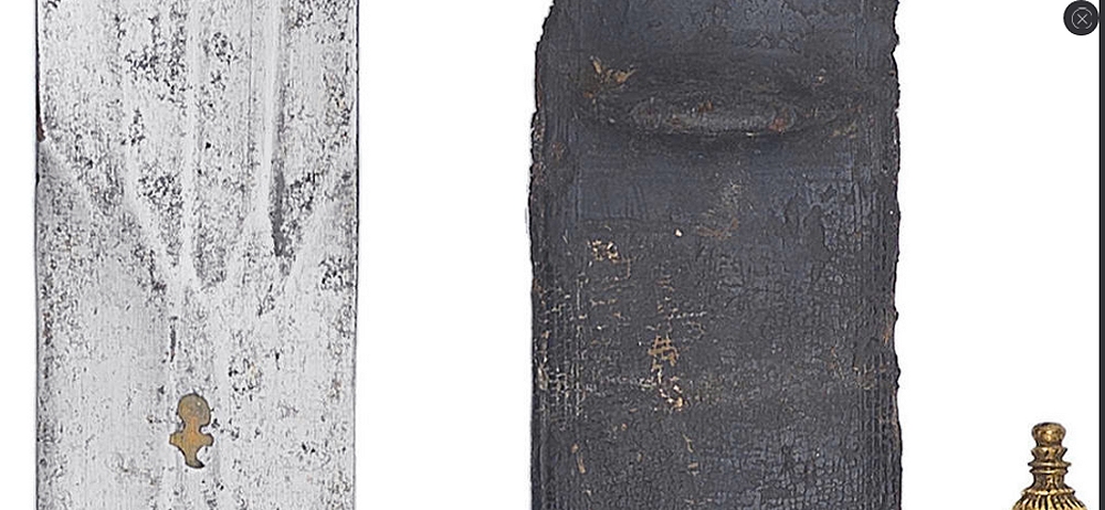

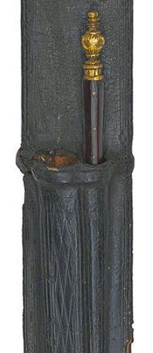

I would like to add this Late-Gothic, 2nd half 15th c. hand-and-a-half sword to this thread as it was still in use as a period companion together with the earliest Katzbalgers.
It was sold Bonhams, 26 November 2008, lot 274.
Best, Michael

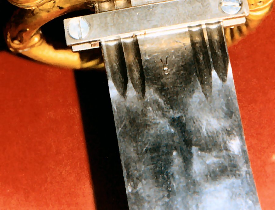

I knew you did but alas I am unable to look at that mark as any shape of the cypher 4, whether Gothic or non-Gothic.
That however seems to be a problem of personal identification on my side.
m
Old 11th January 2014, 06:40 PM   #403
cornelistromp
cornelistromp's Avatar
Join Date: Mar 2009
Posts: 1,071

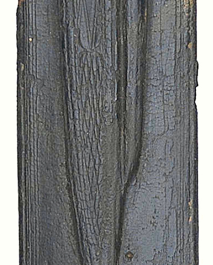

m

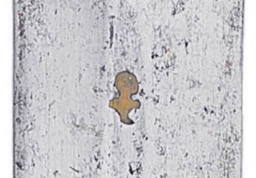

maybe this close up picture helps.
best,
Old 11th January 2014, 08:35 PM   #404
Matchlock
Matchlock's Avatar
Join Date: Sep 2008
Posts: 4,310
That did help indeed, thank you.
I would not call that a classic non-Gothic numeral 4 though.

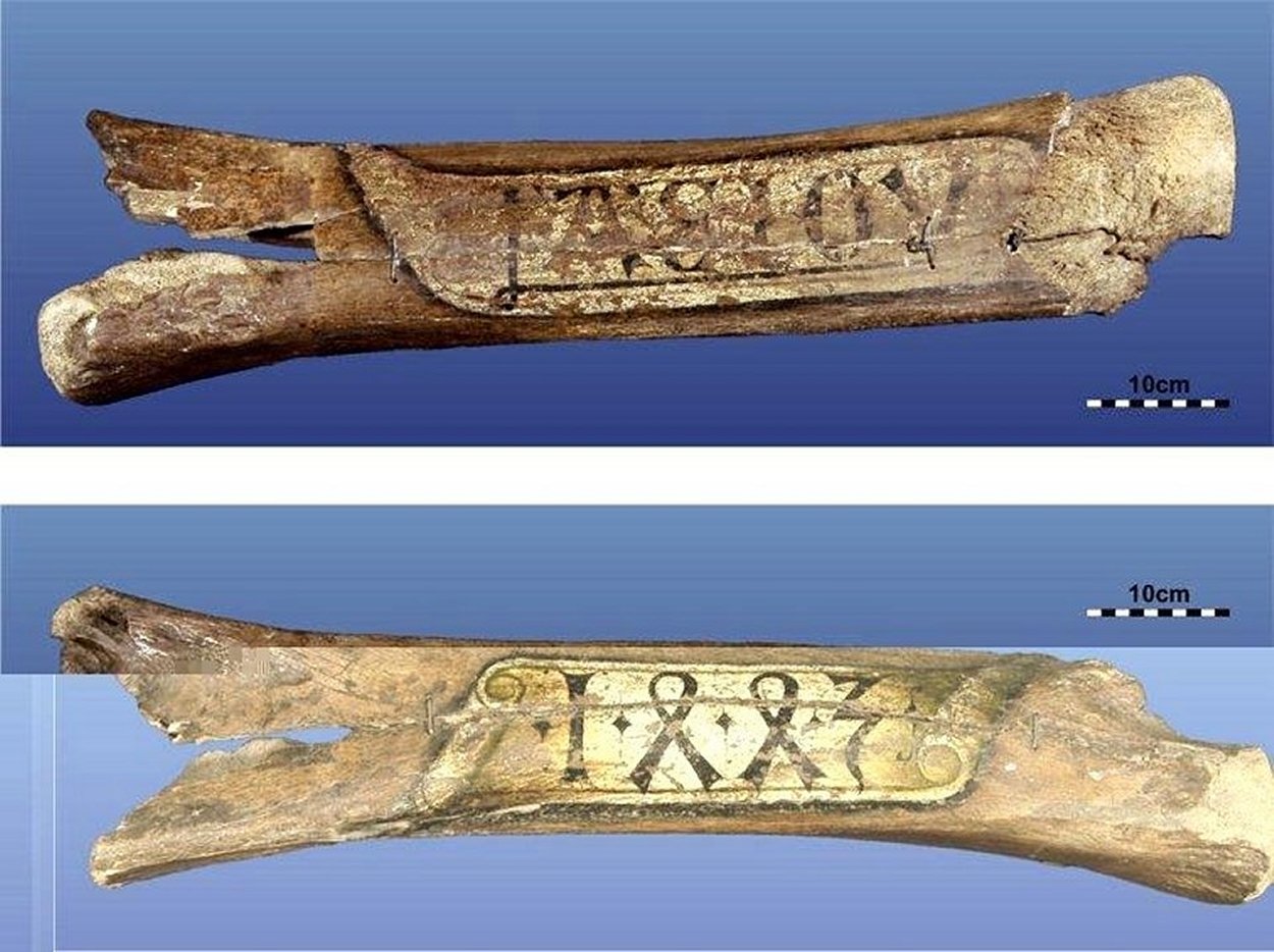

Most medievalists will agree that the Gothic numeral 4 in its 'typical' version is often misread as the upper half of the cypher 8, which actually is not true. In fact, '4' has only been turned to the right by 90 degrees since the 15th century and turned back to its present position again in the course of the first half of the 16th century.
If you look at it that way, the 'position' of the numeral 4 on the blade of that Katzbalger may well be alright, just not not quite what one would expect 'characteristically' and 'ideally'.
In order to illustrate how much the position of numeral 4 could vary - until the 'modern' version! - during the whole 15th c., I attached the following samples:
1407 (founding table of the Church of the Holy Spirit, Landshut, Bavaria), very unusual!
1436 (hatchment, Swiss National Museum Zurich)
1443 (bone of a mammoth, an inexplicable curiosity in the Gothic period)
1460 (mirrored version of numeral 4, on the crossbow of Ulrich of Württemberg, Metropolitan Museum of Art, N.Y.), unusually mirrored!
1478 (source unknown)
1481 (Old City Hall, Regensburg, Bavaria)
1481 (wrought-iron hackbut barrel, Munich; in my collection, and two nearly identical samples in Oberhaus Castle, Passau, Lower Bavaria):
http://www.vikingsword.com/vb/showth...=haquebut+1481
1481 (painting by Michael Wohlgemut), unusually modern!
1499 (Albrecht Dürer, Nuremberg, whose style was extremely 'advanced' in his time, on his portrait of Oswolt Krell)!
As you will see, no absolutely strict rules can be set up for a certain representation.

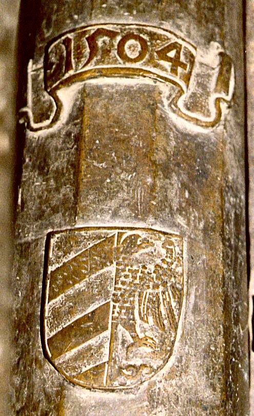

1474 (ratched of a cranequin, Probus sale, Stockholm 8 Nov 2010)
1488 (church in Haimhausen, near Munich, Bavaria)
1499 (painting by Michael Wohlgemut, at the threshold to the Early Modern Age)
1499 (model of a fire engine, Germanisches Nationalmuseum Nürnberg)
1493 (epitaph plate, former Figdor colln., Vienna)
1493 (another, from the same source)
1497 (Nuremberg)
1504 (Nuremberg bronze cannon barrel, town museum in Weismain, Bavaria)
1514 (Bülach, Switzerland), old style!
1514 (painting by Lucas Cranach, Dresden), modern style!
1547 (Salzburg, Austria)
1548 (bone plaque on a wheelock arquebus, Tojhusmuseet Copenhagen)
1548 (same gun)
1554 (blade of a Flamberg two-handed sword, town hall museum Stein am Rhein, Switzerland), Gothic style!!!
Once again, a great bandwidth of varieties is documented, and almost any style of representation may have been possible!
In traditional and far-off countries like Switzerland, the obsolete Gothic style prevailed even in the Renaissance epoque until at least the mid-16th c.!
m

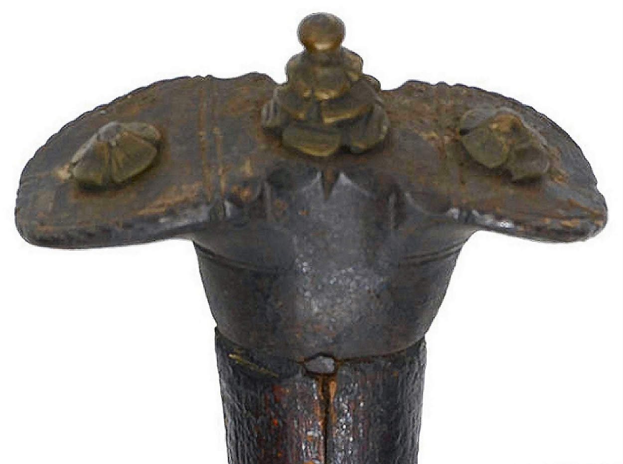

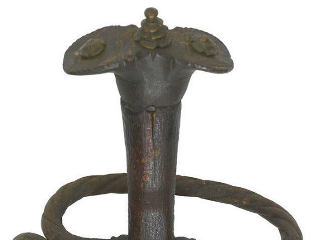

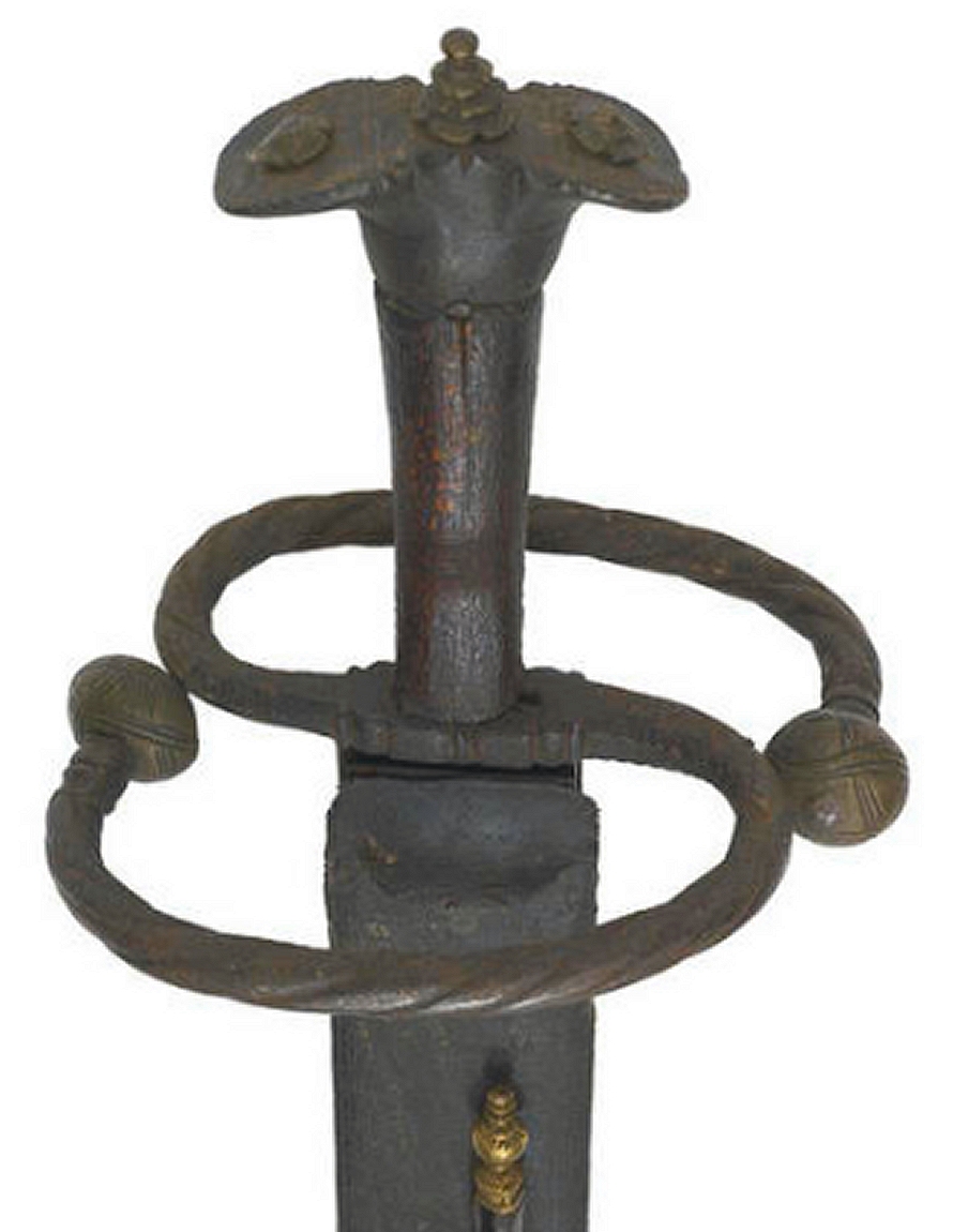

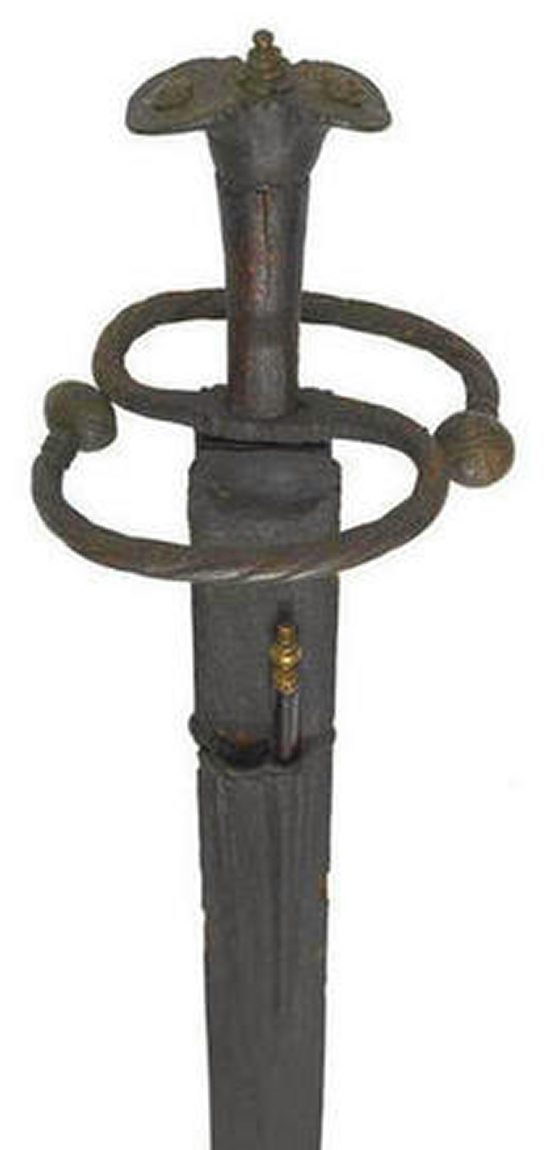

Default The Finest and Most Important Katzbalger for Sale - EVER!
Hi there,
Today, I must ask for understanding, for not posting here for such a long time.
In addition to computer problems that have not been solved yet (my machine will be off
for a week for a general check), my fingers are getting paralyzed more and more every day; the diagnosis might beAmyotrophic lateral sclerosis (ALS), the motor neuron disease that Stephen Hawking has. Even eating with a knife and fork has gotten very hard - and so has typing.

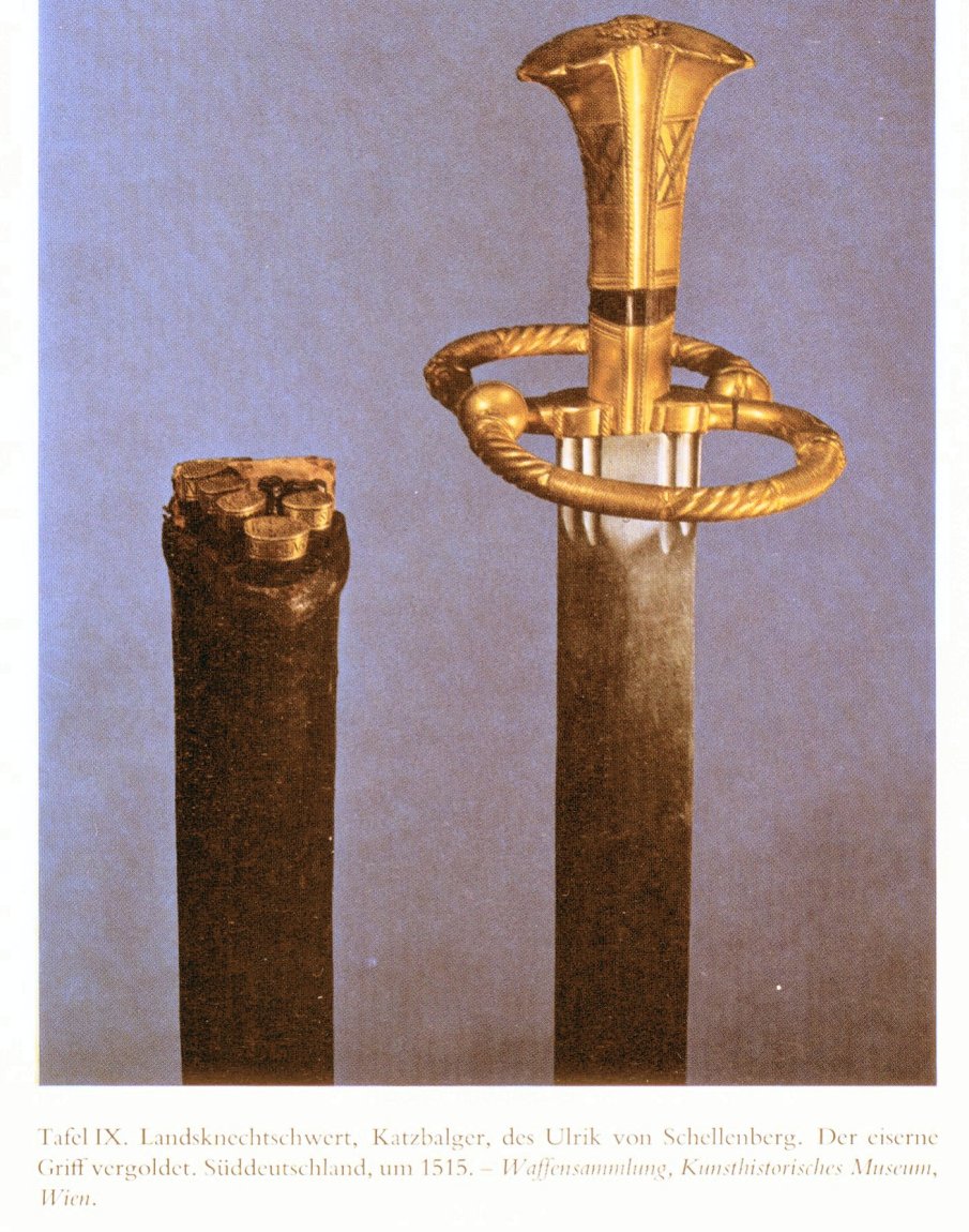

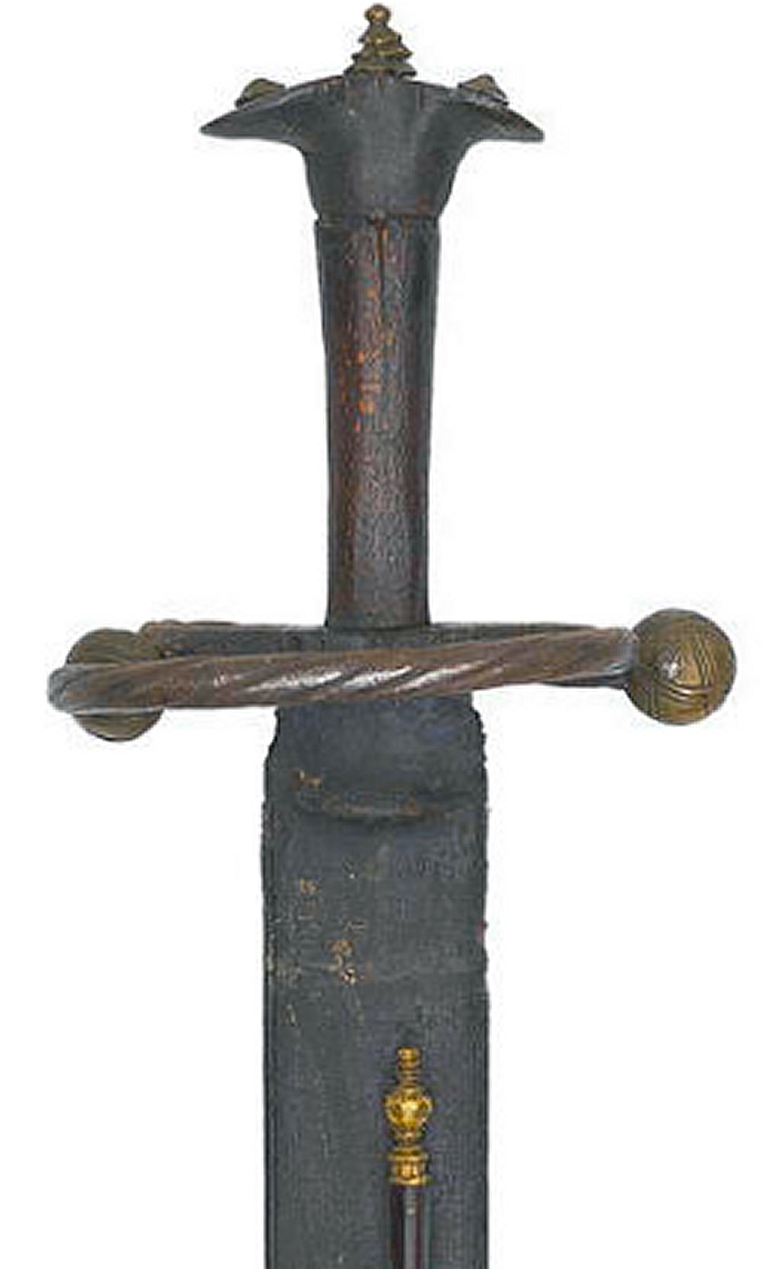

Nevertheless, here I present the finest preserved and most important Katzbalger to have been for sale ever. It is closely related to the famous specimen made for Ulrich von Schellenberg (now in the Vienna Armory, the Kunsthistorisches Museum Wien, and fetched a fantastic price with Bonhams on 26 November 2014.

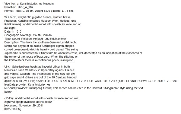

You will remember Ulrich von Schellenberg's Katzbalger from my earlier posts in this thread, and find further images down here.
Like that museum sample, the one in discussion also retained its original tooled sheath/scabbard together with a bodkin (the original by-knife missing).
Please note that the chape of the sheath is a 17th century replacement.
The pommel of the bodkin is made en suite to match that of the sword. A bodkin served at least two purposes: picking up food at a meal, and working as an awl or prick; for the latter task, it is pierced to receive a thread for sewing, allowing the Landsknecht to repair his clothes.
As I have often pointed out, the early Renaissance period was, among others, characterized by a great variety of combinations of weapons and tools.
Best as ever,

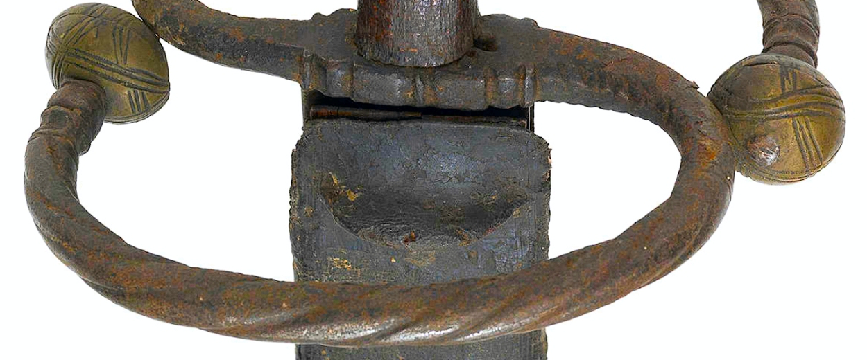

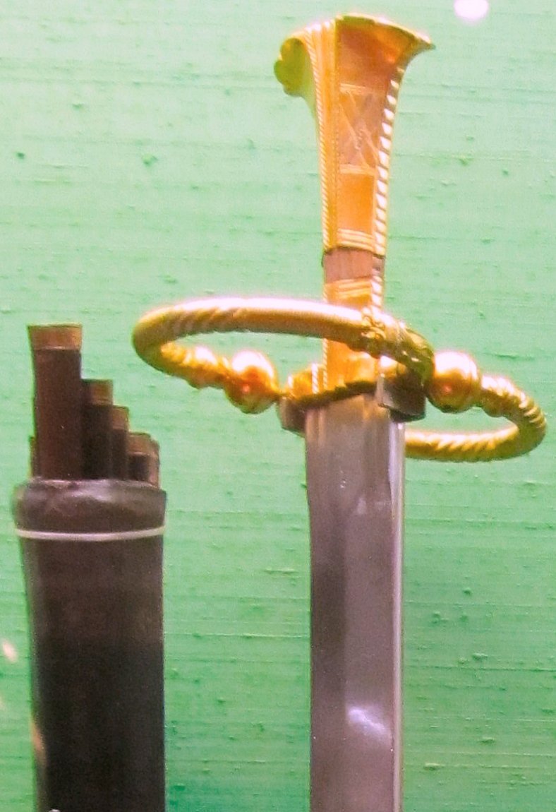

A few more views of the Schellenberg Katzbalger, followed by the Bohmams specimen.
When regarding the two oak wood plates forming the grip please note that originally, they were covered by a cord binding which was hidden beneath tooled leather.
m

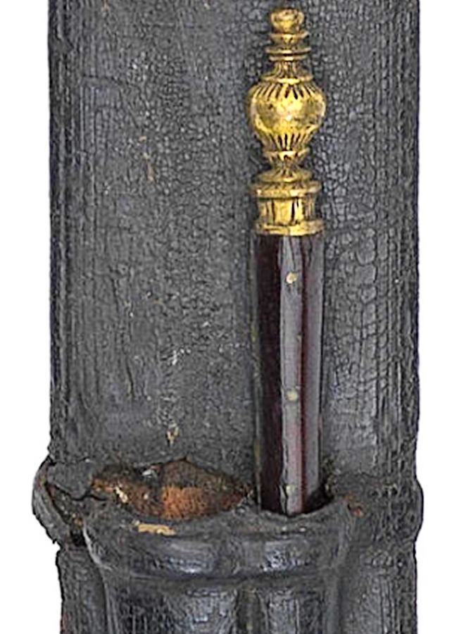

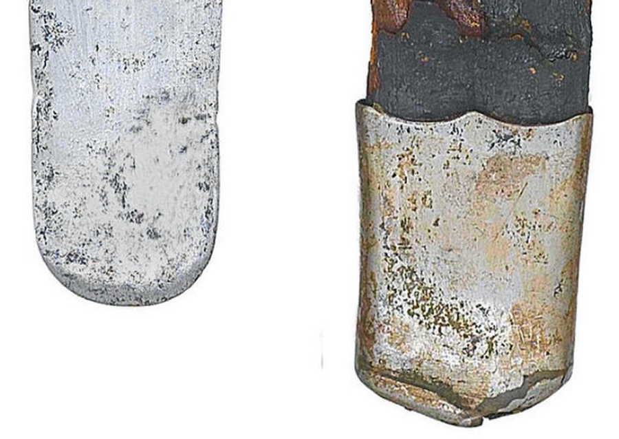

Lots of detailed close-up studies.
Old 29th November 2014, 02:03 PM   #419
Matchlock
Matchlock's Avatar
Join Date: Sep 2008
Posts: 4,310

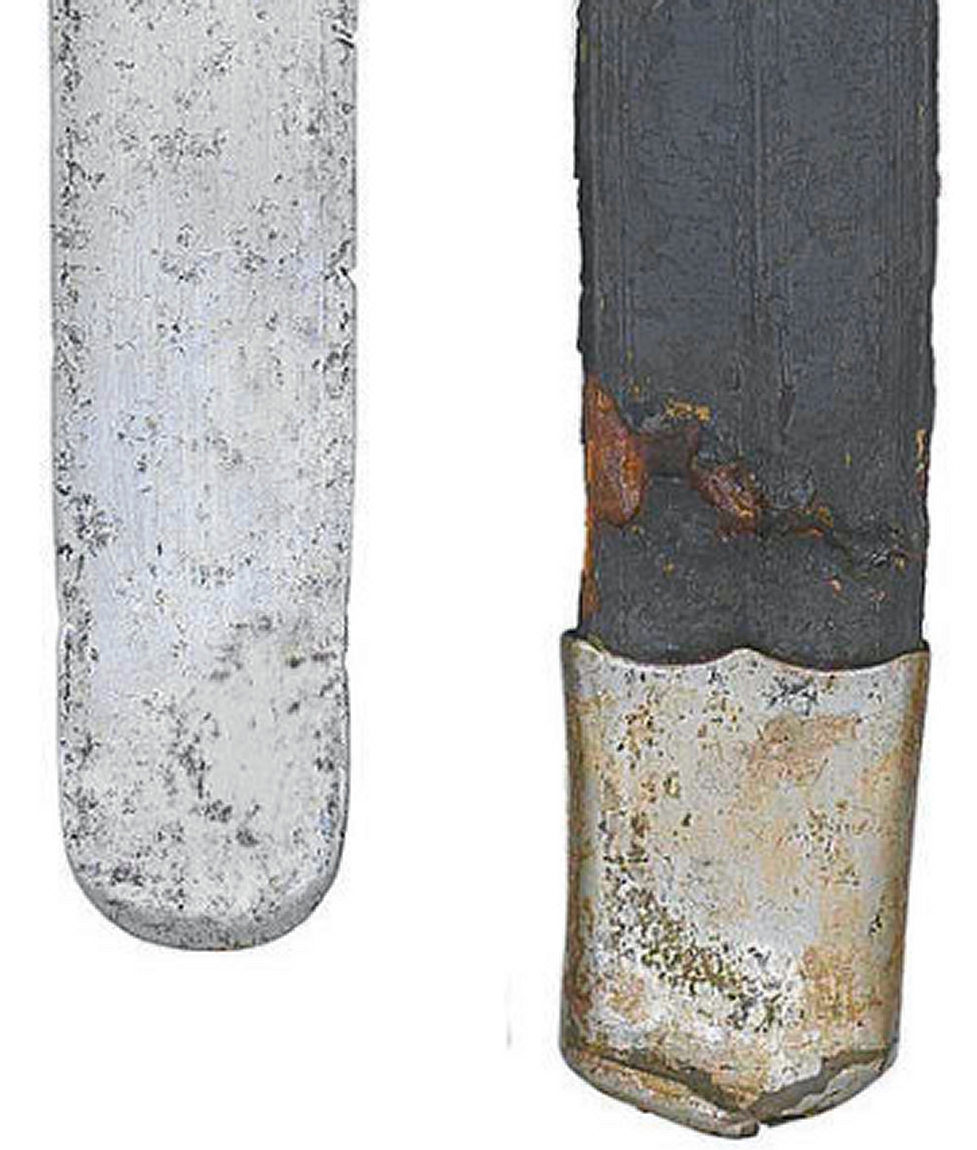

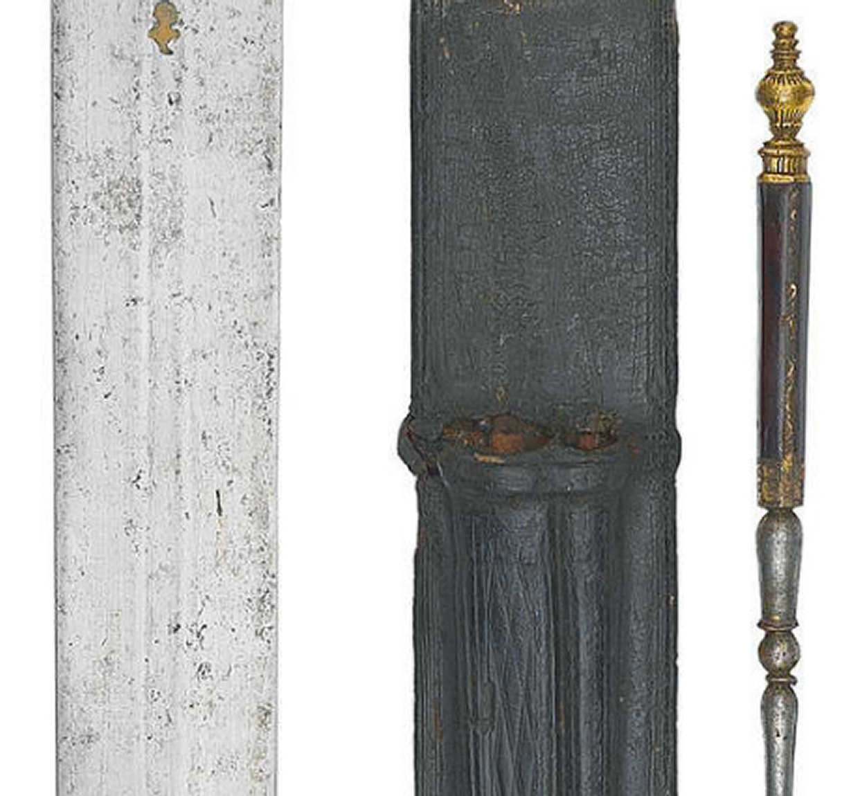

The latten-inlaid bladesmith's mark, the tooled sheath and the bodkin also serving as an awl.
Please note the leather tooling at the bottom finial of the compartment for the by-knife and bodkin, ending in a wavy decorative element wrought in high relief and merging into the stitches of the seam.
That characteristic serpent- or flame-like Early Renaissance ornament is found on various types of weapons and their accouterments:

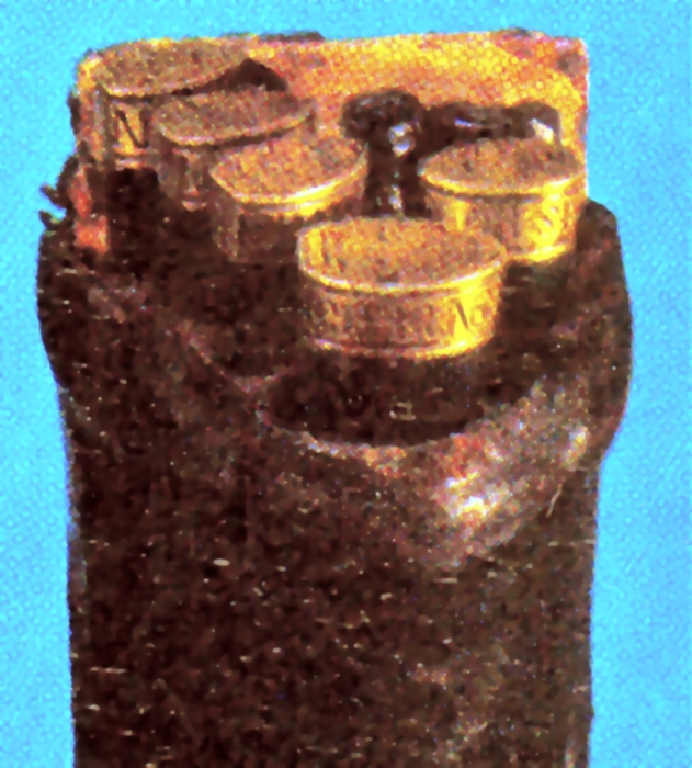

In the top attachment, the stitched seam is seen passing over into a trefoil ornament representing the utmost stytilzation of a bunch of grapes.
