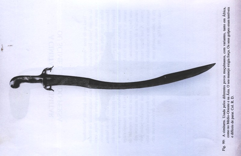

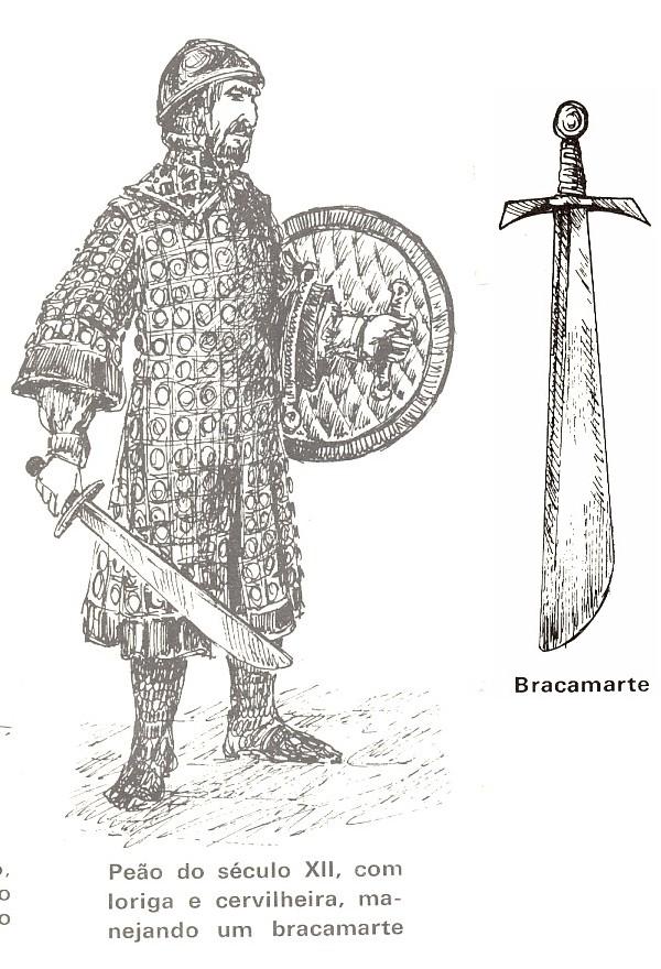

Hi Lorenz
These things of weapons typology and their semanthics are never elementary ... isn't that right?
I have one source saying that the term scimitar, cimitar or scimeter is a medieval europeanization of the Persian term shamsheer. It appears that the Arab term for this sword would be saif.
The so called scimitar is said to have being be used by Turcs, Persian and Arabs, specially by Muslims, hence used by the Moors that have been in Europe, when they invaded the Iberian Peninsula.
Some say that the European falchion is a copy of it, some others don't agree.
http://en.wikipedia.org/wiki/Falchion

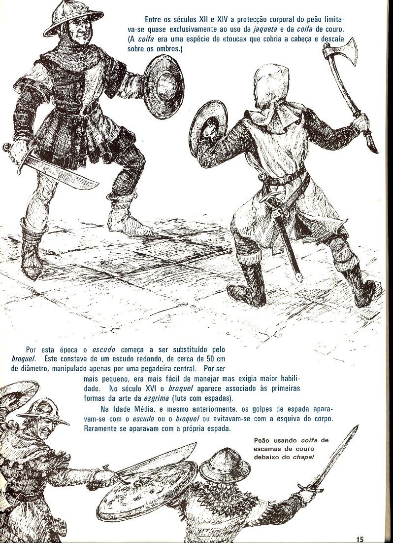

The picture attached depicts a scimitar of the type usually painted in our churchs, during the middle ages, when the Moor, the Jew and the three Magic Kings were represented with scimitars.
These swords demand for extraordinary strength; they were often used for executions and animal sacrifices. Their advantage over European swords was that they could break sword guards and left hand daggers with their circular strike.
Mind you Lorenz, this is only for entertaining you, till the experts come around and offer their skilled views.
Fernando

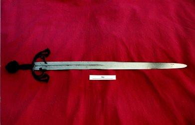

PS - From Wikipedia, on El Cid's swords:
A weapon traditionally identified as El Cid's sword, Tizona [pic attached], can still be seen in the Army Museum (Museo del Ejército) in Madrid. In 1999, a small sample of the blade underwent metallurgical analysis which confirmed that the blade was made in Moorish Córdoba in the eleventh century and contained amounts of Damascus steel [citation needed].
In 2007 the Autonomous Community of Castile and León bought the sword for 1.6 million Euros, and it is currently on display at the Museum of Burgos.
El Cid also had a sword called Colada.
Both swords have been misrepresented in popular culture. La Tizona was actually a one-handed sword, in the late roman style, whereas La Colada was a two-handed sword, greater in length.

Hi again, guys.
I completely agree with Jim's reminder that we must stick to the weapons business. Your knowledge in this subject is by far good enough to fulfill the plenitude of this space ... something that does not happen with me, as probably the least school educated character that posts in the Forum.
As i firstly introduced in my perspective, weapons typology is never easy to deal with; allways a struggle with translations, transliterations, ethimologic and semanthic paths ... not to speak of the greatest chalenge in tipyfying weapons, which is: does the discussed term refers to a specific model, or is it no more than a generic name, developed in a determined region to encompass a limited or wide variety of models and submodels coming from remote origins which, missing their name in the local 'catalogue', are baptized by the peoples with a name either alegoric to its shape or capabilities, or instead with a term close to that given if the original region or culture to one of its variations, preferably the most basic one ... such term being eventualy corrupted within time?
When i said that the scimitar could or could not have originated the falchion, i was only quoting sources; i am no scholar or any kind of specialist.
Assuming (then again) that the bracamarte is an equivalent to the falchion, i have just read in one of my humbliest books (Portuguese medieval war men), that such weapon is supposed to derive from the Vicking sax. How's that for an aproach?
I have also found a link, regretfully only usefull for those who can read castillian, where this problematic of the terminology
falchion/scimitar/bracamarte is discussed; complex stuff ... maybe too much sand for my truck.
http://images.google.pt/imgres?imgur...pt-PT%26sa%3DX
Without failling to see that some the aproaches from the various sides are convergent, i like the way Jim puts it, when he says that the term scimitar was used to 'illustrate the exotic sabres of the Moorish world'. Only i think that it was not only the way, but it still is, namely for the common person.
Fernando
Fer, that illustration from a portuguese book is just a falchion, so bracamarte and falchion are the same thing. I was reading the page from the AEEA, and I was wondering what is the word in english for "alfanje". Maybe your "unscholared" person can tell me, because I don´t know. The word "falx", from latin, designated a downcurved blade, something opposite of what we talk about. The scramasax was only a raw, usually straight long knife used by the german tribes. I cannot relate it to the alfanje.
Some authors indentify the scmitar with the alfanje, others deny this relation. In the article about the tipologic study of spanish weapons, German Dueñaz Beraiz denies that alfanje and scimitar are the same thing, but he does not explains what a scimitar is. Instead, he identifies the arab alfanje with the english falchion, the french badelaire, the italian cotellaccio or sttorta and the spanish terciado, and describes it as a "sword with a short, wide and curved blade, with a an austere hilt, normally with straight quillons". Also, he says that some of this swords were used exclusively for executions, in the decapitation of prisioners (German Dueñaz Beraiz, "Introducción al Estudio Tipológico de las Espadas Españolas: Siglos XVI-XVII", Gladius, Vol XXIV, 2004, p.219).
And, Miguel, history is not water under the bridge. History is condensed in our present, and it reveals the tendencies toward the future, the hidden currents which moves the actual world. And we have to take sides, or be dragged by the currents to an unknown destiny.
Gonzalo
According with Beraiz, the description of a scimitar in the way Covarrubias explains, corresponds with a shamshir, and this is the reason he does not accept Covarrubias description, because the scimitars were "more short" than a shamshir from his point of view. But this description also is valid for some kiliç, which in some cases, as in the type some persons call "pala", are short enough to fit in the description. Evidently, there are confussions and ambiguity on what those terms design, and there are not illustrations and secure references to have an unmistakedly ID. And other point: Dueñas Beraiz does not mentions the bracamarte in this article.
But I also think those terms were used in a more lax manner by the common folk, giving birth to this typologic problems. Even in this forum, I have read descriptions of a "dagger", which do not correspond to a double edged short weapon, but to a single edged weapon, and this is strange to me, as many dictionaries in english defines a dagger as a short pointed weapon with sharp edges used to stab or pierce, and in spanish it is of the outmost importance to precise that a dagger is a double edged weapon. Also, we differentiate the puñal and the dagger, being both of them weapons to stab (not excluding the cut), on the fact that the puñal has only one edge, and sometimes, also a short false edge. And if the blade is extremely narrow, we use another name. So, the problem is a little more complex, when entering to equivalences and traslations, as in the case of the question from Miguel.
Gonzalo

Outstanding information Gonzalo, and its good to have some sound perspective on these often confusing terms as applied to these weapons.
While we have some good momentum focused on the early Spanish weapons, and the comments on Tizona and Colada have really piqued my interest!!
Through most of the day I've tried to find more on the famed swords of El Cid, and have found mostly the confusion of legend and scandal prevailing.
It seems terrible that the fire at the Armeria in Madrid in 1839 led to the unfortunate 'dispersal' of so many of the treasured weapons to London's auction houses thereafter. The re-cataloging of the weaponry remaining was not completed as I understand until Calvert's work in 1898. The weapons shown in his published work "Spanish Arms and Armour" mostly seem to carry a degree of mystery and rather confused attribution. It seems normal that weapons were 'restored' or remounted in earlier times as they represent important heritage and history, and such cases are not at all unusual in many, if not most, museums.
What puzzles me is that some sources claim Tizona was captured by El Cid from a Moorish chief, some that he was was awarded it for his exploits. Some say it was buried with him (some say his horse Babieca was too). Colada is even more of a mystery, as it was said to be two handed, and as noted, these were hardly in use in the 11th century.
While Tizona is supposedly on display in Madrid, its authenticity as of 11th century was questioned, and certainly, the hilt style is of medieval form from the 14th-15th c. I understand that in 1999, a bit of the steel from the blade was metallurgically tested, and found to be of 11th c. type from Moorish Cordoba.
Is that correct? I can understand rehilting, but is this blade, said in some references to have been mounted originally in Late Roman style, the real thing?
I'd really like to hear the views on this.

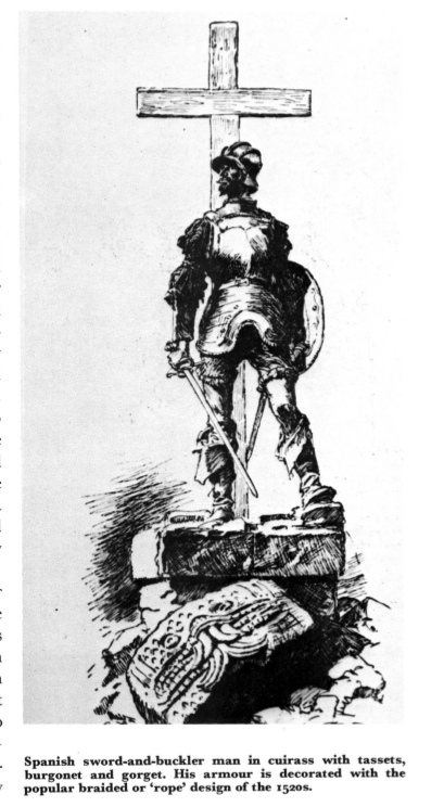

Posts: 1,042
Originally Posted by migueldiaz

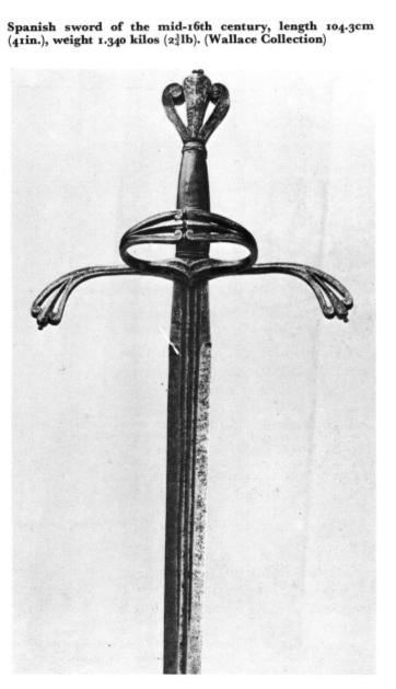

I wonder if anyone can point me to a photo or an illustration of the following: [1] a cutlass (Spanish preferably) used in the 16th century; and ...
Originally Posted by celtan
... The spanish didn't have a cutlass per se until the early 19th C., when the Brit M 1804-05 began being fabricated (briefly) at Toledo. The M1728 regulation sword, sometimes with a field cut-down blade, was regularly used by the Navy. Otherwise, used cutlasses were mostly of Dutch, German and British provenance.
Thanks Manuel for this clarification! Appreciate it.
Dear all,
It would appear then that my query as posed originally would be an anachronism. So I guess I'd have to rephrase the inquiry as, "Can anybody please post here any image or info of a 16th Century Spanish sword?"
Now precisely on that specific subject, I found these two [below] 16th Century Spanish swords, at Arma Española as cited earlier.
I've tried using Yahoo! Babelfish for the translation. But I'm getting a not-so-clear translation. Can I kindly request for a proper English translation of the texts?
Thanks in advance!

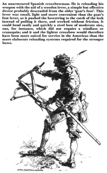

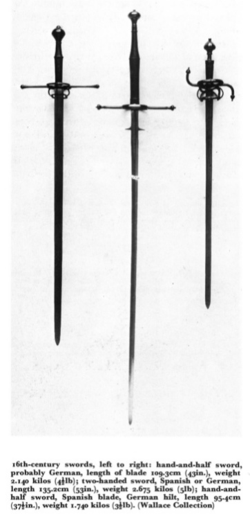

Since these previously posted images are just a few kilobytes each (and thus not burdensome on the server), and also for the convenience of all, please allow me to post here again some of the images lifted from Osprey's The Conquistadores.
migueldiaz is offline

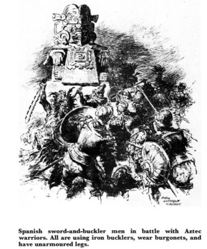

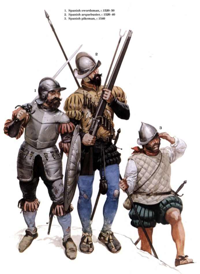

Some more ...
Old 9th February 2009, 12:00 AM   #23
migueldiaz
migueldiaz's Avatar
Join Date: Oct 2008
Location: Manila, Phils.
Posts: 1,042
Last set from Osprey's The Conquistadores ...

... I found these two [below] 16th Century Spanish swords, at Arma Española as cited earlier.
So here's the original Spanish text, and the corresponding Babelfish translation. The translation is imperfect, but one gets the general idea. It wouldn't hurt though if we non-Spanish speaking folks can get a more decent translation
SWORD NO. 1
Spanish description:
ESPADA DE LAZO
Ref. 1-1550-B
(IOHANNES DE LA HORTA)
mediados del siglo XVI
Long T: 1270
GUARNICIÓN: De lazo, italianizante y algo asimétrica en su desarrollo. Nótese la presencia de un solo gavilán curvado hacia el interior, un solo pitón o gancho frontal dirigido hacia arriba y un gran puente que, en sutil curvatura, une la base de la patilla del interior con el arriaz. En el reverso tres ramas parten de las citadas patillas para reunirse en la base del aro guardamano. Escusón en afilada punta. Pomo casi cilíndrico con leve perilla superior. Puño facetado completamente alambrado con torzal, entre dos virolas en cabeza de turco. Todos los elementos se hallan cincelados y damasquinados.
HOJA:Ancha, llana (sin mesas marcadas) con dos filos y breve talón. Canal en su tercio fuerte.
INSCRIPCIÓN: IOHANES DE LA HORTA. Punzón A (en un cuadrado del recazo)
OBSERVACIONES: Según Palomares Iohanesde la Horta forjaba en Toledo en 1545.
English translation c/o Babelfish:
BOW SWORD
Ref 1-1550-B
(IOHANNES OF THE HORTA)
half-full of century XVI
Long T: 1270
TRIMMING: Of bow, italianizante and something asymmetric in its development. Nótese the presence of a single sparrowhawk curved towards the interior, a single pitón or frontal hook upwards directed and a great bridge that, in subtle curvature, unites the base of the sideburn of the interior with arriaz. In reverse the three branches they leave from the mentioned sideburns to meet in the base of the hoop hand guard. Escusón in sharpened end. Almost cylindrical Pomo with slight knob superior. Facetado fist completely fencing with torzal, between two ferrules in Turk head. All the elements are chiselled and damascene works.
LEAF: It widens, trowel (without noticeable tables) with two edges and brief heel. Channel in its strong third.
INSCRIPTION: IOHANES OF THE HORTA. Striker pin A (in squaring of the back)
OBSERVATIONS: According to Iohanesde Pigeon houses the Horta forged in Toledo in 1545.
Would anyone care to comment on the awkward translation?
Thanks!
Old 9th February 2009, 04:46 AM   #28
migueldiaz
migueldiaz's Avatar
Join Date: Oct 2008
Posts: 1,042
And the other one:
SWORD NO. 2
ESPADA DE LAZO (TOLEDO)
finales siglo XVI
Ref. 1-1590-B
Long T: 1.290
GUARNICIÓN: De lazo, cincelada con maestría, con pomo troncocónico descansando sobre peana y ésa, a su vez, sobre virola. Puño cilíndrico con marcados surcos en espiral, arriazen cruz de rectos gavilanes y escusón central poligonal. El lazo propiamente dicho lo forman tres puentes frontales, de cuyo superior arranca un brazo hasta la mitad del aro, las ramas posteriores en número de tres y las patillas que surgen del arriazy, en arco de circunferencia, van a la base del recazo. Conjunto armónico y muy bien logrado.
HOJA: Ancha, con dos mesas por cara y canal central en su primer tercio. Filos a ambos lados.
INSCRIPCIÓN: TOLEDO
OBSERVACIONES: Situamos el arma a finales del s. XVI y comienzos del XVII época de oro de las espadas de lazo.
BOW SWORD (TOLEDO)
end century XVI
Ref 1-1590-B
Long T: 1.290
TRIMMING: Of bow, chiselled with trunkated cone masters, pomo resting on pedestal and that one, as well, on ferrule. Cylindrical fist with noticeable furrows in spiral, arriazen cross of straight sparrowhawks and escusón central polygonal. Bow proper bridges form it three frontal, of whose superior it takes an arm until the later half of the hoop, branches in number of the three and sideburns that arise from arriazy, in circumference arc, go to the base of the back. Very well obtained harmonic set and.
LEAF: It widens, with two tables by face and central channel in his first third. Edges to both sides.
INSCRIPTION: TOLEDO
OBSERVATIONS: We locate the weapon at the end of the s. XVI and beginnings of XVII the time of gold of the bow swords.
The machine translation is for better translation, please?
