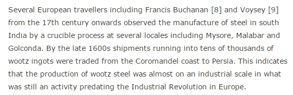

But let's look at the facts. And the facts are that even now in the 21st century, we see a large number of wootz items (swords, swords, daggers, knives and spears). If you count all wootz items in our collections,how many items we get? A few thousand? In addition, several thousand in private collections in Russia. More thousands wootz items in museums in the world. Do not you think that is too many items to talk about some secrets?
Steel from Ancient India (Wootz Steel)
WOOTZ STEEL: AN ADVANCED MATERIAL OF THE ANCIENT WORLD
S. Srinivasan and S. Ranganathan
Department of Metallurgy
Indian Institute of Science
Bangalore
estcrh is offline
Old 5th February 2016, 07:31 AM   #26
mahratt
mahratt's Avatar
Join Date: Nov 2009
Location: Russia
Posts: 1,042
Bangalore
Thank you, estcrh. This only confirms my words that wootz steel production was not such a great secret.
It is interesting, how could you have so many steel manufacturers making a product for so long and yet people were said to be scurrying everywere to find out how exactly it was made.....and then the method was seemingly lost?????
estcrh is offline

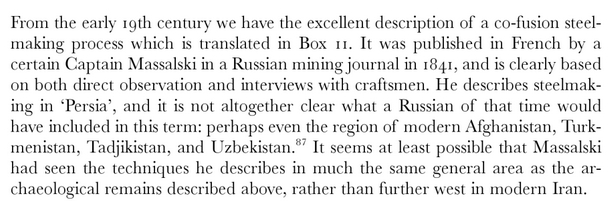

My friend, this is an error - assume that Anosov sought "secret of wootz", traveling to India or Persia. Anosov was - researcher. Anosov studied samples of wootz steel samples which were brought from India, Persia and Central Asia for him. And on the basis of the studied samples of wootz, he developed his own method of smelting wootz steel.
Moreover, note that Ariel wrote:
Originally Posted by ariel
... in 1841 captain Massalski published full description of the process he observed in "Persia" ...
It says that in 1841 continued to produce wootz and it was not kept secret.
There are records of many people besides Anosov that were seeking methods of steel manufacture in Indian and elsewere, as for captain Massalski, what exactly did he see/report and were did he see it, was he talking about wootz steel or another type of steel.
Science and Civilisation in China: Vol. 5, Chemistry and chemical technology ; Pt. 11, Ferrous metallurgy, Volume 5; Volume 11, by Joseph Needham, 2008.

The captain Masalsky writes about of Bulat (wootz) steel smelting. And the smelting of wootz steel exactly the Persians.
I do not know that someone wrote in 2008 Article Masalsky published in 1841:
