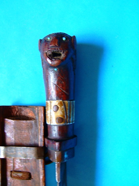

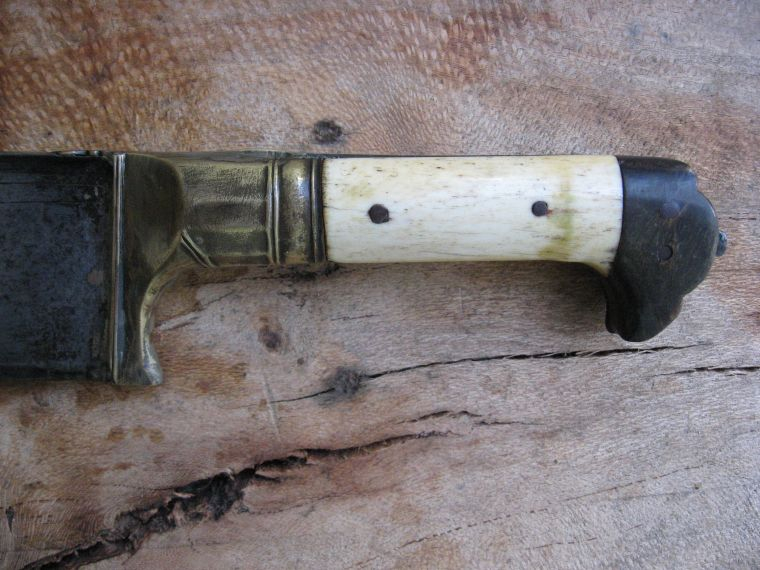

Dear friends, I recently had the pleasure of purchasing this on eBay from Major Tomm.
Fascinating item. Handle is shorter than is customary for a salawar yataghan, aka khyber sword, yet the blade is 3 to 4 inches longer than is usual for such blades.
The blade has a series of interesting marks, am not sure if they are an attempt to replicate old European hall markings or not.
Animal head on pommel is another unusual feature.
Blade has the T spine, but the T structure is less pronounced, and a bit shallower than the other, more typical khyber sword I own.
Even arrived with a quite good scabbard that is probably not original but still very well made. Scabbards suffer a lot of wear and tear and sword scabbards, being much longer than knife scabbards would likely incur very much harder use as tips project out and likely to hit hard on rocks as wearer walks by. A wood core scabbard would probably have more and eventualy splitstress from the greater weight of a sword blade, making original scabbards very difficult to come by.
A most interesting beast.

Hi John
a very nice Kyber sword, surely has been a faithful comrade,
for an old proud Afghan warrior
could be nice from you, to display here, your own pictures,
included the scabbard
nice caught

My apologies but I have my serious doubts as to the authenticity of your Khyber knife with regard to its age. Some time ago another Forum member purchased an item from the same source which turned out to be 'less than he had hoped' although, apart from that particular one, I could/will not comment on any other items this dealer/collector has sold or has for sale. It probably does come from India but not I think from the first half of the 19thC. I sincerely hope I am wrong and I await further comments from other members with interest. If I am correct you will not be alone just joining a long list of collectors who have 'misconstrued' an item advertised by a supposed authority on the Net.

I would simply observe that the pommel of this sword is in violation of the tenets of Islam; is it not ?

Salaams all~ It looks like a real one to me ~ The wear looks uniform and the hilt seems right... I saw a load of these in Kabul (Chicken Street) Ibrahiim al Balooshi.

The hilt is all wrong never saw one like it. The sword itself lacks the quality often found in 19th century pieces. The hilt if was done in Afghanistan is not original and may have been added later in its life as a repair I think this would have been rehilted or came from Southern India due the monster head on the end of the hilt? Here are some examples of hilts for you to compare.

Not my main speciality area - but I would certainly say the brass animal head hilt part did not originally belong to the knife, and has been added at some stage, as others have pointed out.
Where and when it was added is open to question...

Hi John,
Sorry to also be a little negative about this piece.
I had a good look at that piece in person when it was sold back in February at auction.
I remember that there was some movement on the hilt and the general construction with the single copper rivet appearing to hold it all together seemed inadequate for the task.
Not to mention the atypical to say the least design of the hilt and general 'feel' made me wonder if it wasn't either a marriage, 'put together' or a late piece made to impress those who travel.
The blade looked to me to be possibly older than the hilt. The stamped 'decoration' looks to have been rubbed/worn/cleaned etc, suggesting age, while the crude bronze hilt seems to have remained relatively 'as cast'.
That said, in it's defence it certainly does have a 'look' to it, and it also has size on it's side!

Ahh this piece again! I too have seen & handled it a few months ago... It is certanly interesting!
My perception in hand was a recently buffed mono steel blade from earlyish 20th century combined with an interesting cast head of some form, also combined with a badly cut & decorated piece of sheet brass pinned through with a single copper boat building nail or similar. It seemed to wrap over the bolster rather than fit to it. I presumed the cast head came from some other non Khyber sword item, added to the blade & with the sheet added to pull the design together..
I guess your at least the 4th owner in 4 months which isnt so bad as at least two of the others were proffesional dealers who etched it with ferric chrloride hoping to find wootz... {I am sure incidently there both members of this forum to. } Then the acid wasnt neutralised to allow it to badley re patina { or rust.} slighty before resale to the next hopefull dealer or collector. , till finaly it reached ebay & your good self.
The handle is loose & rateley on the single nail pivot. I assumed the marrige of 3 parts was probably western due to the lack of traditional feeling. But certanly still dramatic! But I could be wrong & indeed perhaps thats the current level of some "chicken street" work, I dont know Ive never been there.
I thought it was an interesting piece , very unique head on it & certanly a "massive" piece, its value? Thats up to the person who pays for it I guess?

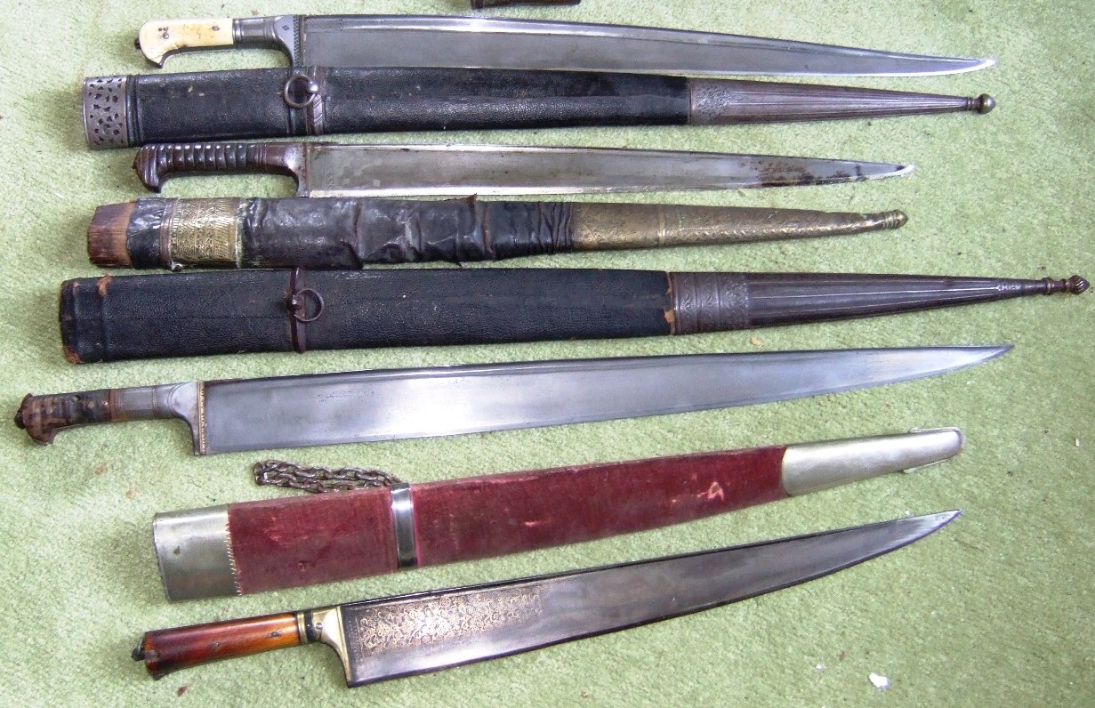

I cannot recall another example of such a uniformly-negative opinion on this rather polite and placid Forum!

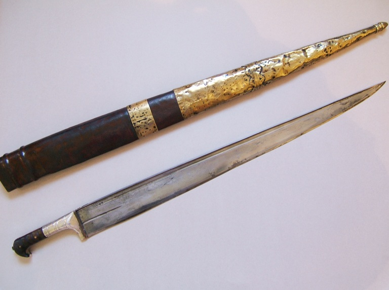

BTW, Lew, on the 3 from above pic you posted, the lowest khyber ( the one with virtually no pommel, - do you have any idea how old it was? I have a suspicion that such pommel-less handles are seen on really old ones. Here is the opportunity to verify my hypothesis:-)

That one is probably Indian and not Afghan. Artzi had one on his table a few year back and that was the consensus. 1825-1850 I would think? Probably belonged to someone of high status. Let me clearify Northern India AKA Pakistan

I must agree on the negativity point as well as disparaging notes. It seems clear that John was quite pleased with this Khyber and was kind enough to share it here, then the barrage of discrediting comments certainly must have quickly taken the wind out of his sails.
In my opinion this piece regardless if relatively modernly refurbished (and John made well placed points on these common cases) remains a representative example of these weapons which of course have been used even into more current times.The blade does seem of age, and as has been noted the grip material and the cast pommel are of course replacements.
The simple motif of dots in circle are well known in Afghan items as are other features in context, and to me I see nothing suggesting this might be from Indian regions to the south.
In remote tribal regions weapons are constantly refurbished and especially during times of war or unrest, situations that have remained in flux in tribal regions of Afghanistan throughout recent history. I would consider this an interesting example of these distinct tribal weapons of Afghanistan and as been well pointed out, its rough demeanor suggests it was for use rather than tourist consumption.
Throughout the years that I collected I acquired many weapons that others scoffed at, mostly because I saw them for what they were, and even though not necessarily at the standards of others, I truly enjoyed them for what I learned from them. I also learned about certain protocols toward the weapons of others, and perhaps I am a bit too 'old school'.

in my opinion the handle is not original; and was cut...and modified
What is on is that the person who sold you the sword, sells of the nine of the old ! one must be very careful...

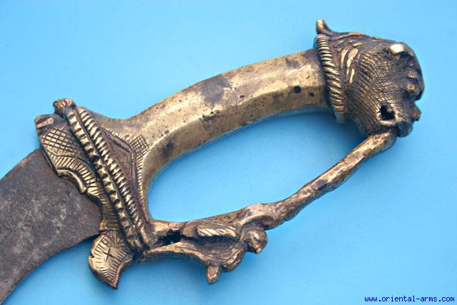

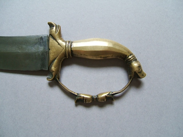

[QUOTE=Jim McDougall]I and to me I see nothing suggesting this might be from Indian regions to the south.
The monster motif can be seen on many examples from Southern India but they tend to be in a serpent form except for the bottom one which looks like a cross between some type of tiger or lion? The only thing that I could come up with that resembles the hilt is the demon head hilt on a Bhutan sword. Patas also have similar designs on the hilt.
Well observed Lew. While it is true that most grotesque zoomorphics are generally held to be used in 'southern' Indian motifs, it is also known that stylized versions were quite present in northern regions. The yali and makara are of course deeply represented in Hindu theology, but the applications seem adopted in other contexts as well. The diversity of influences affecting weapon and component industry in many areas in Rajasthan certainly reflected many of these kinds of representations.
The bottom sword is I believe from the western Malabar regions and perhaps into regions of the Deccan, and the zoomorphic head is most interesting as it strongly resembles 'doghead' or 'lionhead' pommels on 18th century British military swords (c. 1770s-90s).
