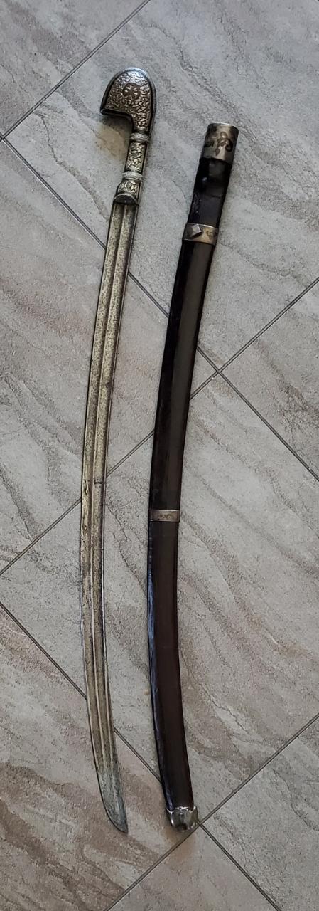

It is not often one has a chance to discuss Tatar wepons. Here is an example of a 17th c. Tatar (or Polish-Tatar as some texts would call it) saber I was recently fortunate to find.
Perhaps Wolviex will be so kind and help to narrow the age range.

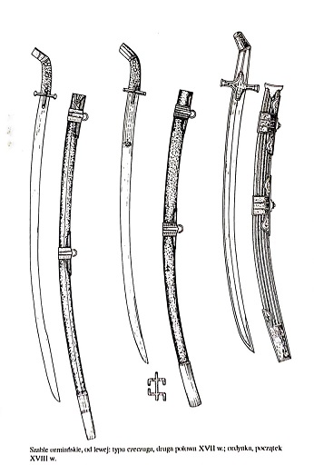

This does appear to be an example of a Tatar type sabre of the latter 17th century. While this form originated with the Tatars, it was commonly duplicated in examples made in Lvov by Armenian craftsmen, thus the term commonly misapplied 'ormianka' or the Armenian sabre. King John III Sobieski of Poland favored Eastern fashion thus he is portraited wearing one and a number of them were likely worn by others in his favor, during latter 17th century. In Poland these sabres were termed 'ordynka' (=horde) for thier likely steppes origins, or often 'czeczuga' (=small sturgeon) for the distinctive ray or fishskin grips.
These sabres are beyond incredibly rare! and very little is published on them aside from the data above which is from "Polish Sabres: Their Origins and Evolution" by Jan Ostrowski & Wojciech Bochnak, in Art, Arms & Armour, Vol. I, 1979-80, pp.232-33. Examples are also illustrated in Zygulski (p.242-43) and in "Iranian Swords of 17th c. with Russian Inscriptions in the Collection of State Hermitage Museum" by Yuri Miller (p.138, #150). In the Miller illustrations the hilt form is of this type but mounted with shamshir blade dated 1698. The mounts and hilt on yours seem consistant with the example illustrated in the Ostroski article, and it appears by the photos yours has held up quite well. Is there anything you can divulge on the provenance of this fascinating piece?

Ham,
There are some markings on the spine of the blade (in gold, visible although not well on one of the attached photos). I have not yet examined the saber in person so I don't know if they are owner's Tatar tamgas or maker's marks.
