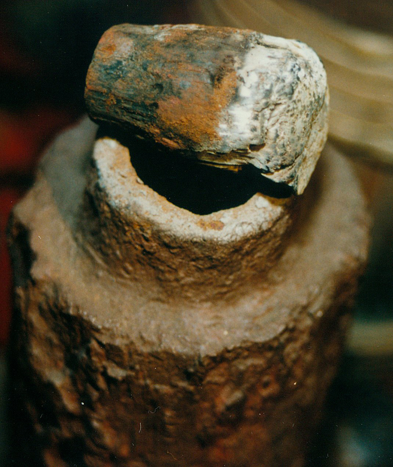

Default Touchhole and Shutting Lug on the 'Cartridge' of a Breech-Loading Pistol of ca. 1540
Author's photos taken in the Hofrüstkammer Vienna.

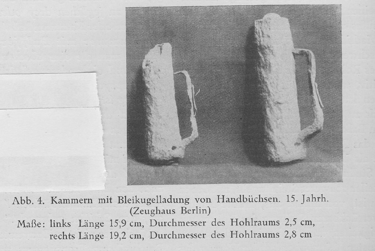

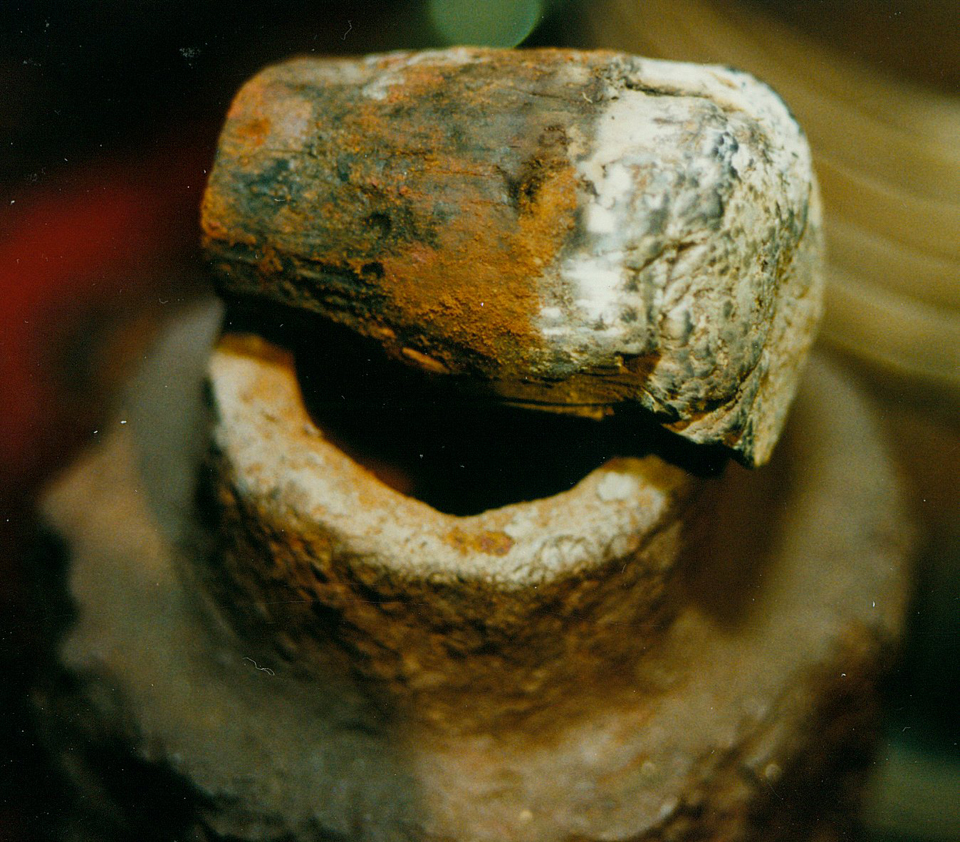

Hallo,
The chambers or cartidges of breech loading handguns were not loded with powder and plug. The attached photo is taken from an article of Zeitschrift für Historische Waffen und Kostümkunde (Volume 9 of 1922, No.4), a standard work on arms and armour, which should be familiar to any who can read German. The photo shows two chambers of breech loading handguns of the 15th Century in the collection of the Berlin armoury. Both chambers contain the original charge of powder and lead bullet. This is a clear indication that at least chambers of small bore were loaded with a lead bullet, and the bullet was not pushed awkward in the rear of the barrel before inserting the chamber.
Best wishes
Susi

Hi Susi and welcome here,
Thank you for your interesting input from the Zeitschrift für historische Waffen- und Kostümkunde. I have been a member of their society for 30 years and own all their volumes from 1897 thru 2010.
First, these are by no means exchangebale breeches for 'handguns' but for cannon! Portable handguns of the 15th century had small bores of ca. 12-16 mm and their breech chamber never had handles; they had no grips at all and and an overall length of only ca. 6-8 cm. Please cf. the measurements of the 1540 Passau arquebus breech chamber you cited!
Second, these seem to be exceptions to the rule. For these unregulated ages, almost anything was possible in general. As I noted though earlier in this thread, we know of other loaded breech loading cannon chambers only containing powder and wooden plug, and attached I repost my own photos of one of them. The rest of the original handle can bee seen.
Similar ones were found on the wreck of the Mary Rose, sunken in 1545, also just loaded with powder and plug.

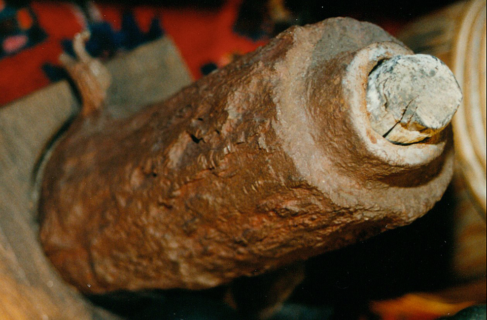

'Nando, my dear friend, would you mind posting good images and measurements of your ca. 1440 fine cannon chamber as this is almost identical to the ones preserved in Berlin?
Old 1st November 2010, 06:16 PM   #66

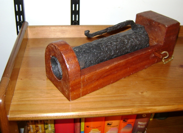

There you are
Bore about 30 mm.
Length 230 mm.
Width at base: 65 mm.
Weight: 3,135 Kg.
.. The wooden set up picture is a bonus

Another argument for my theory that breechloading cannon chambers did not normally contain the ball:
As we can see, most of them taper and narrow towards the fore end, in order to be shoved into the barrel and tightly fit. So I think that, had they contained to ball, the latter would have been of too small caliber to match the barrel.
Any comments much welcome!

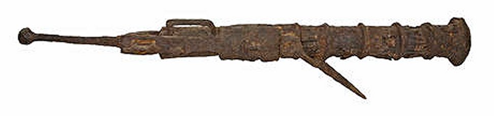

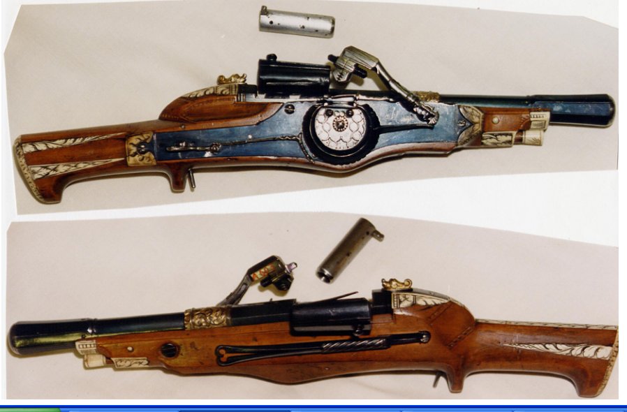

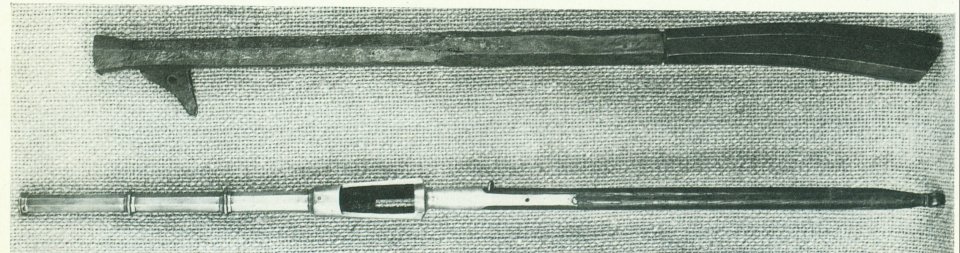

Does anybody have photos of these breech-loading handgonne?
"breech loading handgonne, chamber missing, late 1400's. length 1,460 mm, cal 18 mm "
from
http://homepages.tig.com.au/~dispater/handgonnes.htm
Spiridonov is offline   Reply With Quote

Hi Alexander.
Is this the same thing?
This is included in a PDF document with 186 pages, that i can send you by e-mail, if you are interested.
No, 'Nando,
It's another but very similiar item, and your scans are great, thank you so much!
I attach a better image of the gun Alexender meant.
Michl

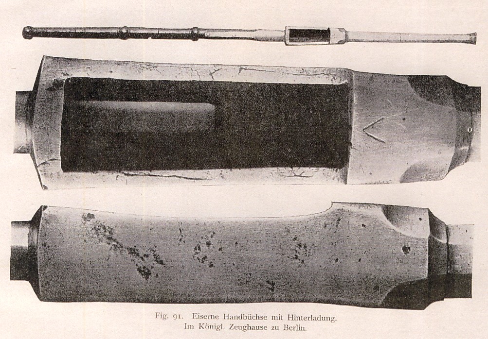

Old 1st December 2010, 04:38 PM   #86
Spiridonov
Spiridonov's Avatar
Join Date: Nov 2008
Location: Russia, Leningrad
Posts: 355

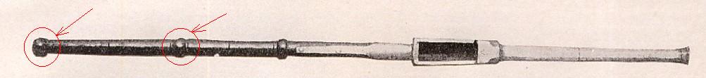

else

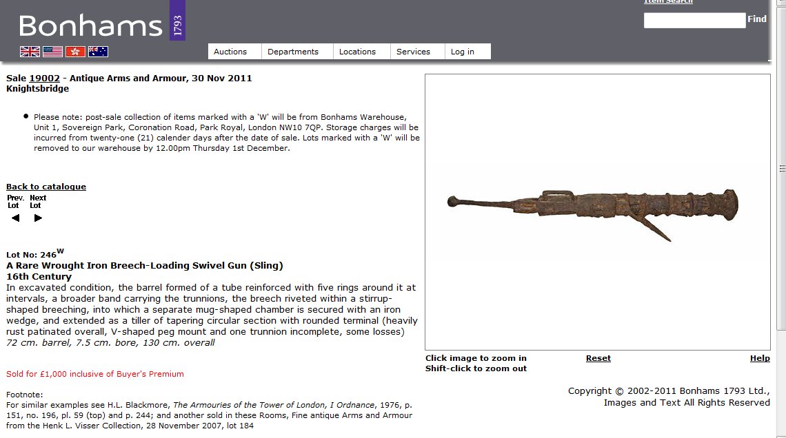

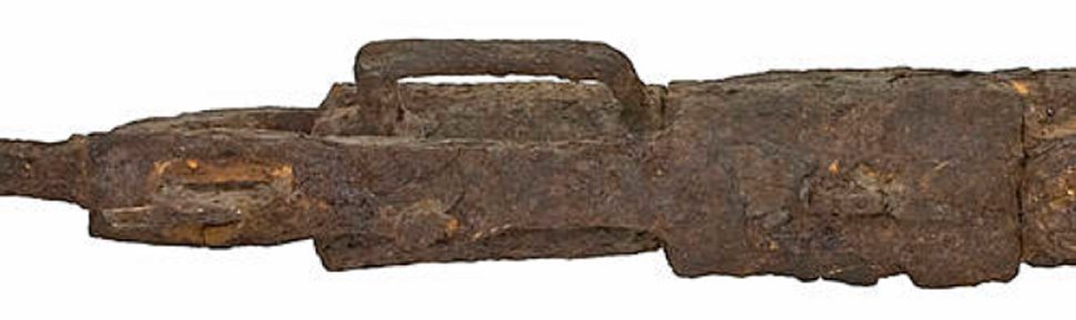

A wrought-iron breech-loading ship cannon, ca. 1480-1500.
m

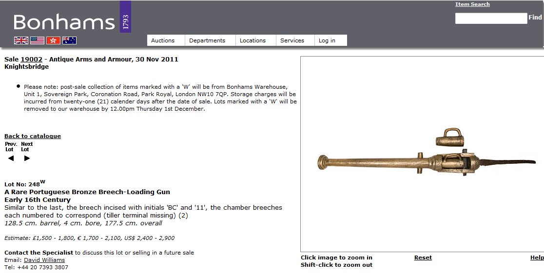

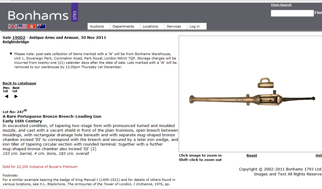

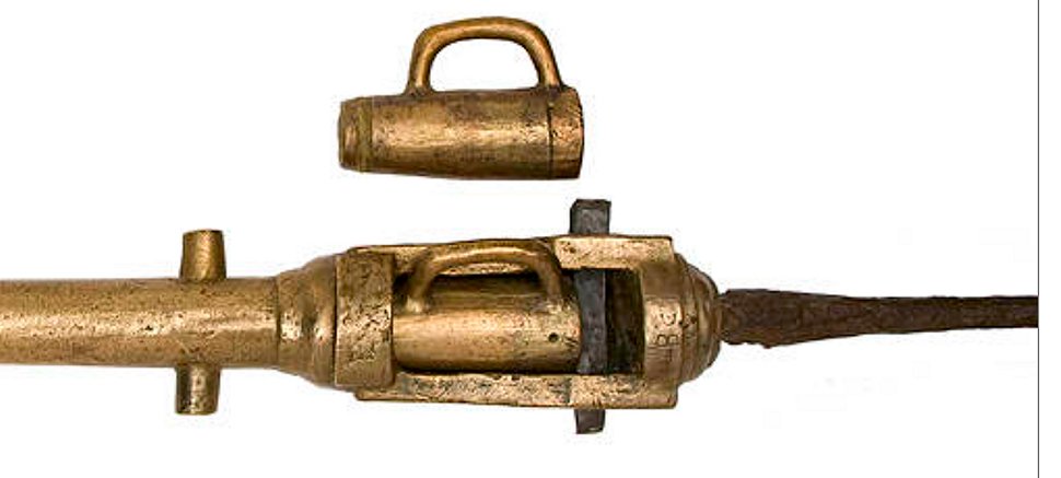

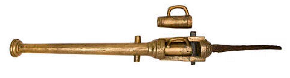

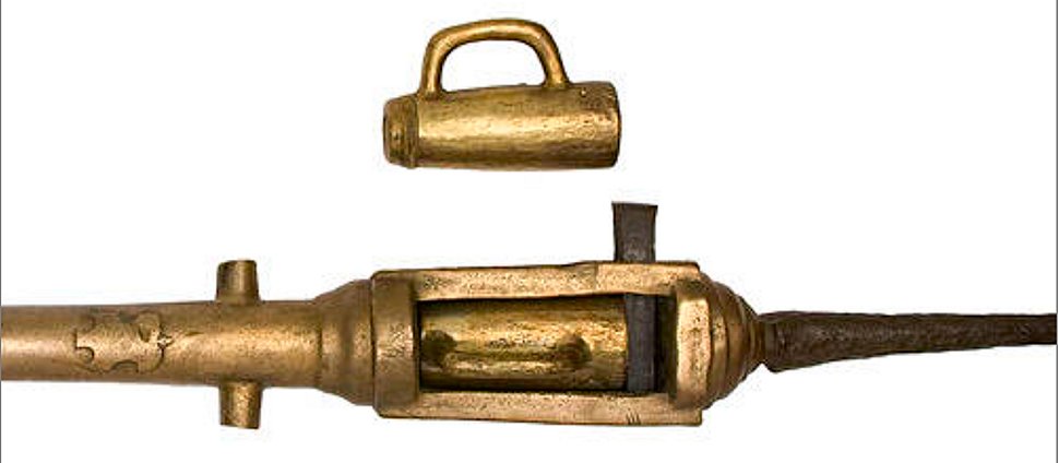

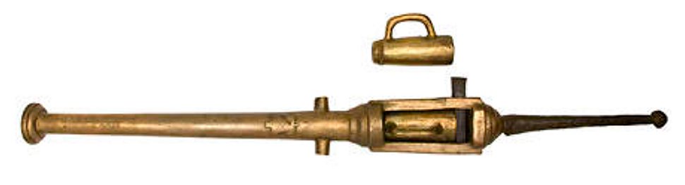

Posts: 4,310
Two Portuguese bronze breech-loading cannon pieces, early 16th c. each, and obviously two from a series.
m

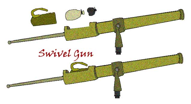

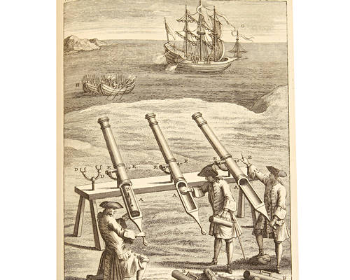

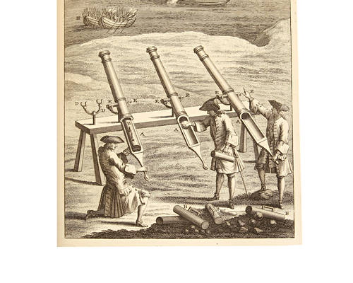

HERE ARE A FEW MORE PICTURES, HOPEFULLY NOT POSTED ALREADY., TWO PICTURES OF A OLD PRINT. AND DRAWING SHOWING LOAD FOR GUN.
