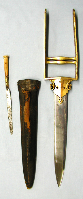

In the book ‘The Mansabdari System and the Mughul Army’ the author, Abdul Aziz place the lodestone/Magnetite amongst the semi precious stones. What does it look like?
The sound is interesting. When you can make a katars side guards sound like a tuning fork for a looong time, it is fantastic, but when you try with a katar where the hilt has been cast, the sound is very short.

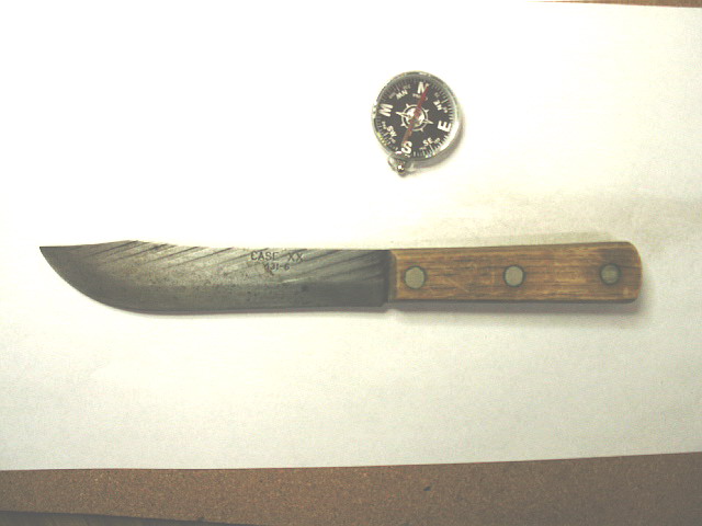

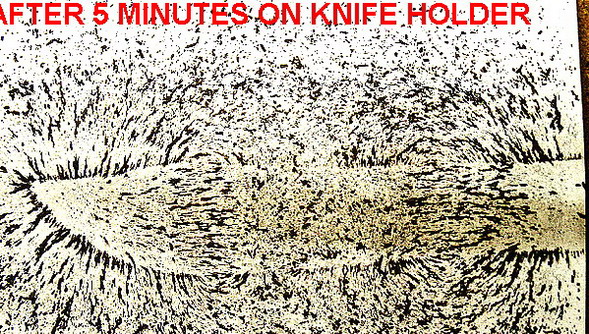

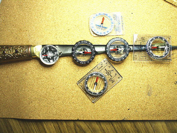

Smile Magnetic effects on a Case knife
OK ALL
I said I was winding down on my part of this thread started by JENS, and after reading
Ann and RIVKIN input on this magnetic stuff I should have stopped last week! Do all you follow their exchange? Man that is some heavy stuff. Anyway I said I would do as FEARN suggested and acquire a magnetic knife holder and zap a carbon blade.

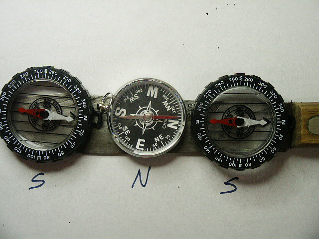

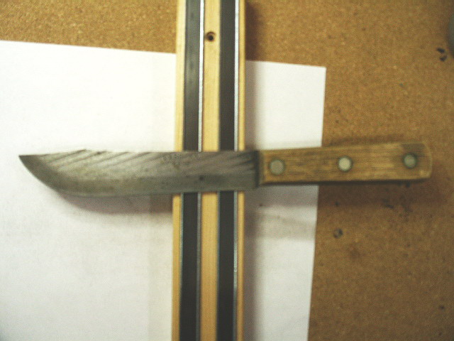

I used a Case butcher knife, as was in contact with the magnetic holder for approximately five minutes, the pictures show that the blade did take magnetic profile with three pols.
I also took a picture of the Mysore dagger with four compasses on the blade to show you that it has the four changes all at the same time.
Gene

Gene, you are doing excellent with the compasses – tell me did you empty the shop ?
Allow me just one question, when you show the blade with the compasses, it seems as if the magnetism north-south is farther away from each other than the magnets on the knife holder – is that so?
Jens

Thumbs up Knife holder test
JENS
You are very astute MR. JENS
I failed to take a picture of the knife on the magnetic holder at the tip end.
I placed the knife on the holder in two different places that is why you see two areas of magnetic fields and not just the one, both times were approximately five minutes each time with the tip end placement being the last one.
I thing the Case knife picture was different in that the knife profile came out very well while on the Mysore dagger just the magnetic fields are shown.
You ask about the compasses, yes I had to go to two different stores to get them, I tried to get all of them to be the same but could not find four just alike.
One other thing JENS, is that if you look closely at the Mysore dagger with the four compasses on the blade you will see that the tip end compasses is pointing North not South. I do not know why that happened as I did not notice it myself until I posted the pictures, another mystery on the never ending quest for information on Magnetic Weapons!

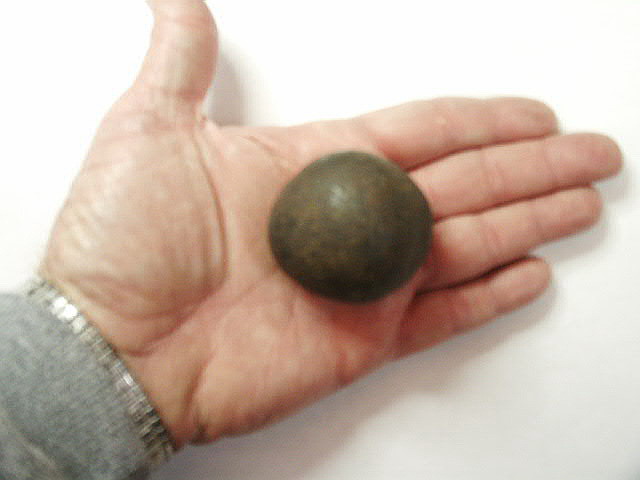

Ann, would it be possible for you to show a picture of one of the ingots?
If it looks like I think, it is like round bread, being thinker in the middle. Would that not make a difference when trying to make them magnetic? Also, if the ingot is round, how would the magnetism be at the ‘sides’? Would it not be different if it is longish ?
Jens

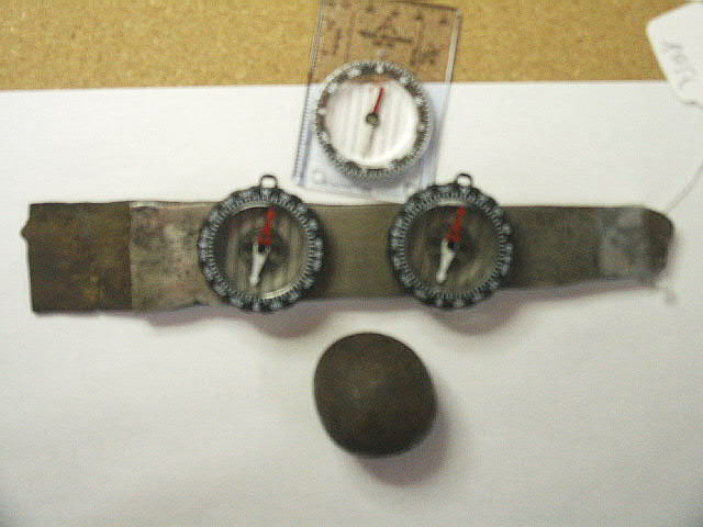

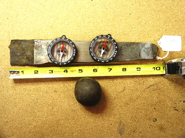

Thumbs up Wootz ingots
JENS
I have an wootz ingot and it is round/dome shaped, and I will take a picture of it and I also have a broken flat wootz bar/ingot all gotten from Artzi and I take a picture of that one also.
ANN
let me know what you want me to do as for as applying a compass on them,( I do have a supply of them! )
The bars/ingots have not be subjected to any magnetic fields by me.

Thumbs up Wootz ingots magnetic properties
JENS
Is this the type of wootz ingot you were referring to, the round one?
Ann
you can have both wootz ingots for your testing if you want them, no string attached. and they are here in the USA ( some think Georgia is not however in the USA. but it is ) As you can tell from the pictures that the wootz ingots are neutral with no magnetic fields as all the compasses are pointing North.

2. To Mare Rosu:
Thanx for the pictures,
The thing I would consider to be interesting is a conductance test. I don't think it can fire up with a simple resistometer, but it can be that if you place probes at about 5mm from each other on the dagger and move them alongside the dagger's surface that you will be able to see a significant change in the resistance along some set of points, which is possibly can be connected to the changes in the metall itself.
The problem is that not all steels are ferromagnetic, but they are all conductors, so unlike magnetism, you should not see a lot of difference.

I always thought ingots were like the round one you show Gene, but after having read Ann’s article in Minerva Magazine No. 13, issue 4, 2002, I was wiser, ingots can be found in many shapes and sizes, the ones made in Merv weighted according to Ann’s article about 2 kg.
Gene how many different ingots do you have, and do they have the same weight?
Is there any writing or marking on them? I remember to have seen a picture of a round ingot with some writing on it.
Ann, do you know if the shape of the ingots was a kind of ‘trademark’ for a region?

JENS
This is the link to the wootz bar I had and made it into a Bowie by Al Pendray and also tested by Verhoeven. The end with the inscription is still with Pendray, at least it was the last time I saw him.
http://www.vikingsword.com/ubb/Forum1/HTML/002326.html

Gene, the ingot you show on the link seems to be round and flat. The one I saw a picture of was shaped like the round one you show on a picture on this topic, but larger - I think. The writing was on top of it, and looked, as I recall it, like the writing on the one you show on the link.
Jens

A small knife I have, in a scabbard together with a katar, is very magnetic, but the katar is not.
The picture to the left shows the tip of the blade, and the one to the right the compass at the base of the blade. The small knife is made in the first quarter of 1600, the katar is newer.

When magnetic moments are positioned alongside a line (good approximation for thin swords), there are basically two stable configurations - all magnetic moments are oriented along the line, parallel to each other, or they are all perpendicular to the line, and anti-parallel to each other, i.e. +-+-.
What you have most likely shows that you physically have different steels (most likely phases or chemistry) at the tip and for the rest of the blade, so you've these two macrodomains anti-parallel to each other.

Rivkin, thank you for your answer. I understand what the words, but I have a feeling, that I don't understand the whole meaning. I understand, that when we have come as far as we have, and want to go further, the language is likely to get more complicated. Is it possible for you to explain it in another way?
Here is a picture of the katar and the little knife.

In a very approximate manner:
When magnets are dropped into a narrow, long box, they naturally prefer either to align all parallel to each other parallel to the long side of the box, or anti-parallel to each other (with anti-parallel polarities) and perpendicular to the long side of the box. In both cases the magnets will lie parallel to the magnetic field created by other magnets.
So your configuration is most likely due to the case that at the tip you have some anisotropy , most likely due to changes in steel's chemistry or physics (phases).
