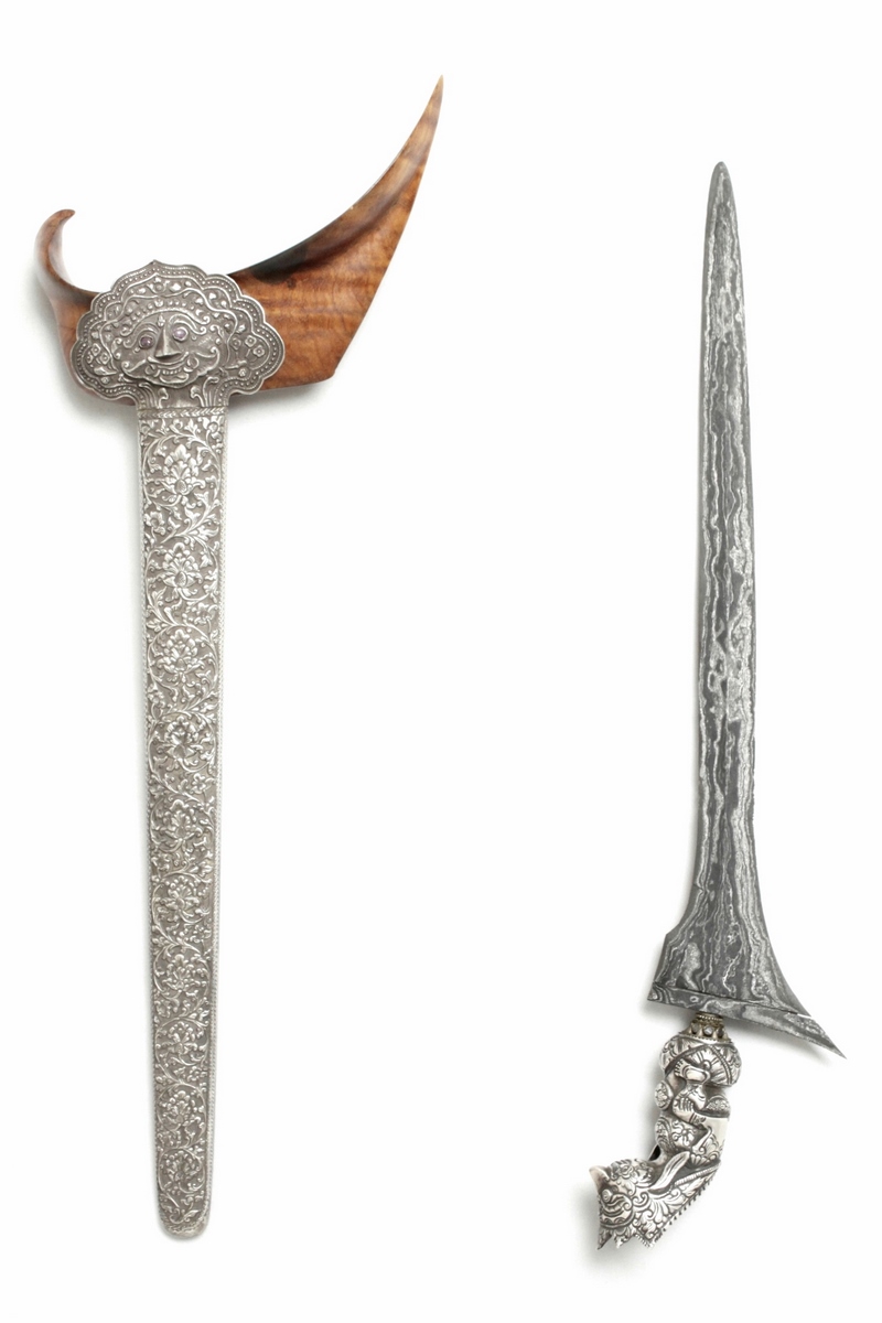

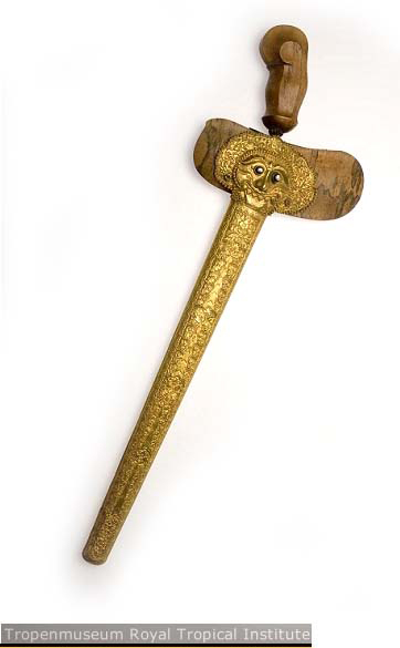

Hi Wolviex,
Reading your initiated topic about these highly desirable krisses I came across a pic in the collection of the Tropen Museum in Amsterdam. Seems like a twin to me! The pic is rather of poor quality.
Paul B. is offline   Reply With Quote

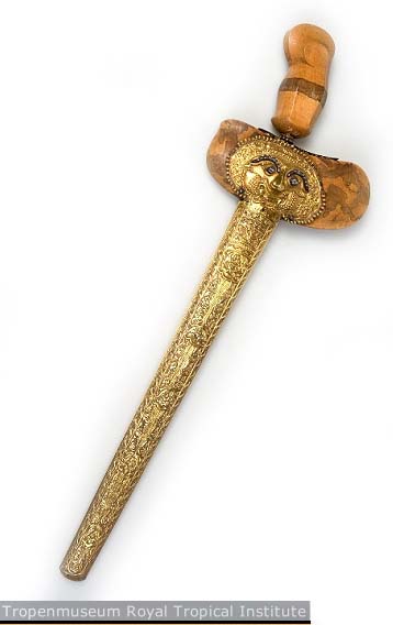

Old 18th December 2017, 02:43 PM   #71
Paul B.
Paul B.'s Avatar
Join Date: Nov 2017
Posts: 205
Another look-a-like from the museum.
Old 18th December 2017, 04:15 PM   #72
Posts: 7,297
I have moved this thread to the Keris Forum, which did not exist when it was first opened.
Paul, are there also images of the blades for these keris on the museum website.
I think many, if not most of us, came around to the belief that the original keris posted may well be from Madura rather than Bali. What origins did the Tropen Museum attribute them to?

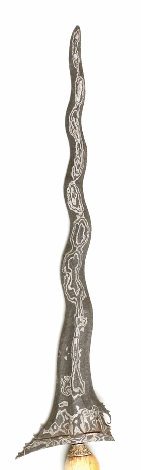

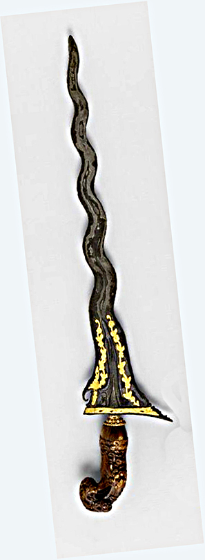

The collection of the museum can be reached thru this link:
http://collectie.tropenmuseum.nl/Default.aspx
It is hard to find what you're looking for among the vast majority of pics as the they are so small. I could only trace back one of them. There was a brief description of the outer features and Bali was mentioned as a provenance.
This pic of the blade shows kinatah but that's just about all you can tell about it.
Old 18th December 2017, 08:37 PM   #74
Posts: 7,297
Thanks Paul. I have surfed the Tropen Museum site a number of times.
The photo as uploaded here is a bit too small to tell much, but it certainly looks like it could be a Bali blade.
If you read through this thread you will see why some of us thought that perhaps the originally posted keris may have been from Madura instead.

Fully agree and this 'high rank' Madura kris (?) definitely shows typical Madurese features.
The kinatah is 18 or maybe 22 carat gold? Additional kinatah makes it a precious piece. There is red 'dust' in the gilt pendok, just for decoration purpose or is there a relation with a Keraton?

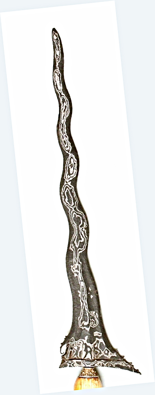

Hello Paul,
The kinatah of your kris looks recently made or refurbished from the pics, and the blade may be Javanese?
I attach the pic of a Javanese kris with an old blade but a recently made (about 1990) silver pendok with topengan.

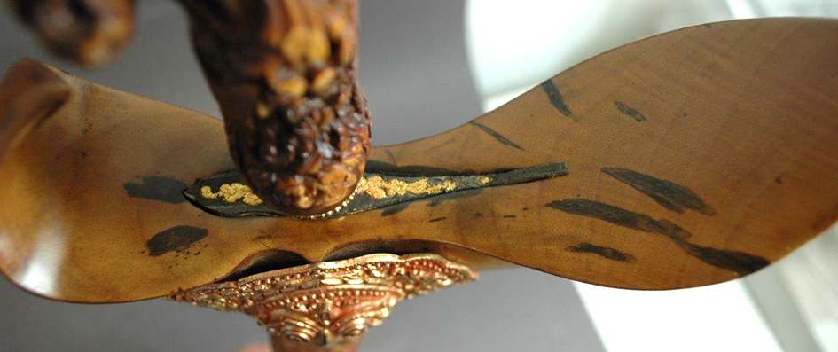

Join Date: Nov 2017
Posts: 205
Kinatah not very old I agree nor superbly made but blade has the perfect fit into a typical ladrang capu slot opening so why Javanese? NG pamor is a wellknown Madurese pamor.

Join Date: Nov 2017
Posts: 205
Additional pic of slot.

Checked the blade and it measures from tip to ganja: 37 cm and showing a wide base and clotchy pamor so doubtfree a Madurese blade.
Old 19th December 2017, 03:12 PM   #80
Posts: 7,297
Well Paul, i won't make any claims of origin since the photos provided don't give me a very good look at this blade, but Madura is right next to Jawa and it is considered a part of East Jawa. I would not be surprised to find a few Javanese blades in custom-fit Madurese dress. So that the blade is neatly fitted to the sheath is not really an indication that the blade was made in Madura.
I also don't see why you site the blade length as evidence of Madurese origin. 37 cm is well within the expected lengths of Javanese blades as well.
I am having a hard time seeing this kinatah as "superbly made", but maybe we just need to see closer, sharper images to understand what you see with the blade in hand.
BTW, we are here in this thread already so we should continue here, but the only similarity this keris has to the ones under discussion is the topengan. This keris probably would have been better suited to its own separate thread. Just something to think about for future postings.

Hello Alan,
Thank you and I won't argue anymore as we are deviating from the original subject, but would you say that every old Javanese blade (including the village and trade pieces) should be aligned to a specific tangguh?
Paul, could you please post a clear picture of the sorsoran of the blade?

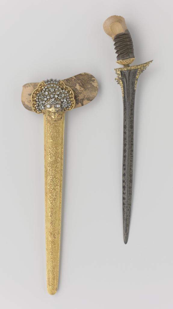

Posts: 188

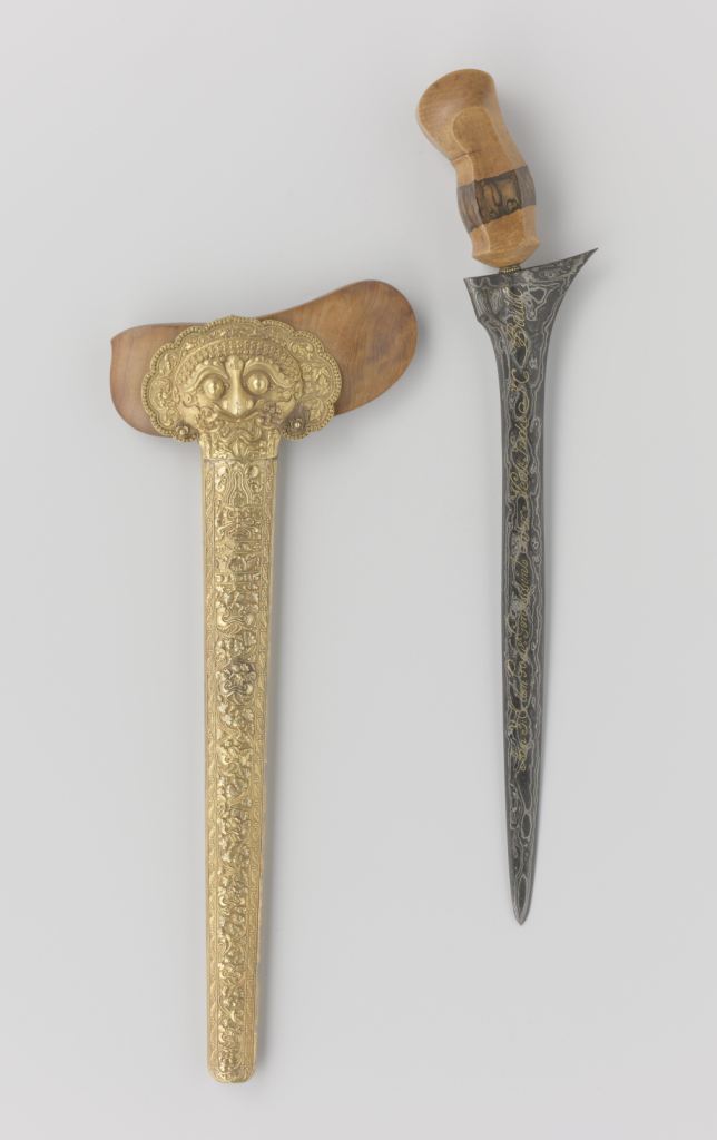

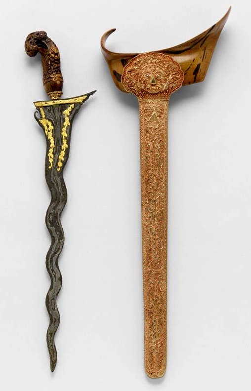

The Dutch Rijksmuseum also has similar topengan pieces in its collection. Both are attributed to Madura.
For photo one, the description reads:
J.C. Baud, Governor-General of the Dutch East Indies, was presented with this kris by Mangkoe Adie Ningrat, ruler of Pamekasan, during his inspection tour on Java and Madura in 1834. The exchange of gifts between native rulers and Dutch officials was important in maintaining good diplomatic relations. A kris, as a symbol of power that protected its wearer against evil, was a highly appropriate gift.
For photo 2:
This kris was presented to King William I by the Sultan of Madura, Cakra Adinigrat VIII, in 1835. In an accompanying letter, the sultan expressed a thousand thanks for his appointment as a Commander in the Order of the Dutch Lion. His gift to the king was a kris ‘made at my kraton [= palace]’. Two of the 117 diamonds decorating the scabbard are missing.
Bjorn is offline   Reply With Quote
