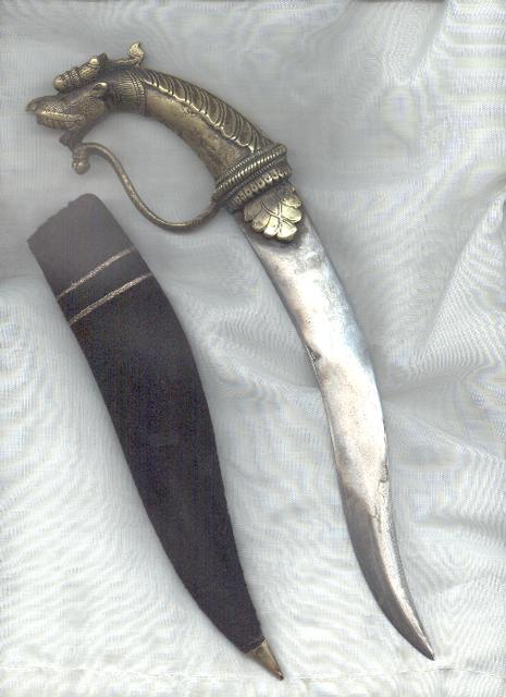

I have decided to open a thread specifically addressed to the Sinhalese kastane as described in the title, in hopes that we might have focused discussion on the many aspects and sometimes complex aspects of these fascinating Sri Lankan swords and their history .
There is of course a concurrently running thread titled 'Sinhala/Sri Lankan swords', however there has been considerable consternation on that thread becoming overburdened with the notable complexities of the kastane in particular.
Obviously the kastane is one of the most distinctly recognizable of Sri Lankan swords, however it would seem that it requires its own specifically titled thread to address its inherent complexities without disturbing a the other threads apparently broader scope.
Some of the aspects of the well known kastane which have been brought to discussion have been

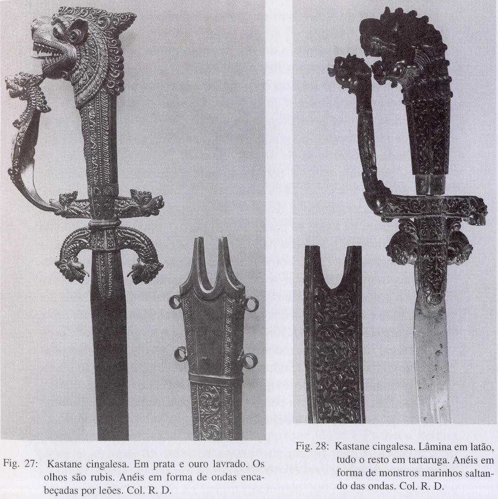

1. Just how old is the zoomorphically featured hilt, and what creatures are represented on its basic forms. While most references typically list the pommel as having a lionhead , which seems to correspond to the name of the people on this island, as well as the island itself (sinha=lion), Sinhala and Sinhalese....there are apparently some variations of the hilt.
2. There are interesting details in the important example of the kastane which was brought to Japan from the historic Keicho mission sent by Date Masamune and returned in 1620. It would be good to examine objectively the resources and data addressing this sword specifically, as has been done in degree on the other thread noted, but hopefully may be continued here.
3. The kastane appears to have developed from earlier combat weapons into the more regalia oriented court sword form in high embellishment. Hoping to establish some type of chronological line of development.
4. Many kastane of the 18th century seem to be mounted with VOC (Dutch East India Company) blades. Were these mounted to supply Sinhalese warriors? or were these used by Dutch sailors using local hilts and the blades off issued hangers?
We know the British were there as well, but as far as I have known, no blades (except bayonets) were ever marked by the English EIC. What other trade or colonial blades have been found on kastane?
I very much look forward to discussion focused on the kastane here, and to add to the advancing knowledge and understanding we have gained on the forum within other threads and discussions.

is it known if any of these can be attributed to specific makers workshops or schools?also anyone care to show examples they own?and if these are derived of simpler undecorated earlier types does anyone know of any?regards napoleon
napoleon is offline   Reply With Quote
Old 12th February 2014, 09:49 PM   #10
Posts: 10,851
Napoleon, I very much agree! Those out there with examples please post them, we really need to see a range of examples so that we can look more into variations in the pommels and other features.
Very good question on the attribution to certain makers or schools. As far as I have known, these were invariably unsigned and produced by artisans who combined their skills on various elements of the swords.
We know that of course, the larger number of these seem to likely be from the Kandyan workshops. However, a great deal of consideration must be made toward variations of these swords possibly produced in other parts of the island.
I believe the interpretation of the style and form of the creatures, the pommel head in particular, may reflect either sinha (lion) or makara in various instances. It is always interesting seeing descriptions and captions in either auctions, catalogs or references often using the term makara in a rather collective sense where typically the lion head is what is actually depicted .
As far as I can see, the makara has a sort of trunk or projecting snout, where the lion of course does not. Again, it is extremely hard to identify what mythical creatures are represented
Ibrahiim, I believe you are spot on in your view that the variation in interpretation of the creatures may well be due to cultural, ethnic or politically oriented circumstances.
You bring up a very good point on the blades on these kastane. It seems unclear where the early blades came from but as previously mentioned a large number of Dutch VOC blades appear to be mounted in kastanes.
These were typically marked with the VOC blademark and a date, most seem to date in the 18th century (for some reason 1760s seem prevalent).
I don't believe Ive ever seen a Portuguese blade on one of these, nor British for that matter. Naturally these would be hard to identify as the majority of blades of these types were often Solingen produced . As earlier noted the English EIC did not mark sword blades, only firearms.
I do hope we can get some examples posted which can be examined comparatively .

Hi Jim,
This is way out of my field, but looking for something relevant in the other VOC blades thread, I found two very interesting kastanes.
Most of you probably know of them, but in case not I will add the pictures.
They were captured with a piha kaetta and a canon in 1765 by the Dutch, at the conquest of the Kandy's king palace.
PS. I've also added an image of the canon and the piha kaetta.
