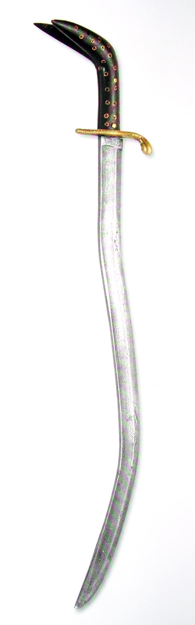

I am surprised this has not been brought to attention earlier. This picture is from. "Islamic Weapons, Maghrib to Moghul" by Anthony C Tirri, in this book the weapon is attributed to Algeria/Egypt. I think he is correct as the leatherwork is so clearly North African. Some way from the Black Sea I think? Tim
#12 |
Tim:
This peculiar sword had been variously attributed to N. Africa and even Indonesia (By Hermann Historica, no less!). However, the Askeri Muze in Istanbul has several of them and the curator there told me that it was a well known Ottoman sword called Laz Bicagi. Second, look at the picture: http://www.vikingsword.com/vb/showth...ighlight=black No doubt what it is! I agree that the forte looks just like Algerian Flyssa and the leatherwork like a Sudanese Gile, but.... This is a classic example of a mistaken identity; it teaches us that superficial similarities do not establish provenance. Ahriman: I handled quite a lot of them. The point is very, very thin, almost needle-like and I saw several with bent points. The forked pommels break easily (see the original picture in this thread). Also, the horns protrude so much that wrist bending is almost impossible: worse than tulwars with oversized dish pommels. As a former fencer (foil and saber), I could not wield it with ease no matter what kind of grip I used. On the other hand, since these swords were primarily "pirate" type weapons (that's what Lazes did on top of smuggling) they were sure scary! As a psychological warfare these swords were great but technologically they were less than adequate. |
#13 |
Posts: 5,986
How right you are. What a shame Mr Tirri should get something like this so wrong. Those pictures show wonderfull plain working weapons, thanks Tim.

The first time I saw this guy I thought "what a weird manding/sudanese sabre"
#15 | |
Posts: 987
There are some ways to reconcile the two, for example taking into account that Ottoman troops may have brought it with them to places like Egypt during the Ottoman Empire period, or influence going the other way via trade or population movement. I think one unanswered question is how far back the style goes, which is always an interesting question to me, as it can open up possiblities of cross-cultural influence, or exclude others that would have post-dated the earliest appearance of the style (for example in this case, if it predates Ottoman presence in N. Africa). |
