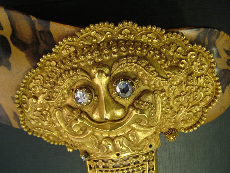

Originally Posted by Gustav
A rather bad picture (sorry!) of an early balu mekabun or veiled Durga hilt (in Europe before 1590), made from rhino-horn. This is the Deutschordens-Keris in Wien, I don't have the Krisdisk, but there must be a much more better depiction of it.
There is a chinese source (also Hasrinuksmo/Lumintu 1988: 19)mentioning short swords with rhino-horn hilts, send as a gift from Maharadja of Kahuripan to China (11 century?).

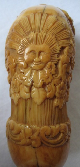

Thank you Michel for advising us of your reasoning process used in estimation of age of Madura keris hilts.
I believe it is reasonable to assume that following the alignment of Madurese rulers with Dutch interests, symbols associated with the Dutch began to appear in Madurese keris dress and other Madurese ornamentation. A nominal date of 1825 is probably reasonable for the commencement of this practice.
However, although the presence of symbols associated with the Dutch may be able to be used to support an estimate of production time after 1825, the absence of such symbols cannot be used to support a production time prior to 1825.
The relationship between the royal houses of Surakarta and Suminep is well documented, and the speculation that the presence of a symbol on this hilt, that appears to be the sun, could represent such relationship is interesting. My personal opinion is that when we indulge in such speculation it is probably advisable to provide some evidence in support of the idea. The field of keris study is riddled with good ideas, and very often, these good ideas tend to become accepted fact, but "accepted fact" lacking any evidence in support of it.
It is very dangerous to hypothesize in the absence of evidence or logical argument, and most especially in respect of a culture and time that differs from our own.
Hi Alan,
Yes i do agree with your point that the absence of these indicators is not a garuantee tht the age of a hilt is older than 1825. But that is a general thing with indicators, its a indication of posibility. That combined with other indicators like material, other paterns, the state of the material, sometimes even a feeling and so on, can give a good impression. Maybe in some times can give some "proof" or suport that it must be of certain age, atleast give a good estimation. Iff not so, how can it be that museums or other experts can give a clear age to a hilt or blade or other material? I personaly dont think that carbon dating is used on all things in collections of museums. Panting can be indentified and given a age by the painter.. his time of life, style in a erra of his live.. But it cant ben done with hilts.. Maybe you can suport us ith some info about how its been done, or about some other indicators. My knowledge on this is still in my eyes limited..and always willing to learn and know more.
About the suporting info for the sun on Danny's hilt. One of the experienced members of the Dutch keris study group have told us. I do have confidence that he does have done reseach and got suporting info of this. But i have posted it as a posibility, not as a statement or fact. I do apreciate and agree with your caution to not see a post of this as a fact. but if i or others dont post there posibilitys it would be difficult to get a good view and later to result of fact. That is why forums do exist, even in the old times. To get a agreement of accepted truth, by reasoning and discusion. I wil try to ask the person iff he would like to give me and all people here some more info on this. Maybe posted by me, or him self.
Regards Michel
Ps link to hilt with also a sun. Link

Re the sun.
I eagerly await further information on this motif.

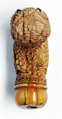

some thoughts regarding the iconography on this hilt (the first part).
I must apologise for I am making the first steps gaining some superficial knowledge about art of Java, so I probably should not post about this subject at all. Almost all of this is a pure speculation.

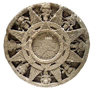

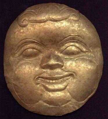

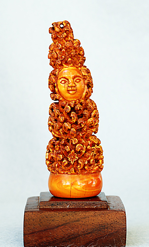

At first, the sun-motiv or the motiv with a face or flower and rays around it.
At the time of Mojopahit, there is a symbol called Surya of Mojopahit, which possibly was the royal emblem (or one of emblems) from the Mojopahit era. The components are a disc (often with an image of Shiva or Dewa Surya riding a horse or in a chariot), surrounded by eight beams of light or beams of light and eight Lokapala gods, who are guarding the eight cardinal points of the universe.
The most simple version of this simbol is a disc of sun with stylised rays of light.
Regarding the face in the middle, often such frontal faces (one of the images is a frontal face from Majapahit period) are occuring as Kala (Bonaspati on sarung, one of the images). There is a close relation between Surya and Kala, as I have understand Kala can be a manifestation of Surya.

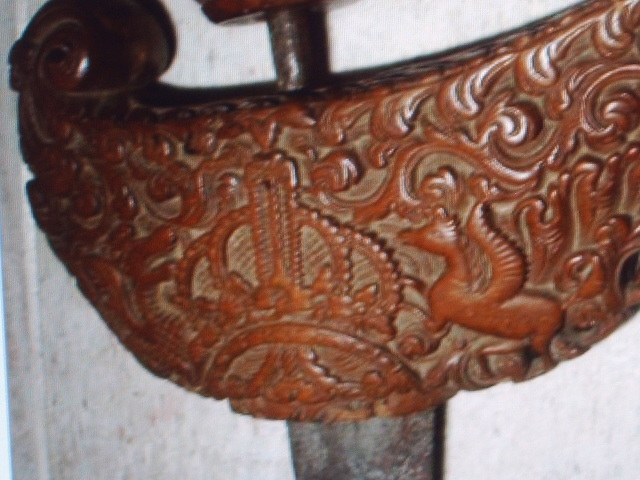

Interesting for me is a Madura hilt from the collection of Alan (I apologize for using the pic from an older thread), where a frontal face in a tree of life is depicted. Kala as Bonaspati is "the Lord of the jungle", but of course this face doesn't have the Kala characteristics (the visible dents).
There must be some links from Majapahit to Madura. Trunojoyo, the rebel from Madura in 17 century, claimed a descendance from a Majaphit royal line.
I don't know, how much of this all was evident in Madura of 19 century. As I understand, an important subject in javanese art is the increasing "hiding" of things with important meaning, the dissolving of them within a longer period, the overlaying of some aspects with new meanings, which is evident also in keris.
There must be (in 19 or probably even 18 century) a fresh influence from european art, where this symbol, a frontal face with rays as sun, occurs widespread at latest since Rococo (1730 thies), regard the friderician Rococo in Potsdam, where it was also like a royal emblem and almost a witness of this style. I have no image sources from Versailles in 17 century, but I suppose it must be found also there. One should (if he is interested in the art of Madurese hilts) really study the british and dutch uniforms from this time, military orders, graphic designs used for important colonial papers, the battleship decorations...
It must occur also in some star forms of military orders, the rays there often are surprisingly close in shape to one of the Surya from Majapahit (image). This kind of "military" star (or a half of it) you can see on some helmets on Madurese hilt helmets : http://madurakeris.fotopic.net/p48012558.html
See the same hilt for draperie at the base, which is the same art as on the hilt of Danny and clearly european influenced : http://madurakeris.fotopic.net/p48012560.html
I deeply apologise for using links to pictures from Hidayats site as examples.
Old 13th January 2010, 01:31 AM   #79
Gustav
Join Date: Jun 2009
Posts: 1,346
The second part.

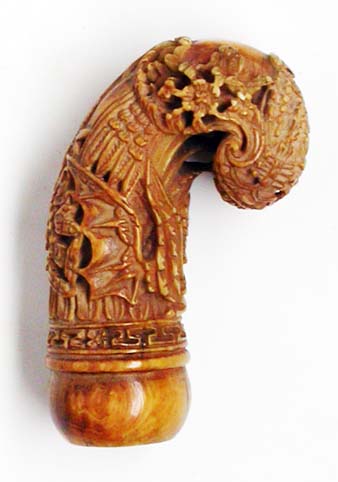

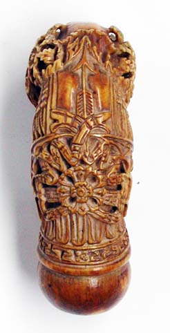

It seems to be clear, there is an iconographic ensemble, and there are many hilts which are bearing the complete ensemble. In the book by J.Greffioz on hilts you can find one on page 44, which seems to have some age, and another on page 56.
Some details are more clearly visible in Sajens example, page 2 in this thread.
This ensemble contains roughly estimated (from top to toe): sometimes more, sometimes less clear "visor" with crown elements, two pairs of wings, two emblems with radiant rays ("sun") and draperie at the base.
Interesting are the wings. There are clearly visible "dragon" wings, but also, abowe them, "normal" wings with feathers. Is there a possibility, those wings are the substitute for the complete dragon and winged horse depiction on a usual landhian pulasir hilt?
An interesting "in between" form from an older thread (I deeply apologise for using these pics), with a complete horse (instead of the front sun), the dragon wings behind the horse's wings, and the sun on the back of the hilt (see the images). There are also draperies at the base (like on Dannys hilt), and something resembling a crown with a central, vertical band on the "visor", which also occurs on all examples of the complete ensemble of Danny's.
The different elements are of course the arrow (a coat of arms emblem?) and the rudimental epaulets, and the "chinese" meander at the same base, which (very interesting!) changes almost to a draperie at the back, below the sun.
After this I suppose, there could be a possibility, that Dannys Ensemble as such were established later then landhian pulasir, becouse of dissolving of certain elements (the bodys of dragon and horse, if they are meant at all ), and becouse of mixing of elements. Also I think, there is a undeniable european influence in this hilt.

I found in net an image of a Madurese wrongko. You can see the same form of crown with a decorative feather in the middle (the form on the "visor" of the hilt, regarded in this thread) , flanked by a dragon and a winged horse. So, I think, there is a strong possibility, this ensemble is related to landhian pulasir, there is a crown element, and therefore it has european influences.
