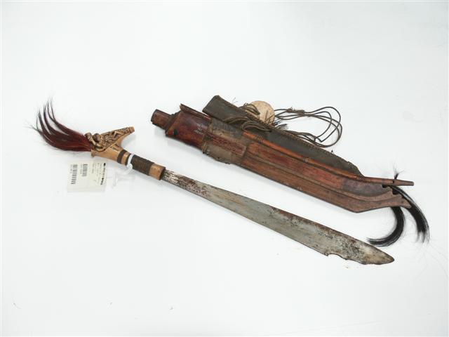

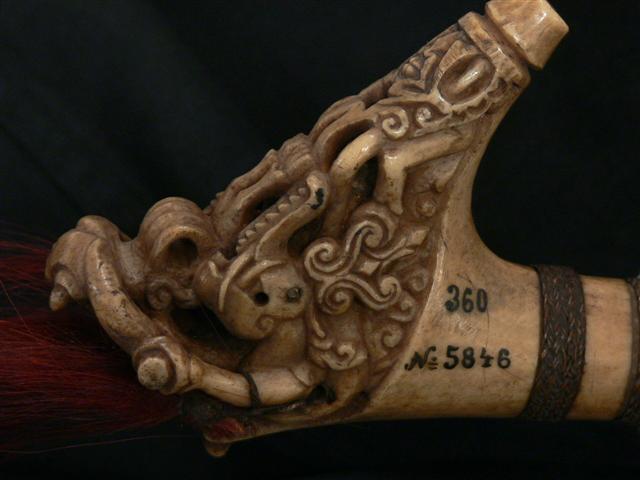

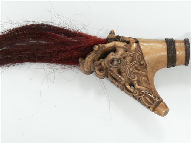

Thanks for addition info about Kutai mandau, but i don't think Arjan has said he thought mine was from there.
I wish there were some different angles on the photos of your example Arjan, but i can now see on the top the same style of opened mouth creature that is on mine so now that is 2 motifs in common between these hilts. There definitely seem to be from the same area to me. I wonder if the museum you found it in has any more information of were it was collected?
Here some more pics.
Mytribalworld is offline   Reply With Quote

One more stylistic motif in common with these two hilts would be that "joint" in the carving that looks somewhat like a nut & bolt viewed from the top. I have never seen this on mandau hilts before either. All very interesting stuff for me. Now, if we can only figure out what these different motifs actually represent.

I think indeed we can cassify this as " possible Bukit mandau"....
is it possible to show the "neck"?
