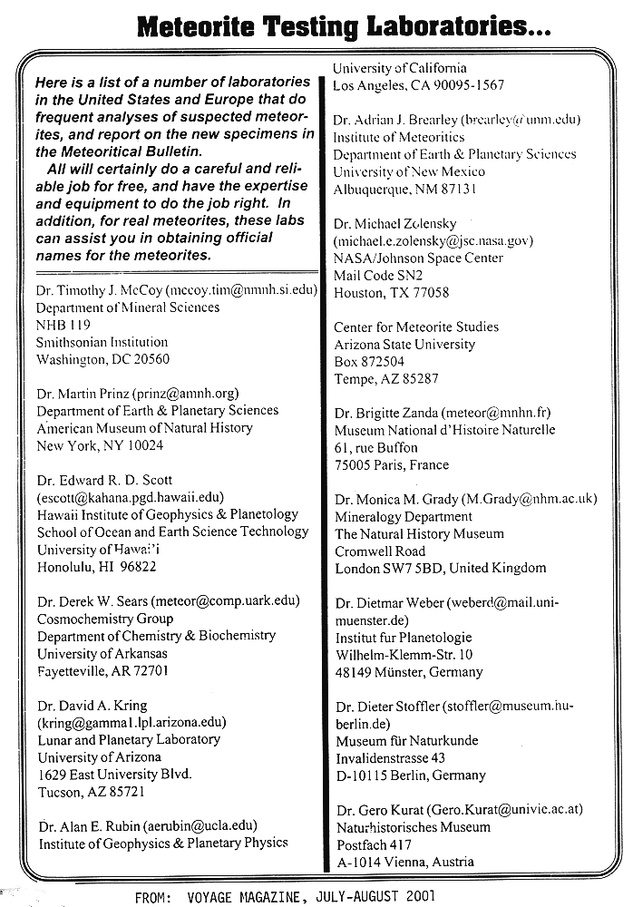

For you brave of heart...
Here is an old list...
Maybe, with a little soft shoe and sweet talk, someone could talk one of the following labs into doing some “unknown” testing... for feasibility. Maybe some students need some practice, or may want to do a paper or something on this subject. It would make an interesting thesis.
