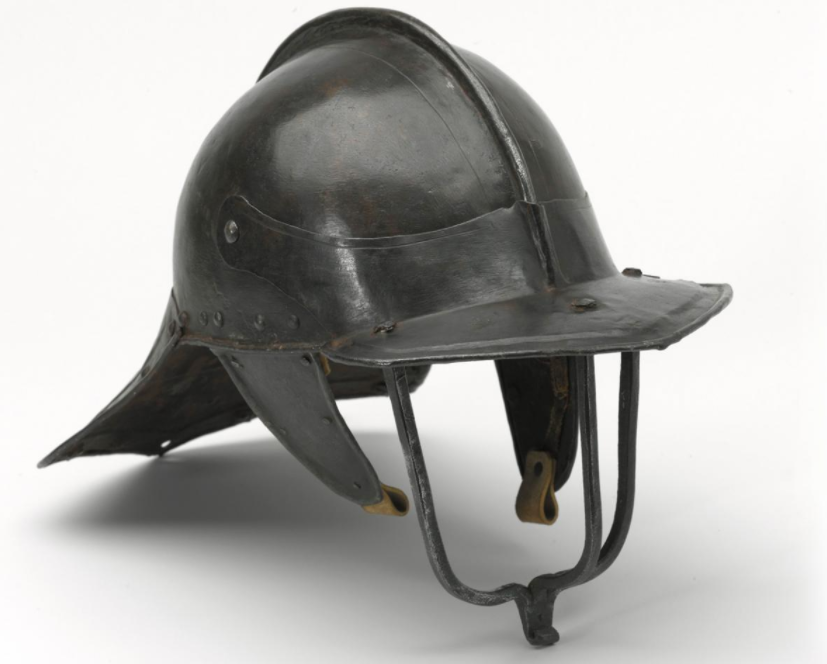

And in case you don't fancy such solution, you can always opt for the hinged three bar version, like this 1640 harquebusier real thing.
(British National Army Museum)

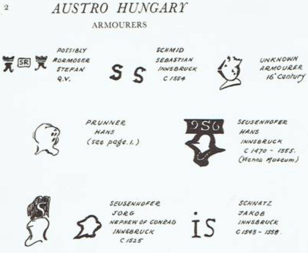

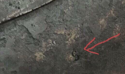

When looking through ”Armourers’ Marks” (1959) by Dudley S Hawtrey Gyngell I noticed how armourers in Innsbruck, Austria in 16thC used their initials (one or two letters) as maker’s marks.
My helmet is marked with a Gothic ”S” on the bottom lame on the neck guard which is probably the maker’s mark from Innsbruck, Austria or elsewhere in the Tyrol.

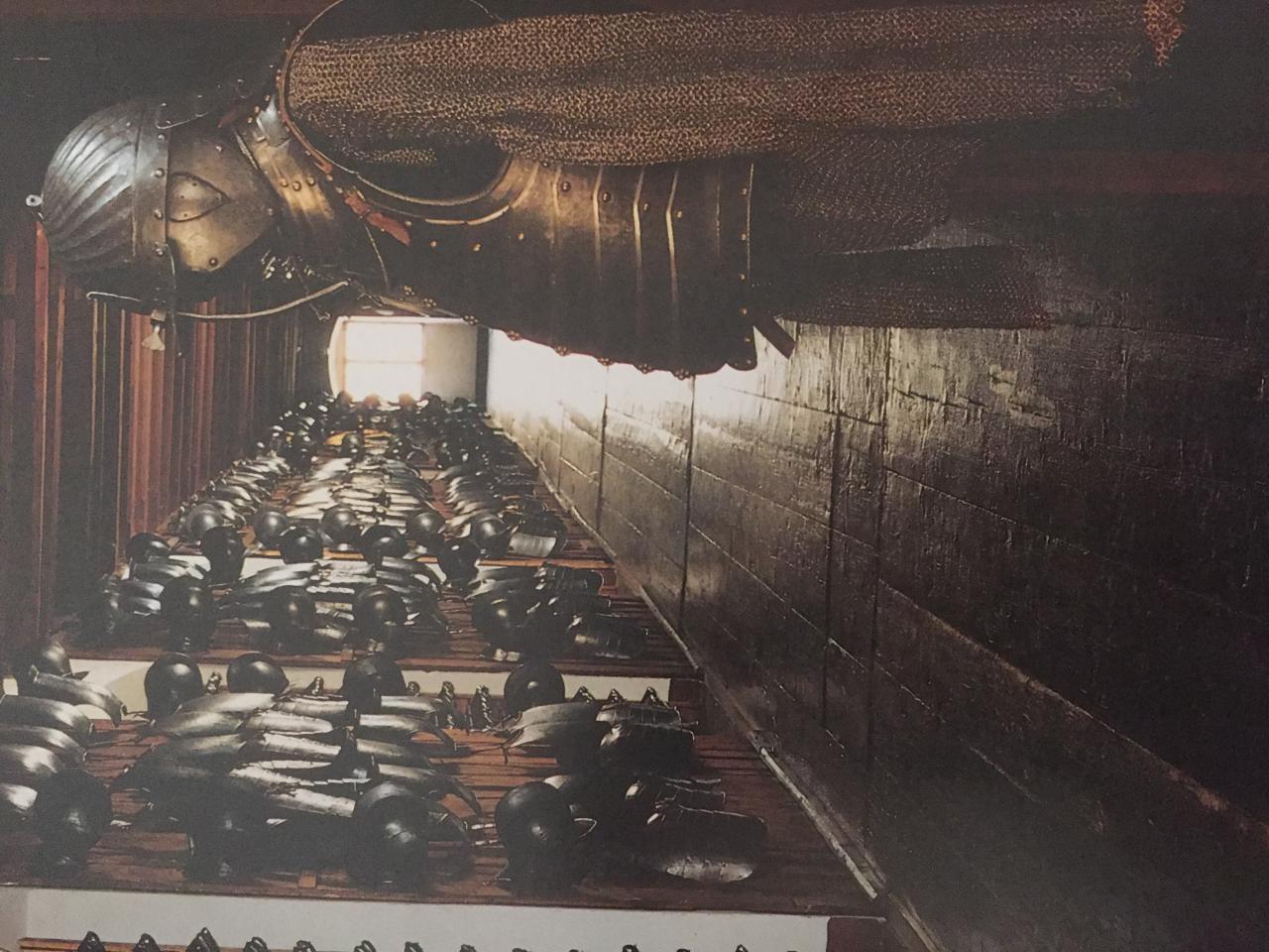

I saw some interesting and relevant pictures in Peter Krenn and Walter Karcheski’s “Imperial Austria, Treasures of Art, Arms & Armour from the State of Styria” (1998).

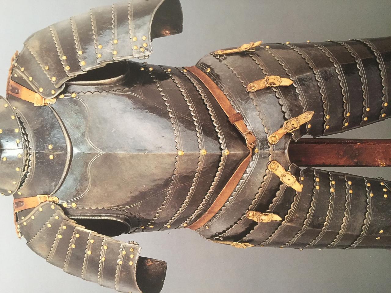

The first picture shows armour for an infantry or light cavalry officer, 1555-21, probably made in Innsbruck (Austria). Of interest here is the lobed edges/heartshaped rounded crenelations on the top of the armour plates which is similar to my zischägge. There are also brass rivets (presumably removed from my helmet).

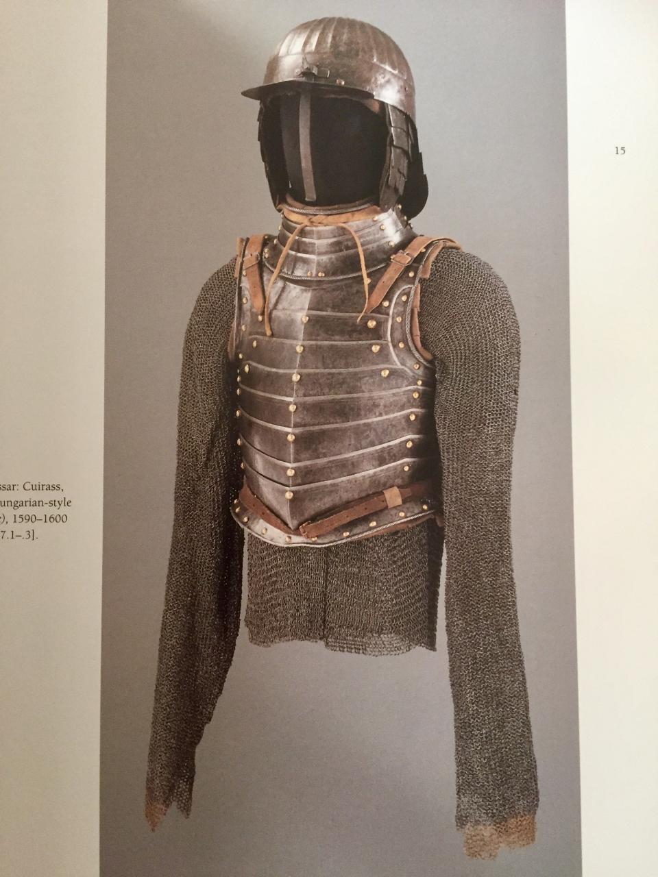

The second picture shows armour for a hussar: cuirass, mail shirt and Hungarian-style helmet (zischägge), 1590-1600, made in Graz. Interestingly the helmet skull is fluted. This type of helmet originated in Turkey/Ottoman empire known as cicek and was adopted in Eastern Europe in 16thC and Western Europe in 17thC.
The third picture shows an interior view of the Landeszeughaus Graz (armoury) with another classic medieval hussar outfit on the right, again with a fluted helmet. The fluted area helps to absorb stun impacts by maces and war hammers popular in Eastern Europe and the Ottoman empire.
