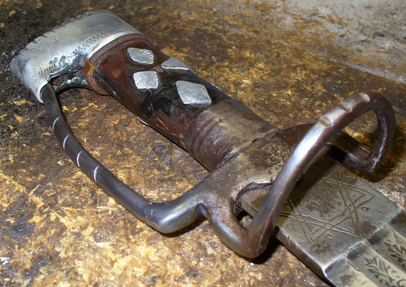

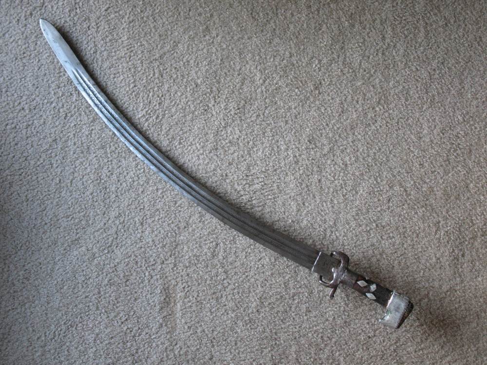

Gents, I bought these East African swords at a swap meet recently and researched that they are Ethiopian. Are these hard to find relics?
There is not much to find on the web about them and I'd appreciate help in better understanding them.
Bill

These two swords (very nice BTW) are indeed Ethiopian.
The one with the lionhead is a stirrup hilt sword of military type and appears to be Italian. These seem to be from the 1890s going by the George V blade, which is extremely nice by Wilkinson, who was of course in London and supplying blades to Abyssinia (Ethiopia) in these times.
The sword itself is termed a shotel, and the distinctive hilt was typically of rhino horn. The enthusiasts here are better at determining what type of horn this is but probably rhino.
These were turbulent times in Abyssinia with the Italian occupation and the Mahdist campaigns going on in adjacent Sudan with British forces.

Hi and welcome,
Both swords are very typical for Ethiopia/Emperorīs times. They are in a very nice condition. The handle of shotel is of rhino horn. (Now you would not find it in Etrhiopia complete - only blades without handles or with some ugly wooden replacements. I looks like complete swords with rhino handles survived in the hands of collectors only ...)

Hi Jim,
I believe that the term SHOTEL to which you refer to is not in fact the correct description to the subject sword (with the horn/rhino hilt). The correct term for this particular blade shape is in fact GURADE.
The term SHOTEL refers to the "double" curved blade also found on Ethiopian swords and shown in the pic attached.
As an aside, Wilkinson and various Solingen makers made and shipped many hundreds of sword blades to Ethiopia which would have been locally mounted. A large % of these bore various inscriptions in Amharic language as shown on the Wilkinson blade above.
Also attached is an early advertisment from Wilkinson for Ethiopian blades.
Stu

Actually I appear to have made compound errors here, and somehow I misread the correct period for George V.....who reigned as noted 1910-1936.,,so thank you Dave F.
As Stu has noted, Wilkinson Sword Co. had supply contracts to furnish blades to Abyssinia into the 1930s.Some of these, as well as those from Solingen earlier, were indeed the dramatically parabolic 'sickles' which were termed shotel. Burton (1884, p.163) described these with considerable disdain , and notes the blade tapering to a point, which "...can hardly be used". The commonly held lore is of course that these sickles were so curved so that the warrior could reach around the shield and stab the opponent.
Getting to the 'name game', the dramatically curved shotel began to go out of favor with the advent of more conservatively curved sabre blades from England and Germany. While some still carried the shotel of the traditional dramatic curve, the shallow blade versions which were hilted with the same shaped rhino hilts became more of a 'shotel' variation. In this sense, many termed them shotel, while technically the proper term locally for sabre was 'gurade'. In the literature, I have seen both terms used, however, over the years the term gurade, in my experience was always limited to the typically stirrup hilted military style sabres.
While on this topic, one of my recurring quests in the study of swords has often been trying to find the origin of the terms used for certain sword forms.Obviously there is a great deal of contention and debate over these terms, and quite frankly, many terms have been used for many years without genuine foundation.
One example was the term 'kaskara', which I was surprised to discover not anyone in Sudan or Ethiopia had ever heard. Efforts to find a source were futile, and even the authorities in museums and authors of references had no idea where the word came from. As in Ethiopia, where these are termed sa'if.....so too was the case in Sudan. It was not until Iain found the origin in tribal language to the west, and probably brought to the west by Burton (1884).
I would ask here if anyone has ever found the basis for the term 'shotel'.
It seems to be another of these generic terms for any cutting item as illustrated in a reference by an 18th century traveler ("Protskys Travels in Ethiopia and other Countries" translated 1991 by Arrowsmith-Brown...which uses the term 'shotel' to refer to a carving knife,.
Perhaps somebody out there reading this might have some information or ideas toward this.
