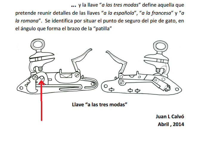

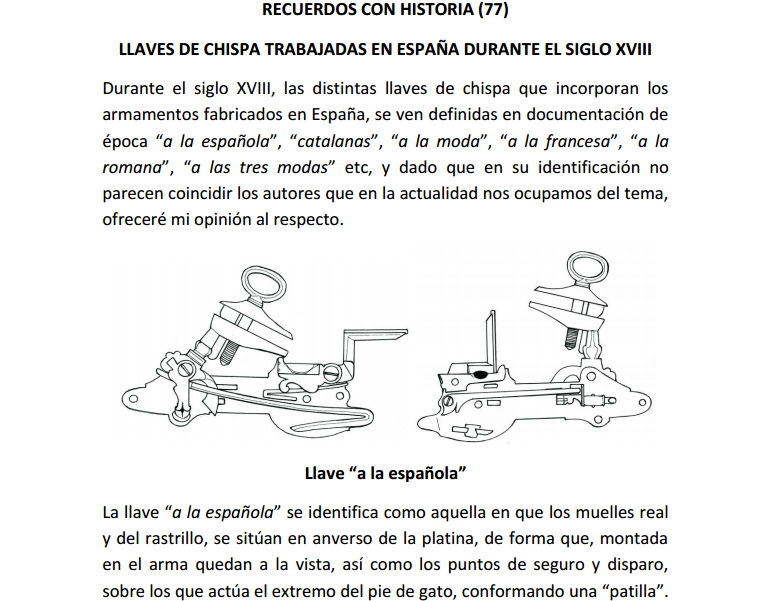

Nothing to say, Fernando; you are the one who knows. But as i previously approached, it is Calvó himself that admits the existence of different interpretations.
http://www.catalogacionarmas.com/public/recuerdos77.pdf

Exactly, the page of Calvo is missing the copy that has been accepted by Dana. The one that has the bowl with its built bridle, and that is the one that refers the document of the real Palace that is reproduced in LAVIN

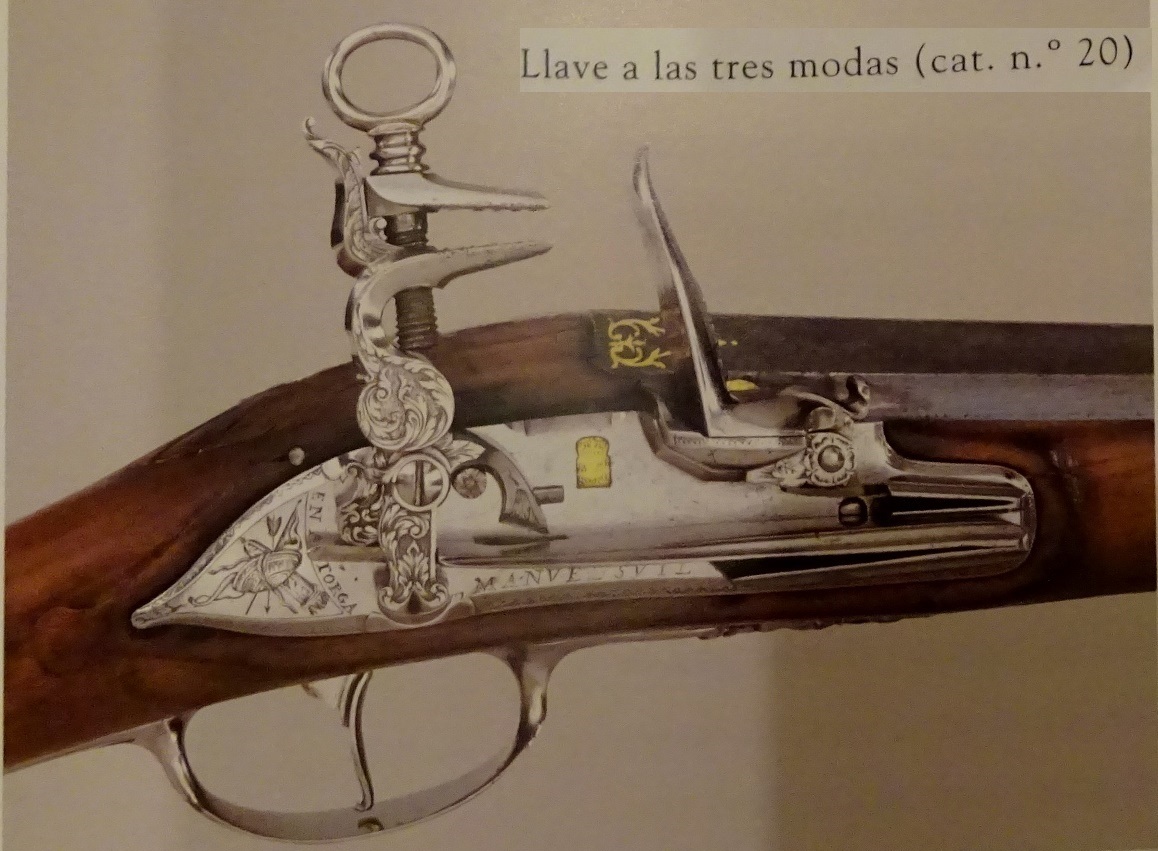

Caro tocaio
In what page of LAVIN's book is that reference ?
Here is an example of llave a las tres modas, made by Manuel Sutil in 1741, as illustrated in the Catálogo de arcabuceria madrileña (Real Armeria de Madrid).
Is this the correct style ?

Namesaque
Yes, it is the correct stile

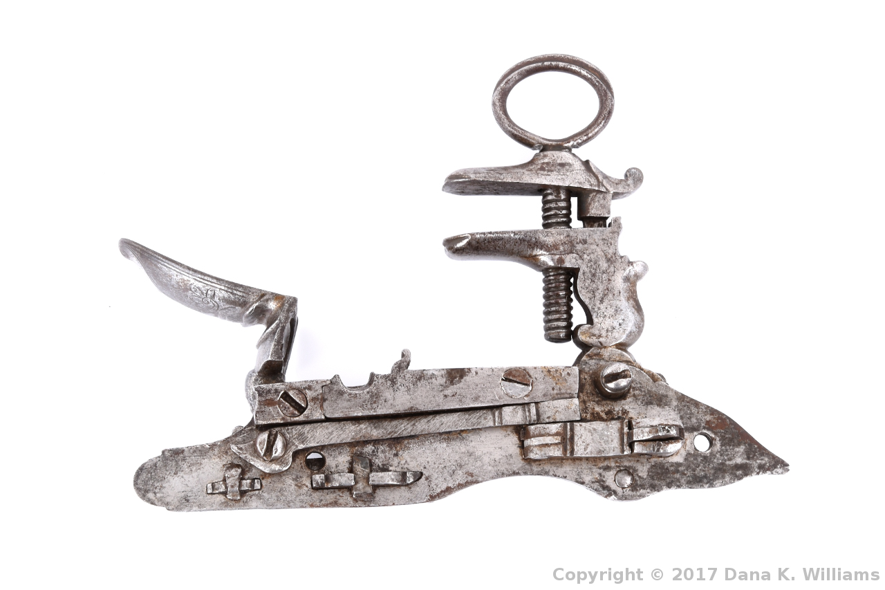

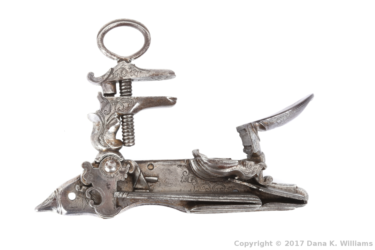

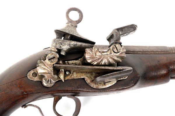

I've removed the lock to check for additional markings. Unfortunately, there are none.
For clarity on this particular Miquelet Lock, I offer these additional photos.

Hello everyone
Although the lock does not have any inscription, it shows an excellent work in its realization and even the engraving of is of quality
Thanks to Dana for the photos
Affectionately. Fernando K

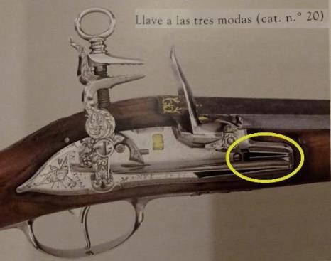

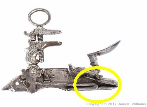

I assume my limitation and confess my difficulty in discerning some technical details between the various lock variations. This is agravated by the lexicon applied by Fernando K being subject to engine translation ... not the best for converting technical terms. If i try to figure out the meaning of the expression 'bowl with its built bridle', i realize this means 'frizzen fixed in the pan', a detail i find too subtle to distinguish by myself when i look at the different versions; perhaps more visible if i saw these differences well signaled...
But what i think i discern with certainty is how the frizzen spring is situated 'above' or 'in front' of the main spring which, being the Armeria Real example considered correct by Fernando K, doesn't however correspond to that of Dana's example, both assumed as being part of the tres modas version. Would it be that, as Calvo (and not only) notes, Miquelete variants classification is somehow discussable ...

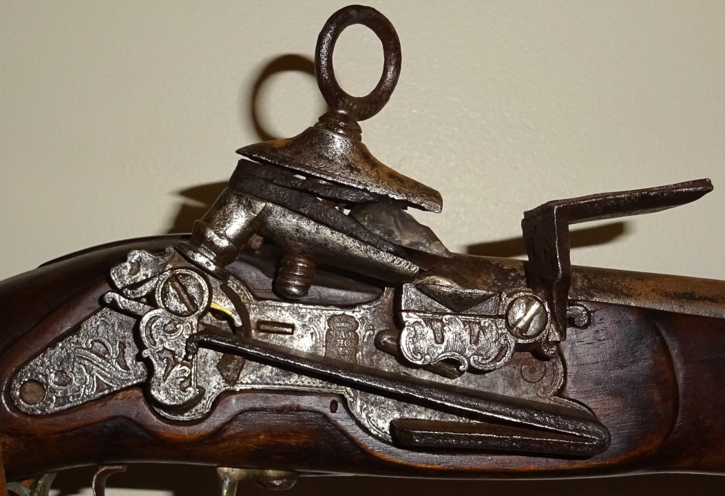

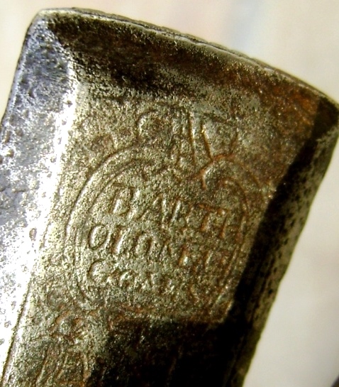

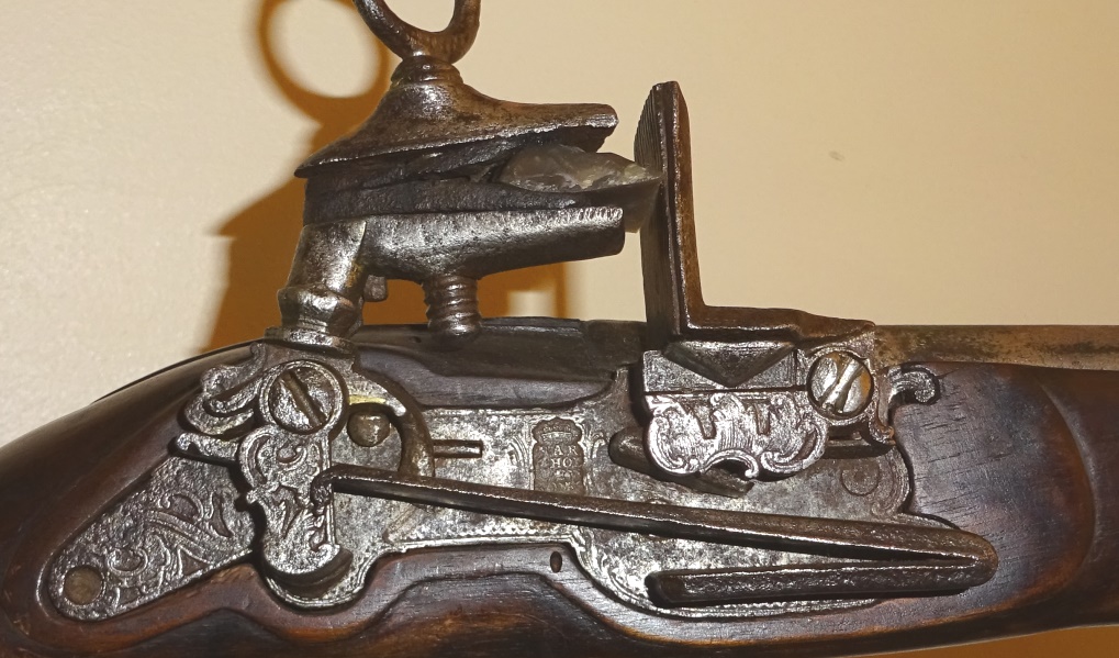

Speaking of patilla lock variations, and if Dana doesn't mind, i here upload an example of Portuguese 'patilha de invenção' lock, made by master Bartholomeu Gomes, dated 1781.

I certainly don't mind fernando. Collectively we have access to many wonderful examples of Miquelet Lock styles. The forum gives us a good opportunity to examine any unique differences.

Hello, namesake
In spite of the difficulties of the translation, I respond to your concern
First. The big difference with the key "to the three fashions" is in the flange of the rake, that in the miquelete is false (under the knob) and in the key to the three fashions, as in the French key, the flange forms part Integral of the cup (Estrivillo, says the document of the Palace reproduced by LAVIN)
Second. The spring of the rake is visible, and not concealed as in the miquelete, under the flange and concealed by it, and the vetice points in the same direction as the major spring, and not as in the miquelte, which has vetice Towards the cat's foot and the end pointing to the front end of the platen. The fact that the spring of the rake is located above or in front of the major spring is inconsequential, and depends on the builder of the key, and the length that he wanted to give to the stage of the key.
Third. Sometimes, the spring is not bent but curved, as is the case with some examples of miquelete, but it is still visible (although the cup has a flange, as in an example shown by Calvo), but it follows the same orientation as In the key to the Roman
Fourth It may be noted that the position of the half-mounted chock differs in the two exemplars, but is not definitive.
I think that's all

fernando, do you have a photo of the Bartholomeu Gomes lock at half-cock?

No ... but i can take one.

Thanks. That makes the half-cock sear obvious.
dana_w is offline   Reply With Quote
Old 25th January 2017, 03:53 PM   #55
... And the frizzen spring so hidden behind the pan base decor.

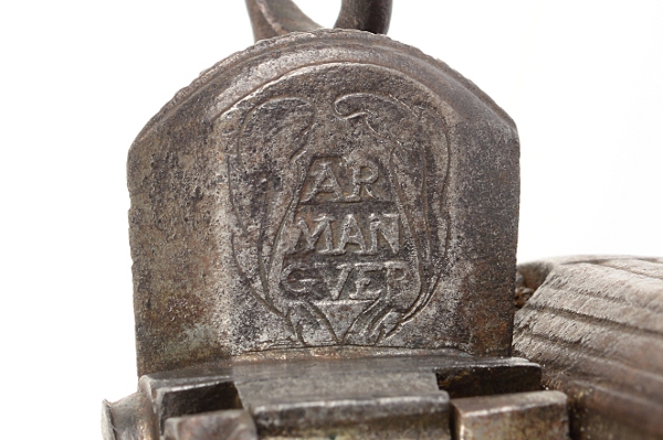

For comparison this Patilla style miquelet lock is by Armanguer, a gun-lock maker who worked in Ripoll circa 1675

In this case the half and full cock sears working in a different order position, right ?
BTW, is this one yours ?

That is right fernando. In the case of the lock by Armanguer, the half-cock sear is below the full-cock sear. For your Gomes lock it is above and doesn't engage the toe.
