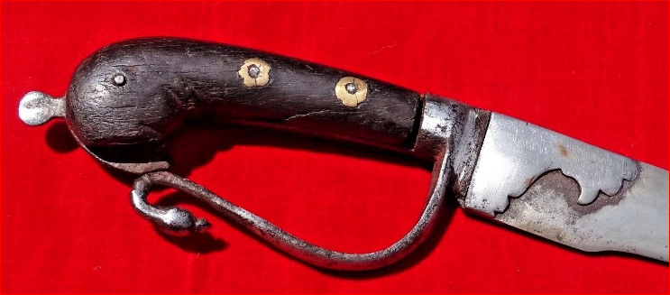

The horsehead (in India termed 'hayamukhi') is a popular motif, it seems most often found on dagger hilts from Jaipur and Rajasthan (Pant,1980, C, CCXXIII, CCI ). While Rajput favor would be presumed, this form was also known to be used by Mughals in richly carved jade, nephrite and crystal.
A full length sword with horsehead hilt and ganga yumuni (chevron) blade is also found dated 1750 from Jaipur.
It seems that the crossing of well known dagger form hilts and longer or full length sword blades is not unusual, in fact the lighter profile of this hilt with the knuckleguard brings to mind the Indian bichwa and chilanum.
The presence of the tunkou on this is notable, and would seem indeed to recall Central Asian and perhaps Ottoman influence. We have seen that the tunkou feature is well diffused through Turkic spheres, it is not as commonly seen in this style in Afghanistan and India, though similar koftgari applications are of course known.
The tunkou it seems according to scholars such as David Nicolle and Philip Tom, was indeed most likely intended for securing the sword in its scabbard. In the case of numbers of Chinese sword and others with the feature on the edge rather than back near the guard, it is presumed to have acted as an added ricasso for finger protection.
In most cases, swords without the tunkou seem to rely on the langet for placement and securing the sword in its scabbard.
This particular horsehead sword does seem to resemble those bring discussed with knuckleguard and recurved terminal as well as tunkou, and I would be inclined to agree with North India, Afghan regions.
BTW, is there any scholarly study linking the koftgari with the real tunkou-like elements?
I agree that this may be the reason for the original and later Chinese take on this (with the main element along the cutting edge). The ricasso of Indian blades will pretty much fulfil the same functions though.
I can also see that thickening the blade along the edge may help to make an easier fitting scabbard and, especially, help avoiding wear from heavy use.
However, I don't see any advantage for scabbard construction if pretty much only the back of the sword blade is thickened. For wootz blades as in the other thread this feature certainly is important to securely attach the hilt (short of functional alternatives found in Indian swords).
The langet is certainly another good approach. However, a global comparison shows the majority of swords without any dedicated "locking" mechanism and good workmanship seems to go a long way in crafting scabbards with excellent fit and secure carrying/wear as well as nice draw characteristics.

Tunkou was created for a particular function explained above.
Subsequently, it became a purely decorative element, largely presenting as just a decorated triangular (mostly) part of the root of the blade.
The technique of decoration varied from place to place and koftgari was used for that purpose in the places where koftgari was a popular decorative technique in general. Some examples of tunkou used magnificent combinations of gold inlay, gems etc: see yataghans of Bayazet and Suleiman. Some had massive tri-dimensional plates: Greek for example. Cheap Turkish yataghan had just an outline of tunkou scraped into the body of the blade. North African Yataghans often carried miniature crenellated round all-metal plates. And you are right: the "Indian ricasso" was quite likely a distant descendant of the original nomadic wide and blunt root.
The "orientation " of tunkou also changed: originally , the long arm of it went along the edge, but already in the 14 century we can see it going along the back of the blade.

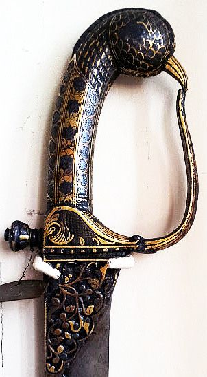

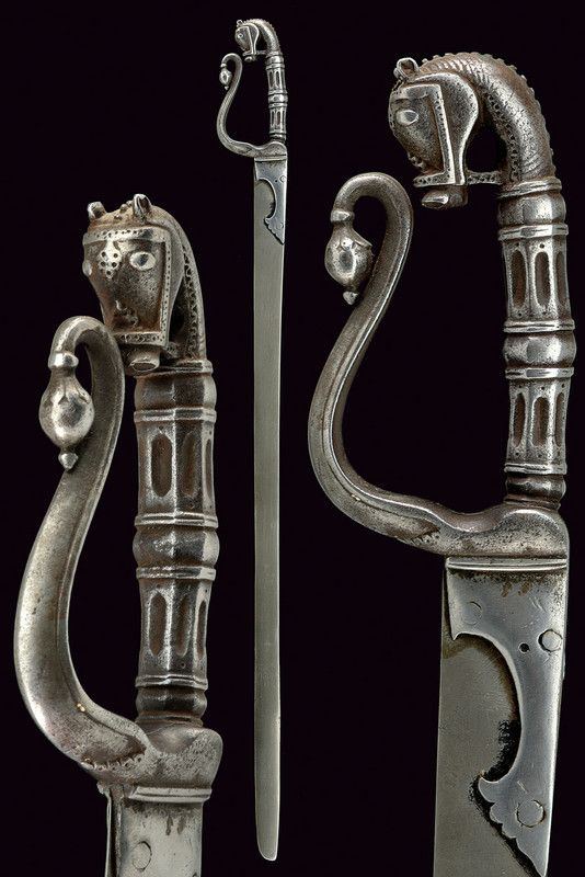

I found another sword hilt to comply with the design being looked at. In this example it appears I think, as Moghul form but with a broken knuckle guard and it is a Birdhead with knuckle guard and Tunkou...
Illustrated as a museum exhibit it reads; Quote"Indian sword hilt from the collection of Arms and Armour in the Prince of Wales Museum, now known as Chattrapati Shivaji Maharaj Vastu Sanghrahalaya, Mumbai India.'' Unquote.
See https://www.pinterest.com/pin/397372367093427700/
Old 25th July 2016, 12:35 AM   #39
Wow!!!
Up until now, all examples were very modest, kinda " village-like".
This one is high class.
Man, this pattern was not only for "unwashed masses":-)
Fascinating.
Many thanks.

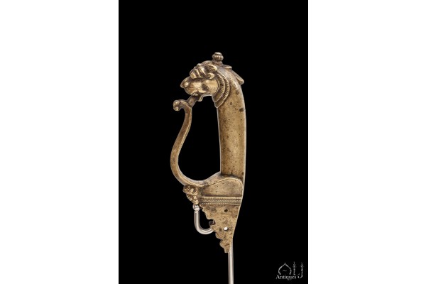

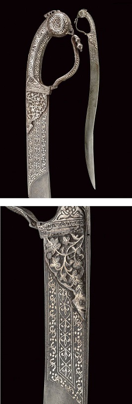

I stumbled upon this at http://www.aljantiques.com/a-bronze-...h-century.html Just the hilt... Amazing!!
Old 16th August 2016, 02:30 AM   #44
Indeed.
Looks very South Indian to me.
Perhaps I might have been wrong insisting on Nortwest Frontier? :-)

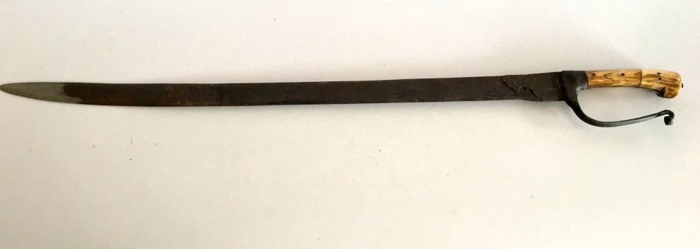

Old 14th October 2016, 06:48 PM   #47

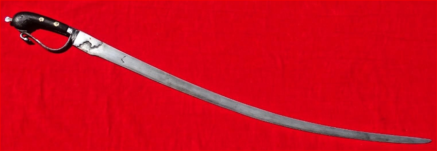

When it rains, it pours...
Two more. No doubt: we are talking about a real , but heretofore non-described pattern

I only see one weapon as the other is at #1 ...
Old 15th October 2016, 01:32 PM   #49
Black handle, white handle... :-)

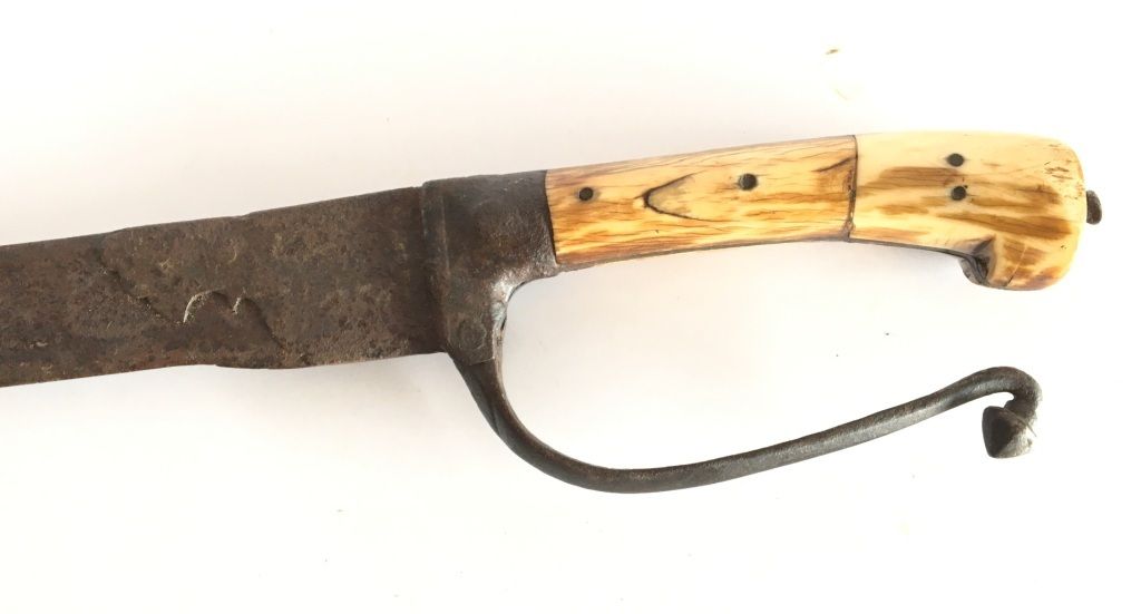

Old 15th October 2016, 05:02 PM   #50
Posts: 10,851
This is an intriguing scenario, these compellingly similar sabres sans guard and with the 'swans neck' type knuckleguard, along with vestigial tunkou.
However it begs the question, are these effectively a 'form' or simply a number of cross influenced variant examples.
The cases of swords which are seemingly a particular form except certain components are missing, may be intended as such, or possibly examples with have lost these components.
We have seen shamshirs and various 'Ottoman bulbous hilt' sabres which have no crossguard and have asked, were there occasions where individuals preferred a sword without a crossguard? As clearly many Central Asian sabres such as shashka have been in notable favor and use without guard, would that character be chosen in altering other sword forms? Why?
We have seen the cases of tulwars with the characteristic disc pommel missing, and asked, was it deliberately removed, or simply broken or lost?
It has seemed there have been numbers of such tulwars in Afghan regions and suggestions that these discs impaired the swordsmans hand in its use.
These sabres add another page to these curious anomalies, but in their case they are clearly made in their form deliberately. The vestigial tunkou seems to me a clear nod toward Ottoman influences; the swans neck guard reflects northern India tulwars of Rajasthan and of course Afghan paluoars; and the hilts themselves the shashka and like Central Asian types.
Rather than a distinct form of sword type, this seems more a case of variant which has occurred in some number and reflecting compiled influences. It will require more instances of examples with regional provenance to establish enough consistency to declare a unique category .
Obviously, an intriguing conundrum and interesting type worthy of continued research.

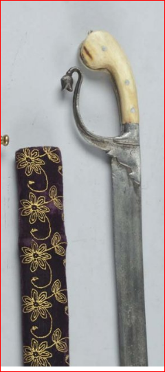

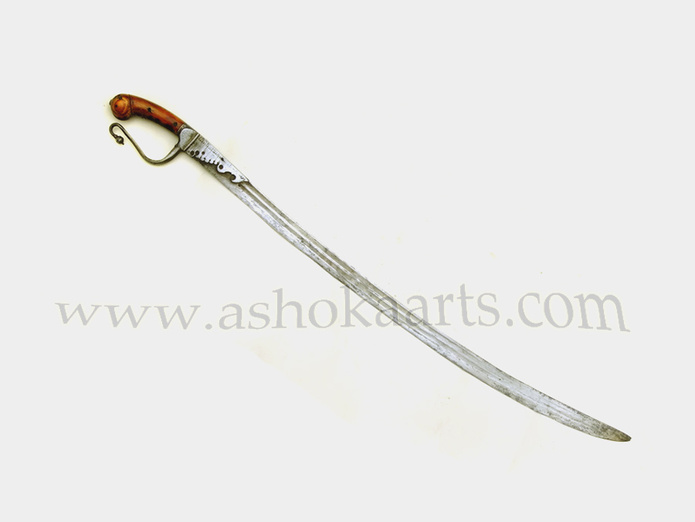

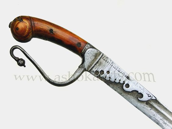

TRY THIS!!

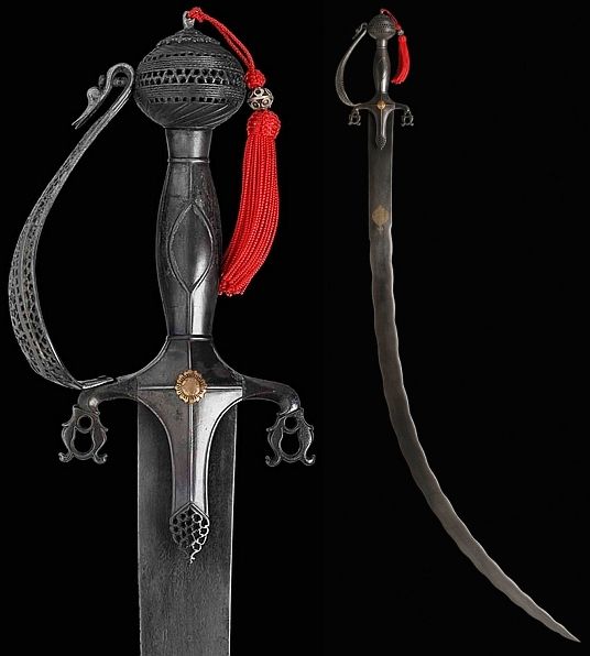

Deccan
sword
from
Vijayanagar
An unusual and rare form of South Indian sword from the Vijayanagar Empire Karnataka. The long sword blade fullered and slightly curved, possibly of European manufacture, a small makers stamp visible near the forte. Long steel blade mounts with fretted and pierced borders, the hilt of 'pistol grip' shape, steel furniture chiselled with geometric decoration(worn) and brass inlay, the ivory grips showing the great age of this sword. Dating to the 17th century.
(THE TECHNIQUE IN ENGINEERING THE KNUCKLE GUARD TO THE HILT SIMILAR TO #38 AND #43 ABOVE)
For more pictures see http://www.ashokaarts.com/shop/rare-...om-vijayanagar
For The Vijayanagar Empire SEE https://en.wikipedia.org/wiki/Vijayanagara_Empire
Old 16th October 2016, 05:21 PM   #52
Posts: 10,851
Well done Ibrahiim!!!
Somehow does the faceted bolster remind you of a 'Khyber knife' (Siliwar) ??

In 43, this example is intriguing as it clearly has the 'sinha' or lion head which we associate with the hilt of the kastane. While the 17th century date is in my opinion somewhat optimistic as we remain unclear on the earliest occurrence of the sinha hilt on the kastane, this coupled with the example from Karnataka, does seem to place these in Deccani context.
The diplomatic and general tribal ties between the Deccan and northern India (Afghan) regions are well established, and as seen with certain hilt features such as with the paluoar, the cross influences between these regions also seem understandable.
Is it possible that the sinha/lion head became vestigially stylized in the knob like pommel of these northern versions? We might tenuously observe that line defining the lower outline of the 'knob' being almost a jaw line! in considering such zoomorphic context.
Also found in Pant (1980, p.113, fig. 293) the tulwar hilt known as 'Marwari'. In Pant's 'system' of hilt classifications, this one is claimed to be similar overall to the 'Delhishahi' and 'Aurengzebi' forms except in the case of the knuckleguard.
In the Marwari hilt, there is a distinctly represented swans head which has a dramatic turn back form.
While Marwar was a highly commercial region in Rajasthan, it would seem that its commerce would be well known in northern areas of India (incl Afghan regions).
These Marwar hilts, in addition to the turn back swans neck, had the knuckleguard with split or cut in the center.
I would note the 'Afghan military sword' which has its distinctive split guard also with turn back of this style, and similar to that seen on these curious hilts of OP.
Hello Jim, indeed the hilt at #43 is interesting since it is Southern Indian from Tanjore. I am not sure we are looking at one form or several splinters of one form. It seems every court sword producer could and did make a variety of bling variants although in the Southern style there seems to be a constant in the way the knuckle guard joined the hilt...It does almost appear to be a zoomorphic, perhaps Yali form, or I thought possibly elephant apparently breathing out the knuckleguard and this is mirrored or at least similar in the way the Kastane is engineered.
I have identified several southern form weapons curiously similar in appearance to the shashqa and with the same join engineering knuckle guard to hilt...The trade proof is apparent across strata although one could be forgiven for making it up !! The Deccan was instrumental in the Poulouar form and coincidentally the Central Asian Bukharan exodus caused by the Russians in 1920 may have also pushed the Shashqa into Afghan areas thus fusing or influencing hilt style...Eastern style may also have entered Southern Indian design from the many trips by the Chinese to the region when Tipu Sultan was in power. Being awash with mercenaries from everywhere (including Central Asia) it need not be surprising that hybrids and variants sprang up in the Deccan.
Notwithstanding that confusion I am aware that two of the weapons although similar are called different names... The one is a bird head but the other is a pistol grip...therefor neither are technically Shashqa...because of the shape of the hilts and because they have knuckle guards. Could they both be court swords? This would possibly place them in the category ("Bling") Court Swords ...Southern India.

In considering the Zoomorphic Elephant head and trunk forming the knuckleguard and how it is joined to the hilt ...I propose that the sword may be linked to those directly involved in the war elephant role... The sword is lightweight but effective perhaps as a secondary weapon thus it may be an Archers sword... or that of a pike-man seen on the elephants back... An Elephant Crew members sword !
