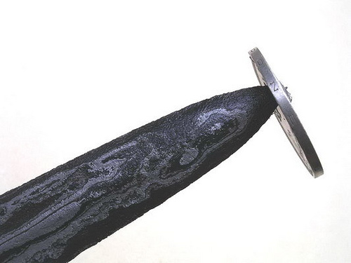

on several blade, say Brajaguna / Brojoguno keris , which said to be specifically designed to pierce armor, had super hard tip and here in Indonesia, we have stupid way to test its strength - it is usually tested using coins (see pic below). If you see the coin pierced, it was an 1973 IDR 100 coin ... and it was made from cupronickel alloy, 1,73 mm thick ... so the keris's tip is indeed very hard
as the metal are heated and folded repeatedly, some carbon unavoidably loss into the air, causing the carbon content within the metal itself decreasing. The end result is a not-so-hard blade, and will not able to hold edge - or in this case hard tip on keris blade

Donny, the core of the blade is put in place after the pamor has been made:- look at a keris blade, its a laminated blade, the pamor on the outside of a steel core. All the folding and welding is intended to remove carbon and any other impurities from the material, but the steel core is only welded once, when it is placed between the layers of pamor. The Brojoguno trick is no trick at all, really. If you make the point substantial, with a decent cross section, and it is properly hardened, any pointed tool will do the coin piercing trick. What makes it impressive is that most old keris in Jawa have lost their original form, they have been so eaten by time excessive cleaning that all the hardness and most of the substance has gone from the blade. If you see a 16th or 17th century keris that is still in original condition you will see a very strong, robust powerful blade that would easily pierce light metal.
If you give a smith decent material, and he has even a little bit of understanding of heat treatment, it is no trick at all for him to produce a pointed blade that will pierce light metal. In pre-industrial societies smiths were looked upon as magicians. In Jawa they were associated with the concept of death and rebirth, they could handle fire and iron and commune with the unseen forces. Even today a lot of technologically challenged people in Jawa regard smiths as people who can work some sort of magic. In fact, there is no magic involved in any of this, its plain common sense + a little bit knowledge + a lot of skill.
yeah ... you got me on this ... I forgot to remind myself that most of the old blade I've handled is already lost their original "meat" due to centuries of cleaning ...
I have a keris bali that seems so robust and strong, and I believe will have no problem in piercing coins ... but it will be a stupid idea to do that
