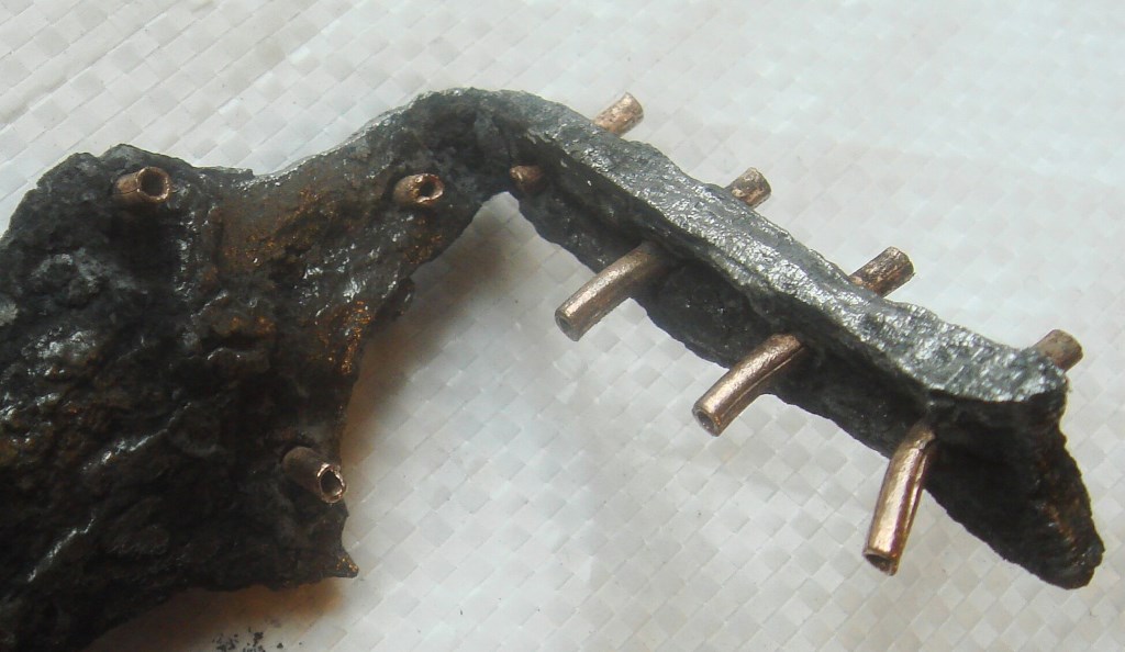

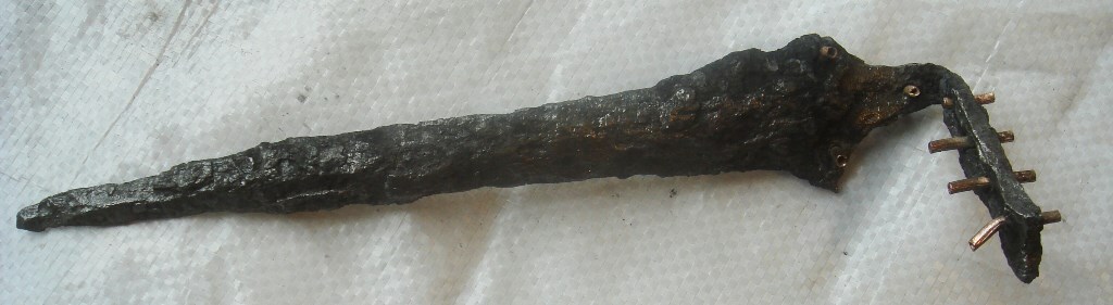

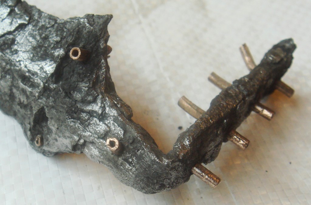

Antenna Dagger c.1400
Unfortunately I have only found an excavated example, but nevertheless interesting.

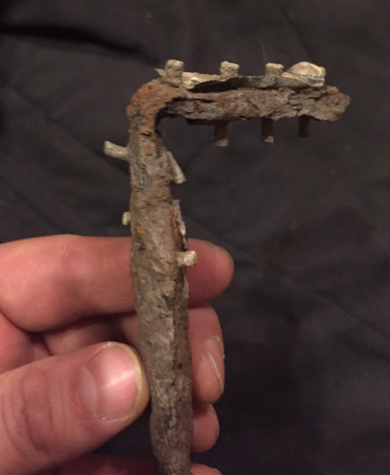

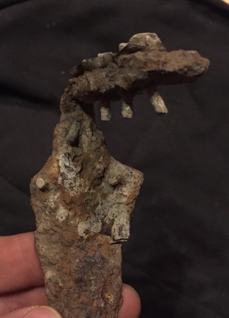

Baselard , North Italy or South Germany,14th century.
The rivets stamped with Maltese Crosses.

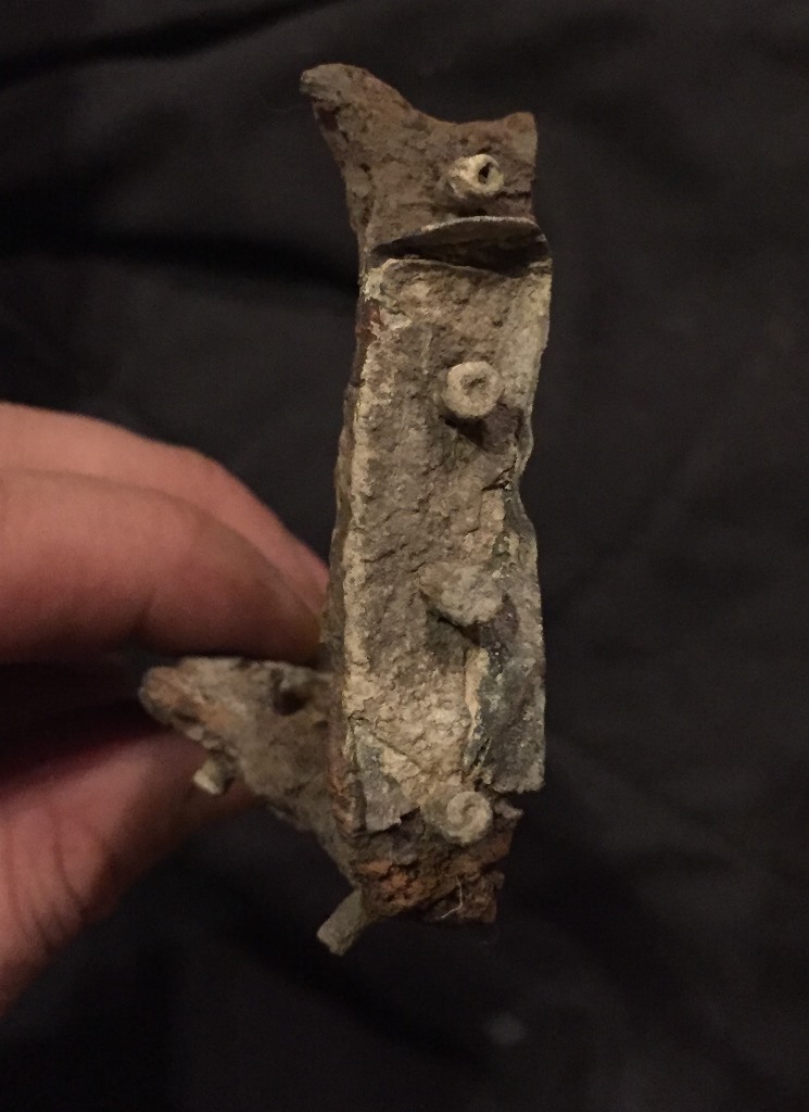

Dagger, South Germany,14th century, wrongly called 'Schweizerdolch'.
Also the two nails, which fix the grip, are most often wrongly called rivets, rivetting is a completely other method of fixing something as with a nail!
