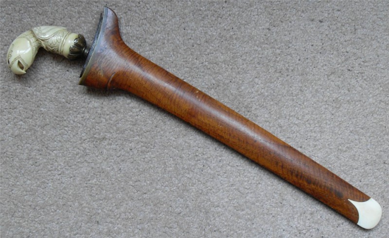

You are most probably wright, David. The edges on greneng and kembang kacang are not really worn; this keris never needed resharpening, becouse it's probably very near to the original condition. What was my point, is the possibility of a visible file work on a non-Madura piece.
I ask me, if the sheath of the "initial" keris, if it's something older, would be not to small for any sundang at the mouth (maybe not for a sundang patrem ), the keris in it should be not to large (32,3 cm length from Ebay description).
Of course the sheath could be reshaped at the mouth and shortened (it would be the answer for the possibly new buntut), and this must leave signs. Are they visible on this sheath?
I suppose, it would be less complicated to make a new sheath then recarve a sundang sheath to this size.

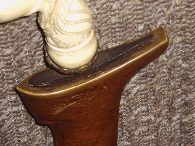

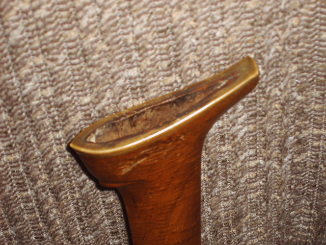

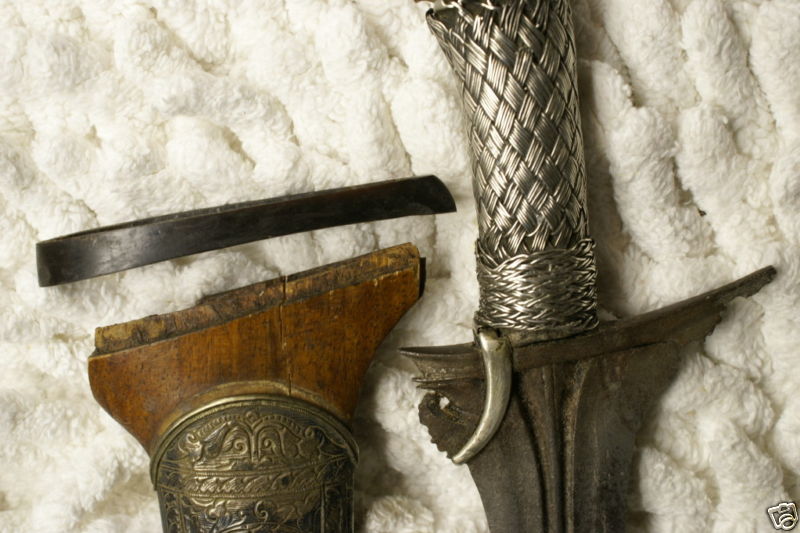

The horn strip at the mouth of the scabbard is a commonly seen occurrence for Malay sundangs in the 'sandang walikat' sheaths.

You've given some valuable information here Kai Wee.
Until I read your post I had a somewhat different idea regarding the horn strip at a scabbard's mouth.
I have not seen nearly as many Malay sundangs as you would have seen, but I have seen more than a few.
I have never seen this horn strip at the mouth of a sundang scabbard.
All the Malay sundangs I have seen have been very old, and most have been in the collection of one old time collector.
I've come across the horn strip a few times, and invariably it has been an addition that permitted a blade to be fitted neatly to a scabbard that had not been made specifically for it.
In all the cases I have seen, that horn strip was fitted with a modern adhesive. That adhesive appeared to be two part epoxy resin in most cases, but I have also seen what appeared to be a super glue, probably Alteco, and what appeared to be a modern wood glue, PVA.
I have never seen a horn strip attached with the traditional fish based glue that was used in SE Asia, nor with shellac, nor with a natural resin, damar.
So, when you tell us that this horn strip often appears at the mouth of a sundang scabbard, do you mean that you have seen it on old, obviously original scabbards, or is it something that is frequently done in modern times to achieve a neat fit, as is the case with keris scabbards for normal sized keris?
If you have seen it used on old, obviously original scabbards, have you been able to identify the adhesive, and method of attachment that was used?
It occurs to me that if this was an old-time practice used for ornamentation, rather than for concealment of an ill-fitting scabbard mouth, a bond with fish glue could be obtained by inletting tongues carved to the base of a thick piece of horn, and these tongues let into the top of the wrongko. If this was done, we could expect to see some old scabbards where the horn strip has been lost, exposing the hole for the tongue. I've never seen this, but you may have, and if you have, this would verify that this horn strip addition did exist prior to the advent of moderrn adhesives.

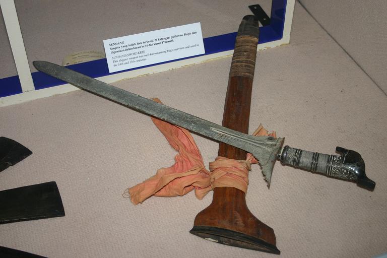

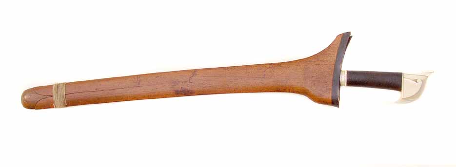

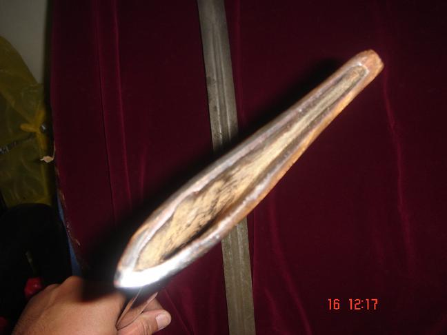

I dont know much about this, but i had attached pictures of a sundang that i used to have- with a sandang walikat sheath. The mouth have horn fittings that seems to be is original. The sheath is made from one piece drilled wood. The tip of the scabbard is horn, but is a bit damaged. I added the thread bindings to cover the defect. Everything appears to be more or less reasonably old. How old, i'm not sure.
The sheath is very slim fitting to the blade as opposed to the newer version where the tukangs will normally make it thicker to probably to reduce the risk of puncturing the wood. I didn't check the type of glue used on this particular sheath.
Many of the sundangs i've seen here in Malaysia have this sort of sheath. But, my guess is the style is not very old. The hilt and the silverwork of this particular one is a replacement as the original one is badly damaged.

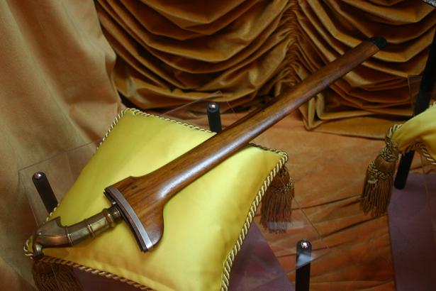

The second picture that i attached is a sundang in the KL Museum of Natural History. The third one is from the same museum, but appears to have a newer sheath.
In many "reconditoned" bugis keris sheath, the addition of a strip of horn to the sheath mouth is definitely to hide the refitting of the blade to a different sheath, but in the case of the sundang, i would presume that the addition of horn to the sheath mouth is to reinforce it since sena is too soft to be shaped as a sheath mouth properly. However, i cant say when this practice started.

IMHO, Gustav's keris blade is recent Maduran made dressed in antique hulu, and repaired sheath - classic case of a seller meant to jack up his commodity. David's blade also look quite recent, I think peninsula made and aged less than 50 yrs.... but then its only an opinion....

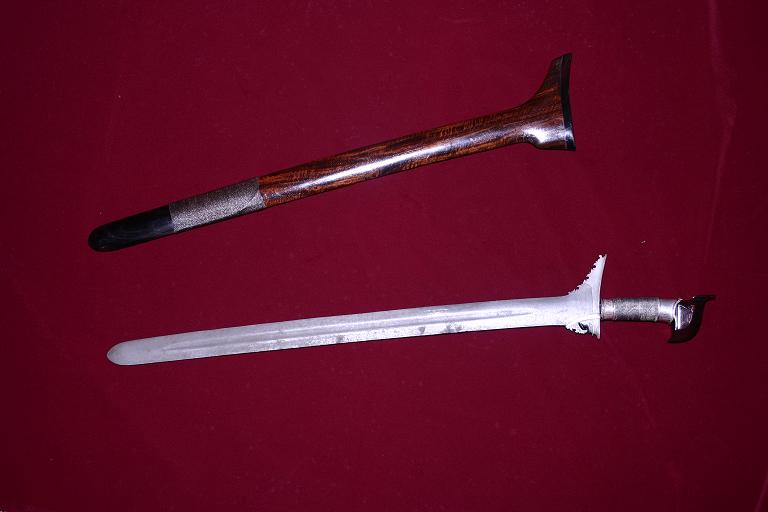

All the Malay sundangs I have seen that came in sandang walikat sheaths (the other alternative sheath type for Malay sundang is the more regular rectanglar sampir sheath type) had the horn strip. They come from all sorts of sources, some auction house, some internet websites, ebay, and in person.
I do not examine by what method the horn strips are attached to the sheath, but they mostly look aesthetically complete (i.e. not added on as an afterthought).
I was looking through my archives of photos and managed to pull out 2 examples.

I have never seen a Malay sundang in sandang walikat sheath without the horn strip. Are you able to provide pictures of one such specimen? (More examples would of course be better).

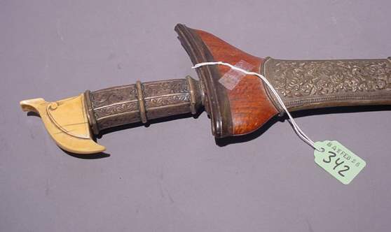

Oh forgetful me!!! How could I forget the recent sundang that went on ebay that was helpfully 'deconstructed' by age.
I was interested in this piece until irrational bidding took over and I gave up.

Kai Wee, to answer your question on whether I can supply a photo of a sundang that is in sandang walikat (SW) scabbard without the horn strip.
No, I cannot, as I do not own one. I know of several in somebody else's collection, but this gentleman has always refused permission to photograph anything in his collection --- I hate to think what the response might be if I asked for permission to publish a photo on the internet.
However, there is a photo of a sundang together with its SW scabbard in Gardner.This scabbard appears not to have the horn strip.
But further discussion on this matter is probably unnecessary, as the exploded photo has answered my question completely, and the answer is that the horn strip is not a horn strip, it is a horn collar, and using that technique of jointing as shown in post 42, fixing with fish glue would be possible.
So I believe that we have established conclusively that the use of a horn collar on Malay sandang walikat scabbards used for sundang was possible prior to the advent of modern adhesives.
Of course, it would be very nice to get confirmation in some form that this collar was actually used prior to WWII.
We've diverged quite considerably from the original direction of enquiry here, but this direction we are headed in is of some interest, so I'm going to continue down this track for a little while, not to offer answers , but to raise questions that people who are closer to, and have greater interest in sundangs than I do, might like to pursue.
Stone and Gardner are the two earliest writers I can think of who mention Malay sundang (sondang). Clifford also mentions sundang, but I don't think I've got a copy of the paper concerned, and I am uncertain if there are illustrations.
Both Stone and Gardner seem not to differentiate between the sundang and the Moro keris. Speaking for myself, and not being expert in this field, I can see very little difference between the two, yes, some differences in dress, but essentially the same blade.
In Stone a page of "Moro keris" is shown. I cannot guess how many, if any, are Malay --- maybe none, as Stone gives specific locations of origin, but many of the weapons illustrated do not have scabbards.
In Gardner there is one sundang illustrated, and that has a sandang walikat scabbard that appears not to have the horn collar.
I do have one other reference that might be useful. I have quite a lot of UK dealers catalogues that cover the period 1955 to about 1990. In these catalogues there are a number of sundang/Moro keris shown. The vast bulk of these weapons are without scabbards. Where a scabbard is present it is not a SW.
This absence of scabbards for sundang/Moro keris seems to bear out something I read somewhere --- people with an interest in this field can possibly advise of the source. It went something like this:- "Moro keris are mostly found without the scabbard because the scabbards were discarded during combat".
Possibly a similar thing occurred with the Malay sundang?
Possibly most of, if not all scabbards that we currently see on Moro keris and sundangs are relatively recent replacements? Say, within the last 80 to 100 years?
Now I want to return to the core question:-

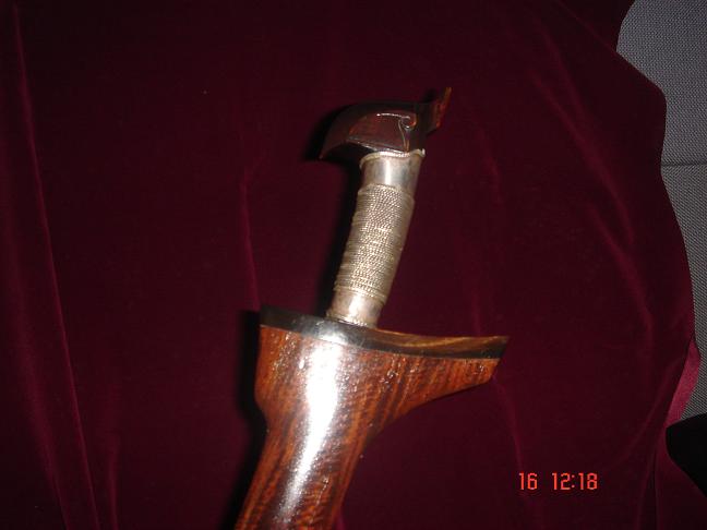

is the scabbard for the keris shown in post #1 of this thread original to the blade, or is it an old scabbard that has been adapted for use with a more recent blade?
Based upon what I can see in the photographs, and upon what I have seen in physical examples, it was my opinion that the replacement buntut, and the horn strip at the mouth of this scabbard were certain indicators that this was a scabbard that had been altered to accept a blade other than the one for which it was made.
Dave Henkel has stated that he has never seen a keris of normal size fitted with this type of scabbard.
Nobody else has come forward and advised of the existence of any other examples of this type of scabbard fitted to a normal size keris.
This keris in this SW scabbard is clearly an anomaly.
In my experience, where we find a keris that is a "one off" , or that deviates from the norm in any way, that keris needs to be looked at with the deepest suspicion. We should never forget that keris of all types come from very traditional, very hierarchically structured societies. In these societies people avoid variation from the norm.
Based upon the foregoing, I believe that at this point, the weight of evidence is heavily in favour of the scabbard shown post #1 of this thread being a scabbard that has been altered to accept a blade other than the one for which it was made.
I would be prepared to retreat from this opinion if we could establish that the horn "strip" shown in the photograph is not a horn strip, but in fact is a horn collar, and the mouth of the scabbard is an adequate fit to the blade, further, that the scabbard has not been shortened and this shortening covered with a buntut.
Regretably we are working from photographs, and the evidence that we need to establish the authenticity of this scabbard cannot be obtained --- unless this keris fell into the hands of one of our members, in which case we can have a complete and detailed examination carried out, and I might be able to reverse my opinion.

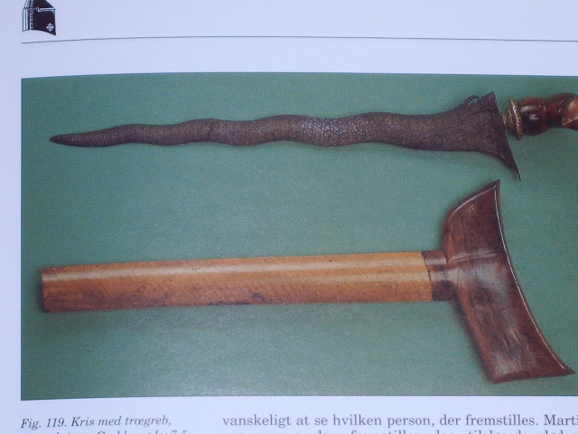

A peninsular blade with similar kind of topographic pamor is depicted in "Den Indonesiske kris" by Karsten Sejr Jensen, on page 181 (and on page 201 a sundang in sandang walikat sheath with horn buntut and sheath mouth).
(I think it is for certain now, blades with topographic pamor are occuring not only in Madura.)
Yup... this one is certainly northern peninsula, but your earlier example was recent though no body can really be sure its so called maduran's origin....

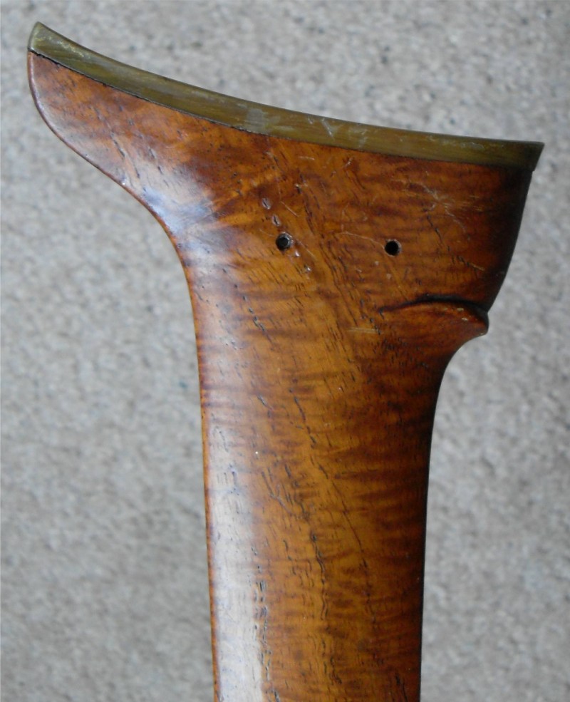

Well, the keris finally arrived. Both hilt and buntut have a fine patina, which stays absolutely hidden if you try to pfotograph it. The wood of the sheath is old, has a beautiful grain, old is also the horn collar. In my oppinion, when I see this keris in my hand, there are no new or recent parts in this ensemble.
The photographs from the seller are very good indeed, so only the missing view - the mouth of the sheath.

Old 22nd March 2010, 11:55 PM   #53
See I correct that the horn collar is set in up of the sheat and enfolded the wood? So the blade sitting in the wood?
Old 23rd March 2010, 09:22 AM   #54
Gustav
Join Date: Jun 2009
Posts: 1,346
Yes, it's wright.
Old 23rd March 2010, 12:31 PM   #55
Posts: 7,232
In my post #6 I said this:-
As always when looking at pics, I could be wrong --- but overall I don't think I am.
These most recent images posted by Gustav provide an entirely different perspective.
What I have said in previous posts is incorrect.
I was wrong.
I think this underlines what I have frequently said, that it is very difficult to appraise a keris from photographs, especially photographs on a computer screen.
It also underlines just how important it is to see the top of the ganja.
I no longer believe that this keris was made in Madura, but there are most definitely elements of Madura craftsmanship inherrent in this blade. How they got there is anybody's guess.
