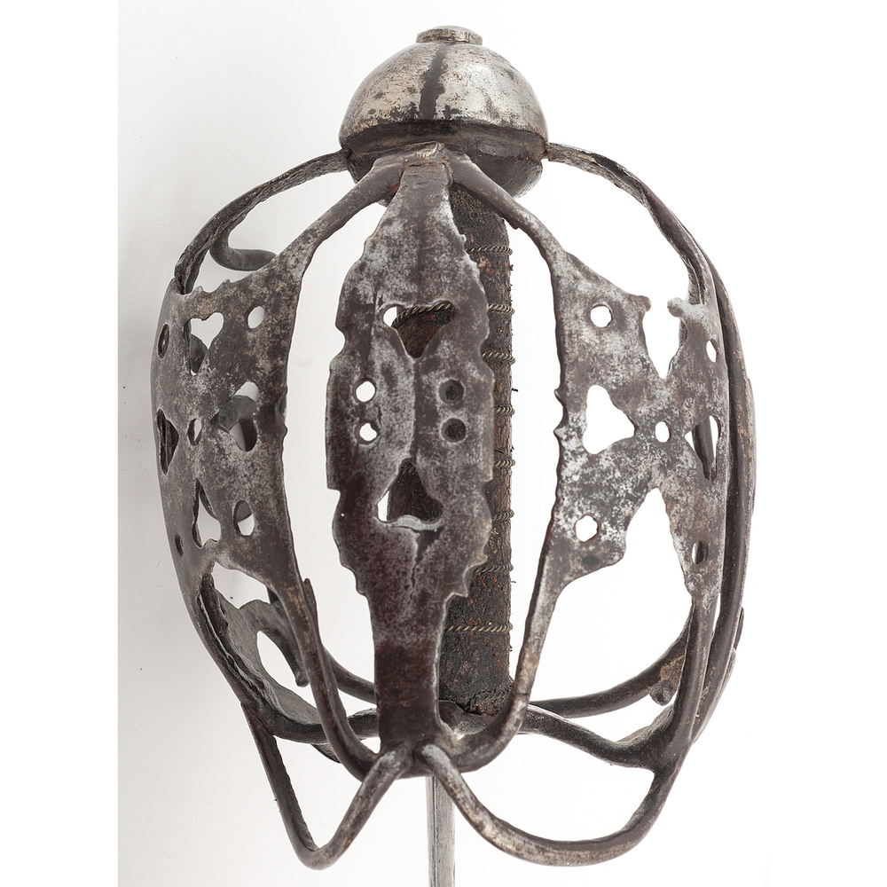

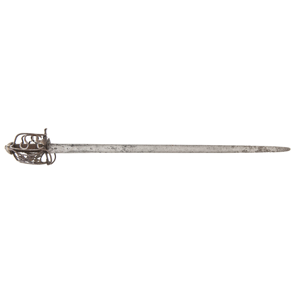

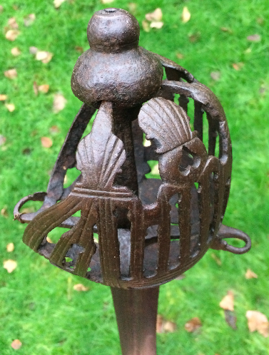

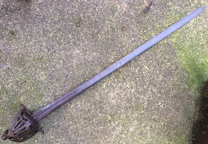

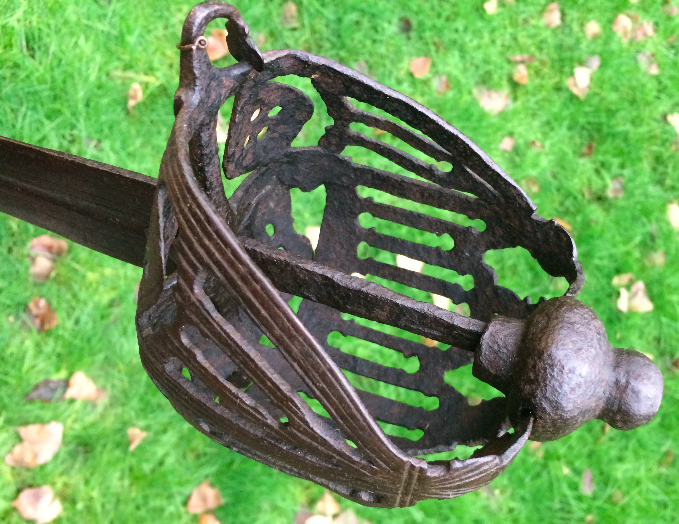

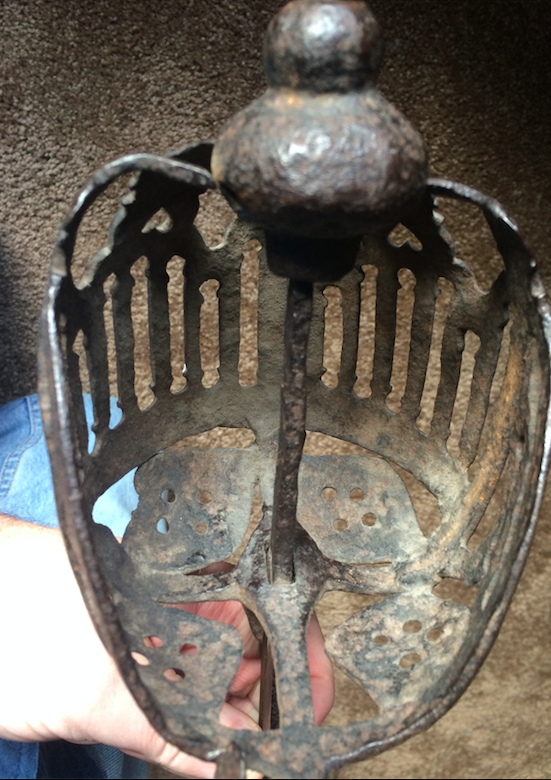

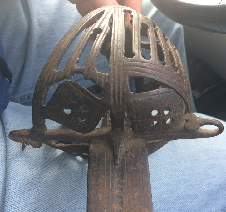

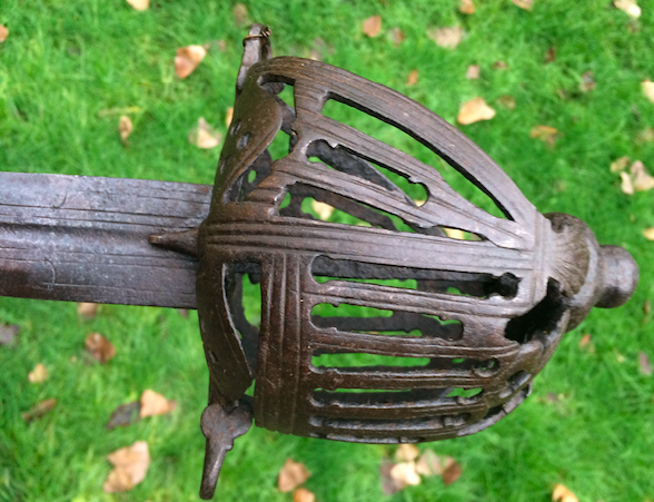

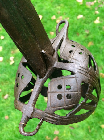

Now for a basket hilt to start this thread:
Date Circa 1540 - 1560 (16th-17th Century)
Nationality British
Over Length Overall 36 ¼ “(87.6 cm)
Blade length blade 32” (81.6 cm)
Hilt widest point The hilt is 6 ¼ “(16 cm).
Description BASKET HILT British backsword. Three segments of the guard (each comprised of three vertical bars) are linked by two small junction plates. The upper tips insert into the large, hollow Spherical pommel. The holes into which they insert have been enlarged to allow restoration of the grip and tang button. The grip is a replacement as is the tang. The thin single edged blade is contemporary with the hilt.
General Remarks
This sword was also used by Scots in the English Civil War. A similar example was excavated on the site of Basing House which was destroyed in 1645 and another recovered from under the Mary Rose in 1545.
The Baron of Earshall has requested pictures of this sword for his book and believes it to be English c.1540-50.

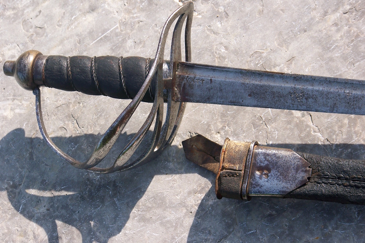

Old 31st January 2010, 04:50 AM   #2
laEspadaAncha
Posts: 608
Hi Cathey,
Nice sword, and great thread!

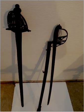

I swear your thread gives me a sense of deja vu - if the date you had joined wasn't this last October, I'd be certain I had seen this thread a couple years ago. Anyway, as I had just today tracked down a couple pictures of my own to send to someone here, I'll happily share my own (and lone!) example:
Scottish Basket Hilted Broadsword
Marked to 42nd Regiment of Foot (Black Watch)
Date: ca. 1790-1800
OAL: (approx.) 38 1/2 inches
Blade length: (approx.) inches 32 3/8

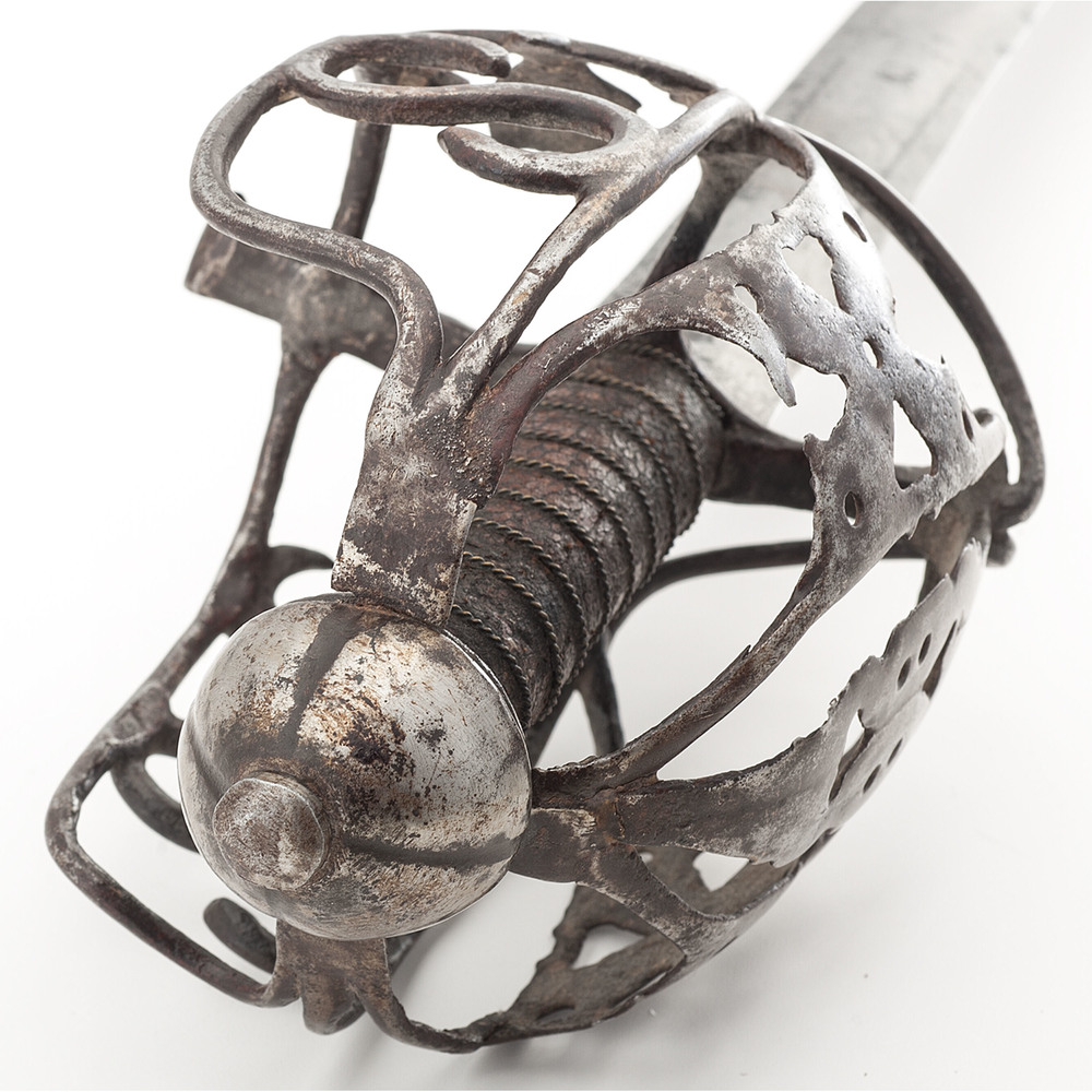

Time to post another one
Type of Weapon BASKET-HILT
Date Circa 1714-1750 (18th Century)
Nationality English/Scottish Grenadier Company
Over Length Overall 101.5 cm
Blade length blade 87cm
Blade widest point Width 4cm at widest point near hilt.
Marks, etc Mark on Sword blade, possibly German trade mark.
Description BASKET-HILT English-Scottish 1714-1750 Brass hilted backsword, makers mark and British broad arrow signifying government property on both sides of blade. English Dragoon, plain tapering single edged blade. The open “S” design was adopted for brass-hilted horseman’s swords. This one has a three-quarter basket and a modified ovoid pommel. The quillon is omitted, but the counter guard’s bar bend out on both corners to protect the hand in that area. Its straight single edged blade has a 23.5 cm false edge and a 64 cm fuller.
General Remarks
Note: In the lately discovered regimental History of the Queens Own Hussars (7th Light dragoons) by C.R.B. Barrett and published in tow volumes in 1914, this type of sword is stated to have been used by that regiment, but at a date no later than 1714.
Cheers Cathey

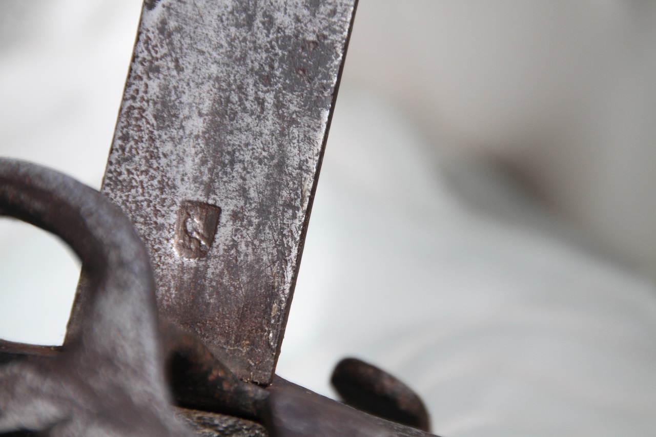

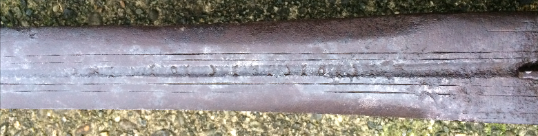

Old 12th April 2015, 08:48 PM   #10
Posts: 10,872

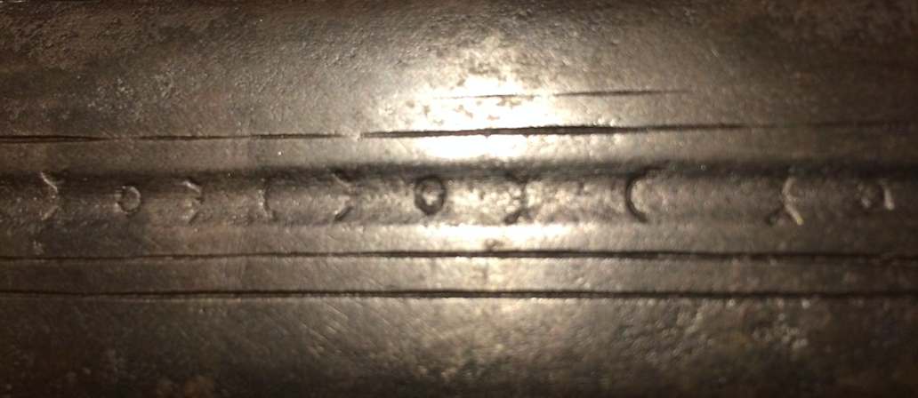

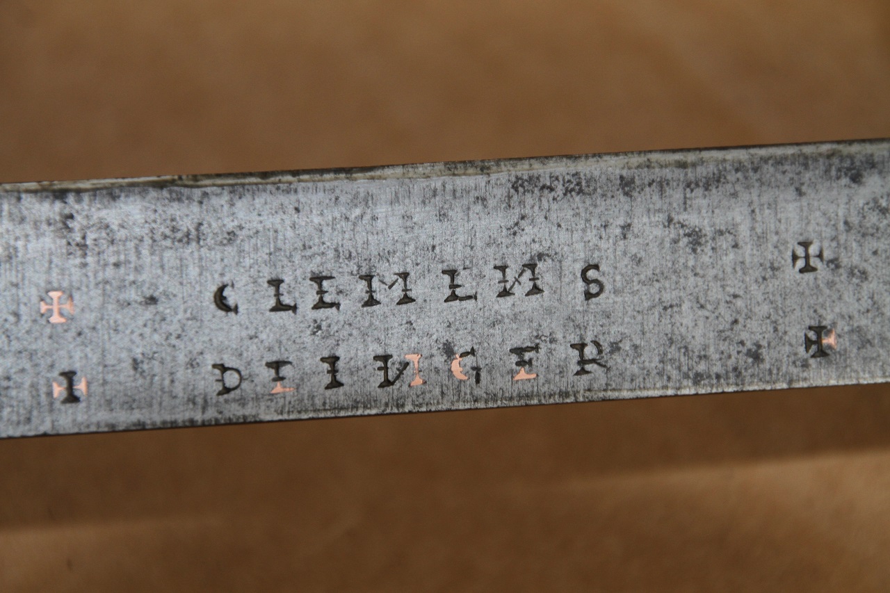

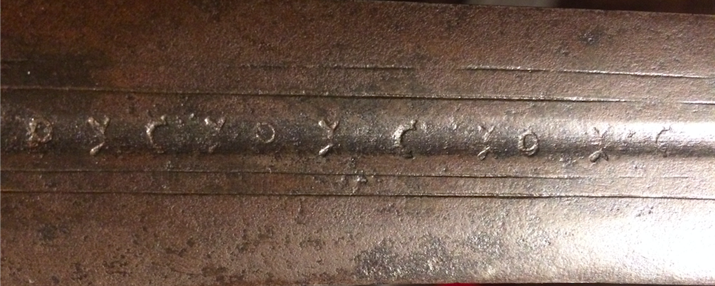

Default Blades Found in Scottish Basket Hilts
In this particular example, the hilt is in my opinion of the time period estimated 1690-1710, and a magnificent Stirling example. The blade is also of course of German manufacture, and probably indeed of that period. It seems these elliptical central fuller forms are also found in schiavona of this period in a number of cases, and I would note many of these blades also found later use in North Africa in the kaskara.
I would like to point out the inscription 1*5*1*5 , and note that this is of course not a date. These are gemetrically applied number combinations which were used, often with talismanically oriented motif and inscriptions.
It is suggested in Wagner (1967, p76) that these were often used by certain makers in particular, and notes that '1515' is recorded as used by the Solingen smith Mathias Wundes, of that long standing family there.
However, Mathias worked 1750-1784.
From: "Die Klingenmarke 1414(1441) and Related Numerical Signs"
Dr. Walter Rose
Zeitschrifte fur Historiche Waffen und Kostumkunde
Vol.14, XIV, pp.131-133, 1935-36
It seems that this inscription is indeed of the style in which such numbers were applied in this magical or occult sense, as described as well by Blackmore (1971), Aylward (1945) and Mann (1962) . What is curious are the numbers in which the ones are without serif, and the fives are rather in script with scrolled flourish, done in the style of 18th century magical motif of the 18th century.
Since the hilt on this sword is clearly of 1690-1710, and though the blade also seems of this period, would we necessarily adhere to the singularly noted reference to this number used by Mathias Wundes?
The Rose reference (cited by these later writers) is the only one specifying this maker to this number. Aylward (1945, p.104) states these numbers do not appear to have been the monopoly of any one maker.
That I tend to agree with, however, it is clear that the practice of applying these numbers in that magical connotation continued through the 18th century. I would be inclined to think this blade is of the period suggested but address the numbers and their peculiarities simply in exercise here.
I wanted to point out this significance here, and invite other examples and observations to these kinds of inscriptions found on these amazing hilts from Scotland and Great Britain.

While we have begun discussion on the use of crescent moons marking blades prompted by the present and outstanding thread on Scottish basket hilts, it seems other details pertaining to blades are apparent.
In accord with most references on Scottish basket hilts, as often with works focused on hilts, the subject of blades is typically avoided. Other authors have chosen to avoid discussions of these due to the wide variation of forms from trade and otherwise obtained blades.
I wish to offer some notes here pertaining to some examples of blades occurring on basket hilt examples so as to avoid detracting from discussion toward the hilts of these on the other thread.
Dr. Walter Rose
Salaams Jim...This is indeed interesting (I dive into library to study again your blade marks registry) ...and the detail on the blades must be considered along with the hilts.
These magic numbers I am more familiar with in the Islamic blade forms and it is fascinating to see the detail appear on European Swords and could they in fact be related to this ~ In ancient times, the pentacle was revered as a symbol of life, the five classical elements of Earth, Air, Fire and Water , joined with Spirit to create life. Wearing the pentagram was and is viewed as protection and as a talisman of divine life and good health..The figure 5 is a lucky number in many different parts of the world thus I point to the possibility of this ....note that the figure one is also interesting and perhaps related to the act of drawing a pentagram where the pen only needs to touch the paper once to inscribe all the sides of the 5 pointed star in the circle....and each number is interspersed with a star...albeit 8 lines but perhaps it is representative only...and of course the pentagon is a giver of life as well as a destroyer...thus the sword.
