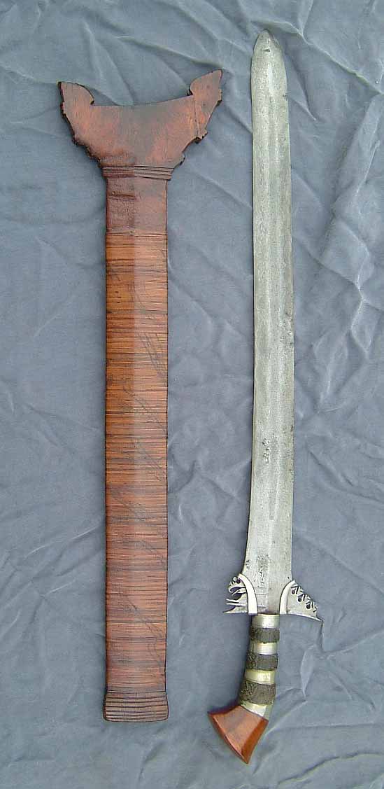

But what I am writing to ask regards the tribal and (specific) geographical affiliation of the two kris'. One of these will be added to my collection. I would like to be able to make the best informed decision possible - that is where my respect for the body of knowledge inherent to the member base of this forum comes into play.
The first of the two, and the one I am intuitively inclined to keep, is in the better condition of the two. Its blade measured approximately 19 15/16 inches in length; the hilt measures an additional 4 3/8 inches (OAL slightly over 24 inches). The blade tapers evenly from approx. 1 13/16 inches at the first luk to 1 1/4 inches at the last. Similarly, the blade has a(n umeasured) distal taper from the gangya (which measures approx. 5 inches in width and is a separate and distinct piece from the blade) to the tip. The hilt is mounted in ivory with chased cylindrical brass ferules both top and bottom. There is another chased (copper?) ring that matches the stirrup above the brass ferule.
I will include photos of the other two items in question in successive posts once I return in a couple hours. Photos of the first kris to immediately follow:
As always, I greatly and humbly appreciate any and all knowledge the members here may have to share with me, and thank you in advance for the same. I have to run, but will be eagerly revisiting this thread this afternoon in anticipation of your feedback.

A NICE COLLECTION AND A GREAT STORY.
THE KRIS YOU HAVE CHOSEN HAS A NON TRADITIONAL HANDLE THAT IS NOT AS OLD AS THE BLADE. THE GRIP APPEARS TO BE BONE OR PERHAPS DEER ANTLER NOT IVORY. CLOSER PICTURES OF THE GRIP AND METAL WORK ON THE HANDLE WILL HELP FOR EXACT INFO. THE HANDLE AND BACA BACA STRAP ARE A MORE RECENT UP GRADE AND THE STATUS CAN BE DETERMINED BY THE MATERIALS USED. HIGH STATUS GOLD OR SWASSA, SILVER AND IVORY. LOWER STATUS AND MOSTLY FOR FLASHY LOOKS BONE, ANTLER, COPPER, BRASS. A CLOSE UP OF THE GANJA AREA OF THE BLADE WILL ALSO HELP THE EXPERTS MAKE ACCURATE OBSERVATIONS.
PERHPAS SOME PICTURES OF THE OTHER KRIS WHICH APPEARS TO BE A GOOD OLD USED TRADITIONAL WEAPON WILL GIVE YOU THE INFORMATION TO HELP YOU MAKE THE BEST DECISION.
I LOOK FORWARD TO SEEING THE PICTURES OF THE TWO HEAD AXS AND THE KRIS.

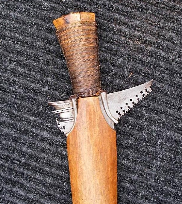

In the meantime, I have included photos of the second kris in this post.
The second kris has seen better days. However, as there was little active rust or corrosion when I took delivery of these and they were for the most part stabilized, I am of the opinion the deterioration of the blade had taken place some time ago, long before I took possession of it (though how long ago I do not know). The blade of this kris measures approx. 21 3/8 inches in length, with an OAL of 27 inches. Unlike the other example, the gangya (sp? ganja?), which measures approx. 4 inches across, is integrated into the blade. There no readily apparent distal taper that runs the length of the blade as there is with the first example. The blade does appear to taper in width, though not as much as the other; furthermore, the deterioration and blade loss makes such a measurement (at least to any degree of accuracy) unreliable IMO. The hilt treatment is obviously different and far less ornate. It is also somewhat lighter than the other kris.

Congratulations on this collection! All the pieces so far are WWII. You are right in that the head axes are Kalinga.
Vandoo accurately identified the first kris as bone or stag. The blade is older than WWII (perhaps turn of the century) and looks to be Maranao. The baka-baka clamp and one fitting is copper and the others brass - all later to the blade. The band on the scabbard (also made later) is aluminum and is missing the bottom band.
The last kris is more recent - perhaps 1940s? It looks to be Sulu in origin.
Hope this helps.

I agree with Vandoo. It looks like both blades were treated with a powerful cleaner to remove rust. The first blade appears older but as Vandoo mentioned the fittings are new. It looks like someone used lost wax casting using a copper alloy for the stirrup.
The second blade is mid 20thC & a lot of those blades were made with recycled steel, this one had a lot of deep rust, leaving the major pits. The scabbard once had MOP or turtle shell, now missing.

Okay - here are some close-up photos of the ganjas of each kris. The first picture shows the ferule and grip of the first kris. You can see in this photo where the surface patina had been removed from the metal. Due to the verde patina, I presume the top-most ring is copper.
I am looking forward to hearing if these photos further validate the previous attribution and age estimation.
In previewing my post before submitting it, I noticed Bill's input, and thank you for the same... I, too, had the distinct impression they had been overcleaned, though I believe said cleaning was performed b the late Col., not his daughter (for reasons mentioned above). In treating for the light surface rust present when I picked them up, I used the good 'ol standard of 3-in-1 and #0000, with just enough work to remove any active rust.
So which one would you guys keep, and why?

A VERY DIFFICULT CHOICE ONE KERIS HAS THE SUPERIOR, OLDER BLADE AND IS IN BETTER CONDITION, BUT A HANDLE THAT REALLY PUTS ME OFF.
THE OTHER HAS BOTH ORIGINAL BACA BACA STRAPS AND PART OF THE WRAP AND A SCABBARD BUT THE BLADE IS IN TERRIBLE SHAPE AND LIKELY IMPOSIBLE TO RESTORE WITHOUT RUINING IT.
THE BLADE IS THE HEART OF A WEAPON FITTINGS ARE JUST CLOTHEING.
