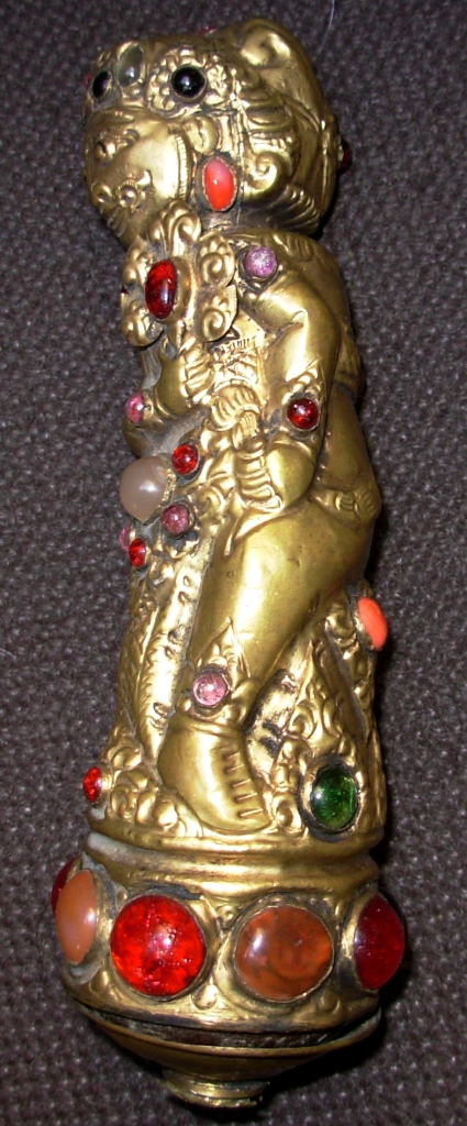

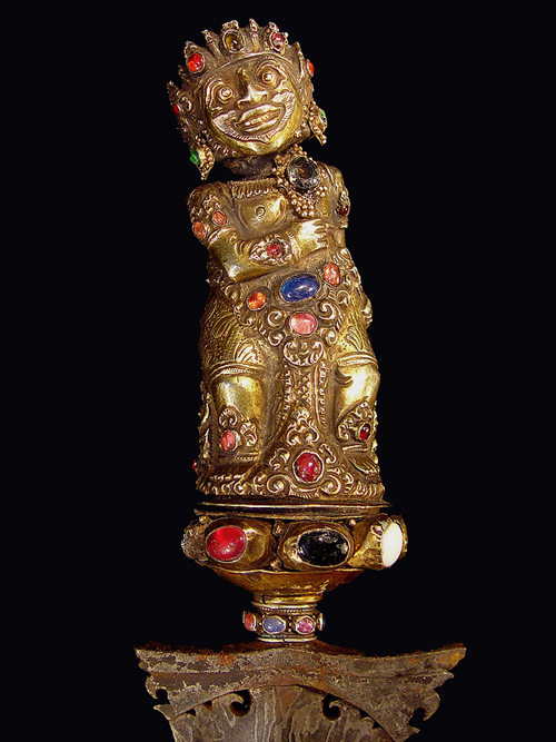

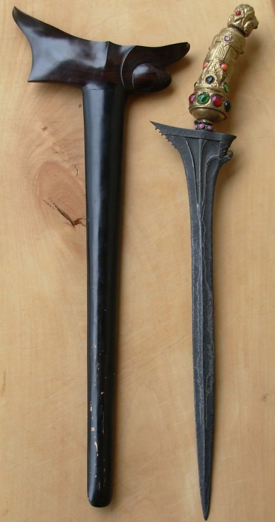

Seeking information for this wedding Bali Wedding Keris
am grateful for any information
gruss chregu

What makes this a "wedding keris" per se? Do you have provenance to that effect?

Maybe somebody wore it at a wedding?
Well that's why i asked if there was provenance of this. I could be wrong, but it doesn't seem to me that there is any particular form of dress or keris that is specifically for weddings and i just wanted to be sure that no one was getting the impression that this is what a keris used in a Balinese wedding need look like.

I've chewed the keris 3 years ago, the salesman told me that.
I bought this keris in Switzerland. from one of really should know. Martin Kerner, he's book author, keris handles from the Malay Archipelago.
I am not a specialist keris, almost everyone can tell me anything. smile.
so I'm glad to be in this forum and to hear other opinions too.
So, what think you know what kind of a keris?
gruss chregu
I am not sure what you mean exactly by this "kind" of keris. It is a fairly average Bali style keris in a form of Balinese formal dress (in regards to the sheath) which would, i suppose, make it appropriately dressed for a wedding. This sheath appears to be a fairly well carved one and looks to be of ebony and some other wood on the stem. The blade doesn not have the typical Balinese, high polished surface and stain. Could be it was restained outside of Bali or it might be from Lombok where the high polish staining was not always used. The handle looks like a somewhat low quality version of what i have heard many describe as a Bayu hilt, though i am not certain if this is actually supposed to depict Bayu (a wind god) or not. I cannot tell if it is just brass or if a god plating has been added over it, but the "stones" seem to be mostly pastes or low quality stones. I have attached an example of a higher quality version of this hilt style. This one also mixes pastes with actually stones which is not uncommon in Bali.

Sorry, I don't think that the hilt tourist made and I think that not all "stones" from glass, the orange one and the milky one on the stomach seems to be real stones and the hilt shows some wear. Of course it's a very simple hilt and the blade is also not very fine worked while the sheat is of better quality.
Maybe a composition? But this is difficult to say by pictures.
i don't think anyone is really suggesting anything different here Sajen. And again i will state that pastes can be found on very high quality Balinese dress as well as low grade like this one.

But either way, we probably cannot expect, a low quality hilt of one of the four species, made of another material then gold and ivory (and silver?) would be older then beginning of 20 Century.
I would imagine that this sheath, though of higher quality than the hilt, is still not particularly old. It too is probably mid to late 20th century.

In respect of the age of this keris, it is most often very difficult to be particularly accurate with age estimates from photos, however with this keris I am confident that the blade does pre-date WWII. As already noted, the hilt is not of particularly high quality, but I feel it may be older than it looks, and I would be inclined to place it as no later than mid-20th century; the scabbard probably dates from the same period. The wewer is probably not more than ten years old.

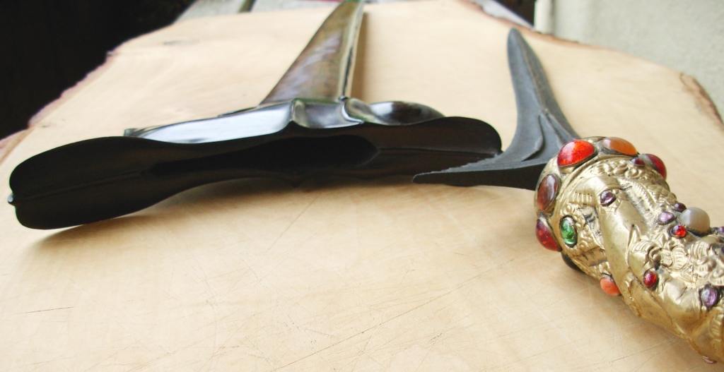

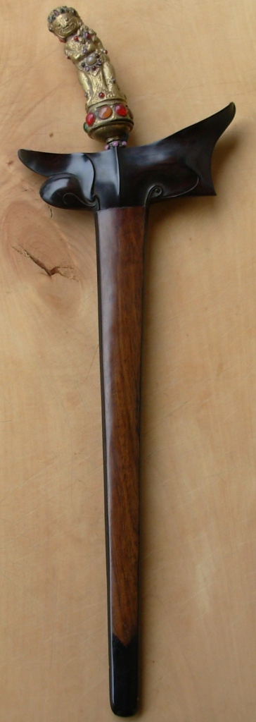

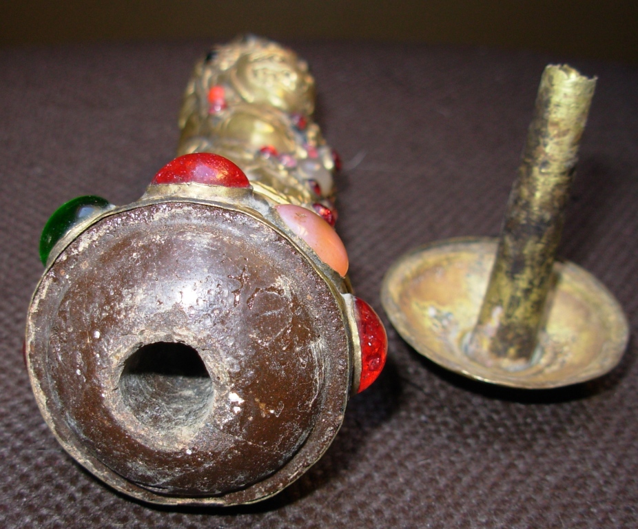

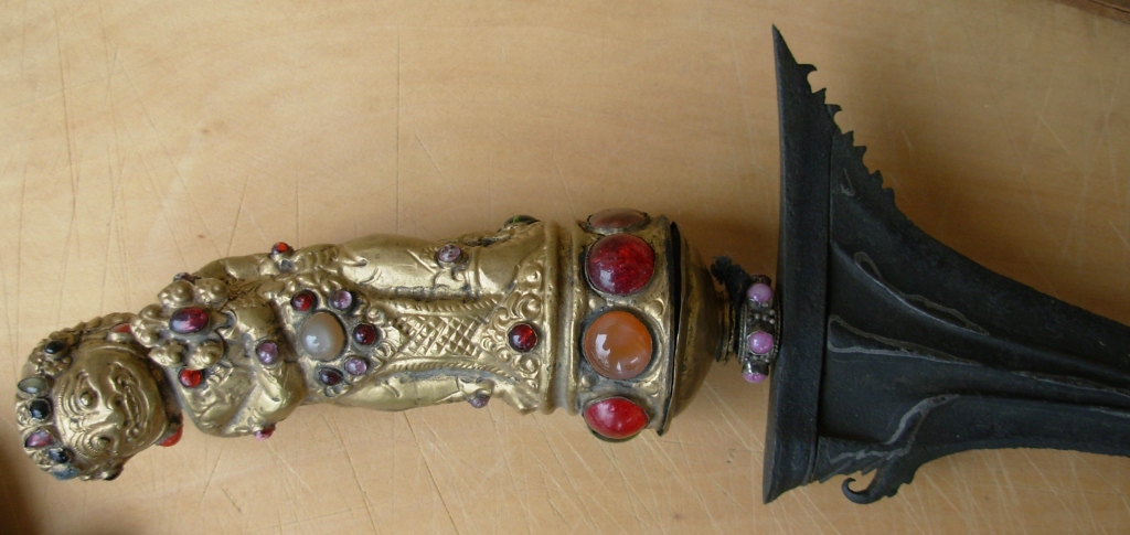

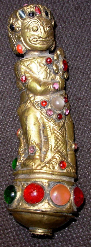

hello together
Many thanks for your efforts to help me ignorant too. smile.
you still add to that a few better pictures.
The handle is made of brass. the red, green, black and purple "stones" are made of glas
The silver-colored belly, the Orange and brown on the bottom, the orange hiter the leg and below the ear and the head is silver-colored stones are. I think.
Again, summarize the blade handle simple quality mid 20th century Bali
The Sarung good quality mid 20th century also
gruss chregu
