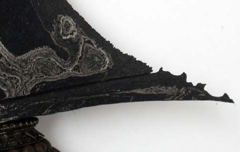

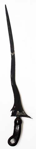

Originally Posted by kronckew
the kudi/kujang also has decorative notches on the top of the blade, on my pre-islamic one, they are well forward, over the 3 holes.
european blades frequently have decorative filework notches cut into the blade spine, scots blades are also frequently notched
could it just be that they are decorative items that have evolved into fancy forms & have become 'traditional' in some areas, adding more esoteric interpretations in later ages.
as not all kris blades have them, and some non-kris blades have them, i'd think that if they had a definite non-decorative kris specific function then all kris would have them to some extent, however they are apparently optional.
occam's razor (razors generally come without greneng )?
Your kudi looks like a fairly modern piece to me, not pre-Islamic.
Greneng is certainly much more developed than the notches found on European blades and the form does look very much like the Dha letter it is reputed to represent. It seems to me that they are much more than just decoration.
Keris were/are made on many different levels for many different classes of people and for various purposes. I don't find it surprising therefore that some keris have greneng while others do not.

It is tempting to think of the very first, original expression of the greneng as a purely ornamental device, it is difficult to argue against this, as it is obvious that to say such a thing never happened, and never could have happened we would need knowledge of every keris ever produced, prior to the widespread use of the greneng as a feature in the keris.
However, once we reach the point where we can see a distinct form in the greneng, and we see this repeated in a number of blades, irrespective of the quality of the blade, I am very reluctant to accept mere ornamentation as an explanation.Most especially so when that form can be aligned with a form existing in Javanese script.
In fact, when we consider the 16th and 17th century examples in European collections, and compare these with examples in Jawa that are supposedly from this period, and earlier periods, it seems possible that in blades where complex ricikan were used , their addition to the blade was not the product of a gradual development process, but rather all the features were added at one time, or at least within a span of time that was relatively short.
To my mind, this indicates a planned process for an intended purpose.
Yes David, the Hindu faith was present in early Jawa, but it was not the Hindu faith as practiced in its homeland. It was Jawa-Hindu, which was a syncretic form of the faith incorporating indigenous Javanese elements and a parralelism with the practice of Buddhism. Not really a particularly easy subject to come to terms with, but an understanding of what was going on in the religious sphere at this time is essential before we can begin hypothesizing in respect the keris and its features.
Let us not forget that a culture and society consists of more than just its religious beliefs. We need also to try to gain an understanding of the other elements involved .
We must not think of early Javanese society as a Hindu culture. It was not. It was Javanese culture with overlays of foriegn belief systems that had been accepted, absorbed, and altered to fit the host society.

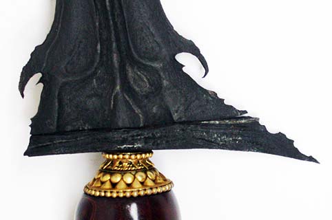

Regarding the form of the greneng.(Dr. David)
Keris from different periods carry ron dha of differing shapes, those shapes supposedly can be aligned to the form of the letter "dha" at various periods.
Keris from some areas outside Jawa, and keris of village manufacture from within Jawa very often have very approximate renditions of both greneng and ron dha.
The greneng can take a number of forms, but in a Javanese keris the various forms will always contain at least one rondha.Early keris with greneng do have similar component features expressed within the greneng, but the composition can vary from one keris to another. To give a definitive answer to this, one would really need to examine all these old European-held blades at the same time. Photos, even the very best photos, are not really good enough, in my opinion. I think that very probably it would be able to be shown that early expressions of the greneng carry very much the same features as later expressions of the greneng, however, with later Surakarta keris I feel that we begin to see some artistic improvisation that was not present in earlier periods.
