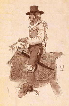

A vaquero with espada ancha worn on saddle as seen c. 1820s(first image). By 1850s, these had become shorter and more like Bowie knives so worn on the person. By later in the century saddle swords were still more the standard, so indeed there were cases of Mexican saddle mounted types into the Revolution period. However the Mexican 'rurales' of Diaz and many 'chinacos' into the Revolution wore swords in scabbard in the traditional manner.

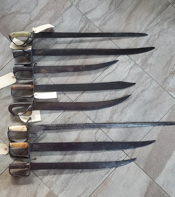

In the photos.....a vaquero of 1820s (original art by David Rickman for my article on espada anchas, 2023) the espada ancha is drawn from the 2nd from bottom in my grouping.
Espada anchas.....third from bottom with horn grip has dragoon sword blade and may have been saddle mounted, probably from Sinaloa.

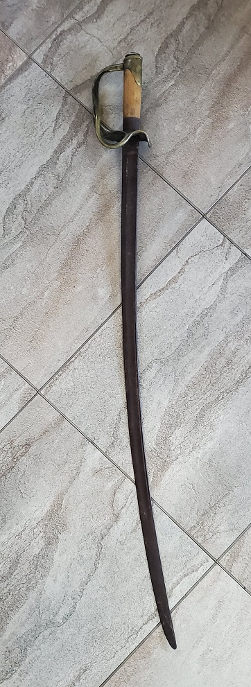

Typical 'rurales' saber c. 1880s.
