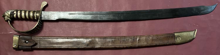

European weaponry isn't really my thing but because this Dutch klewang (ostensibly VOC) was being sold for very little, I decided to take a chance. Upon carefully examining the sword, I fear that I have been treated to what ruefully is called a learning experience. The blade is about 25.375" (64.4cm) long. The guard, ferrule, and backstrap are brass. The hilt looks like bone with a brass wire wrap but where the white "bone" has been chipped and worn away, the material is black which indicates plastic so the best I can hope for is some sort of 20 century dress sword. The sheath is brown leather sewn down the back. A loop of brass is riveted to a leather flap at the throat. The leather flap has a slit in it and is fastened to a partially intact leather band. The brass drag has been stapled to the sheath. I don't know if the staples (1 missing) are original.

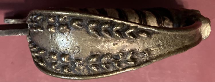

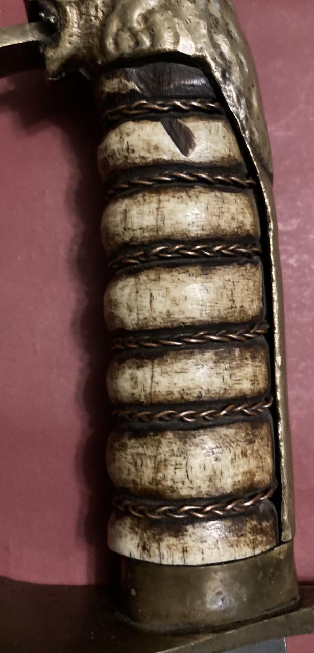

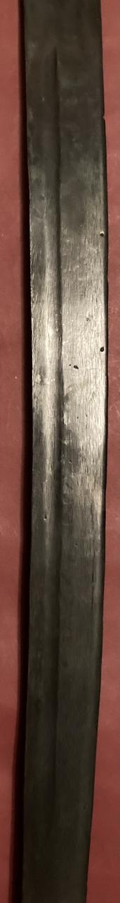

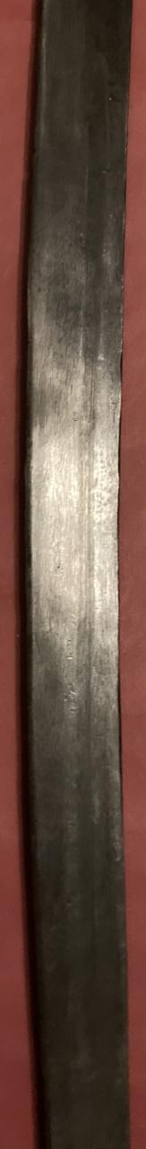

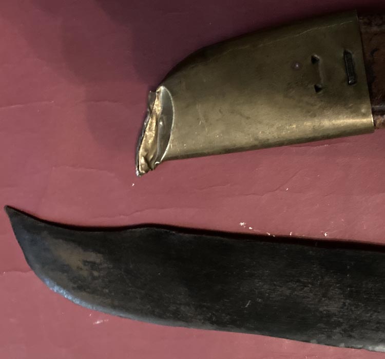

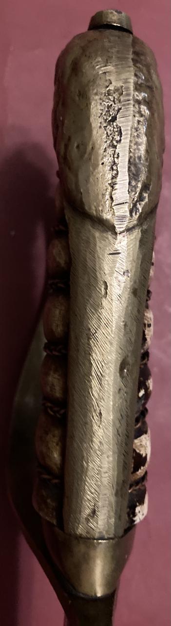

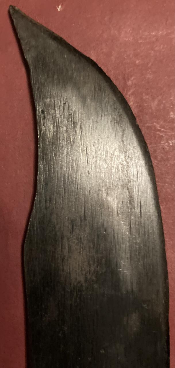

Could you show us the grip and backstrap of the hilt, the forte area of the blade, a section of the blade with the fuller, and a clearer view of the tip.

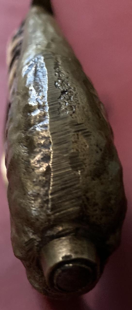

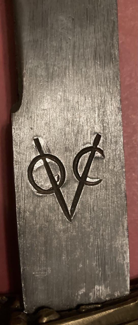

Thanks for your help on this. On closer examination, the grip wire appears to be copper not brass. I took two shots of the backstrap. One from directly overhead and the other from the back to show the through tang. I also took a shot of the fuller on each side of the blade. The second shot is the "VOC" side. That fuller appears to be less deep and cut a bit lower than the other side. I also took a shot of the forte and the tip. Hope this helps.
Sincerely,
RobT

The VOC mark is not genuine (obviously being of much too young age, anyway).

Those additional pictures confirm my initial impression.
First, and most important, is that the blade is not a true maréchausée sabel (aka, Dutch klewang). It does not conform to the Dutch pattern (or swords based on it and made elsewhere). The ricasso is too long and the clipped point is too shallow. The fullers are poorly cut and of uneven width. You may also find that the blade is shorter than the standard length.
Second, the hilt seems to be (loosely) based on a Dutch naval officer's saber (Model 1882). The gilded brass hilt on that sword has a solid D-guard with a lion's head pommel and backstrap, and a segmented bone grip with twisted wire. The hilt on your example is poorly cast and roughly finished. The backstrap shows coarse grind marks along the seam of the mold.
Adding all of this together, what you have is an Indonesian copy of a Dutch klewang blade to which has been fitted a copy of the M 1882 Naval Officer's saber hilt. Indigenous copies of Dutch swords were fairly common, especially as you have noted in Tjikeroeh, so this sword falls into a recognized genre. I think your example was made pre-WWII because it appears to have some age and that was when local copies of Dutch swords were most prevalent.
As for the VOC mark, this is clearly "fanciful" (as Kai has noted). The Dutch klewang was introduced in 1905, more than 100 years after the VOC ceased to exist (the VOC was nationalized in 1796 and abolished on December 31, 1799). Added to that the mark has been struck upside down and does not conform to standard VOC marks. Again, this is characteristic of local indigenous manufacture.
Standard VOC mark: Note the serif font and presence of wider downstrokes than upstrokes.
