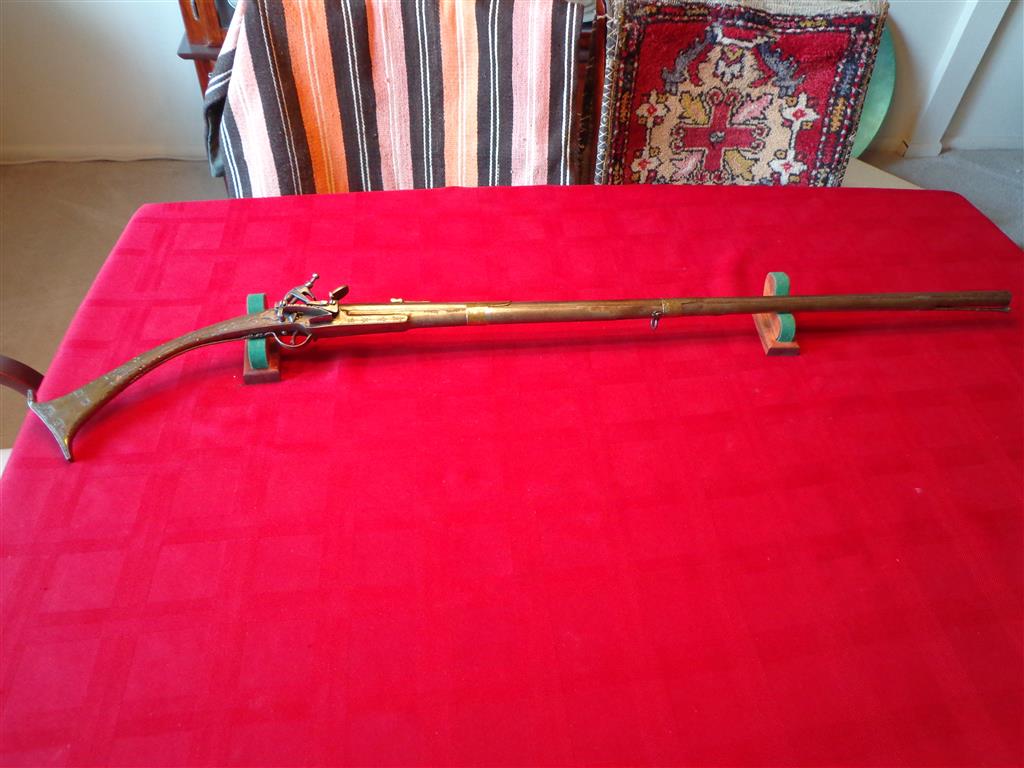

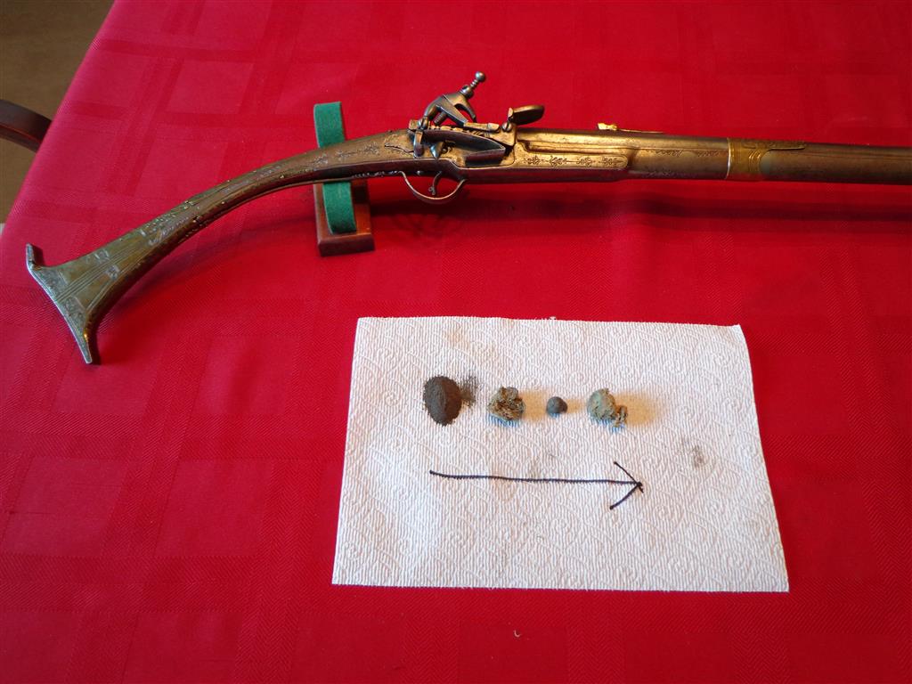

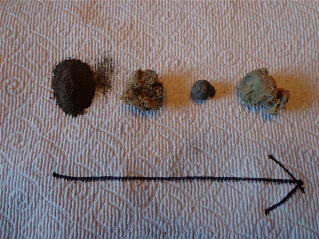

Hi David
So true. First thing I do when I get a muzzle loading gun is check and see if there is still a load in the barrel. Hard to believe that 150-200 year old powder, if kept dry, will still ignite.
In my case, I've only had one. An Albanian Tanchiks musket that was still loaded. Good thing someone didn't put priming powder in the pan to test the lock.
