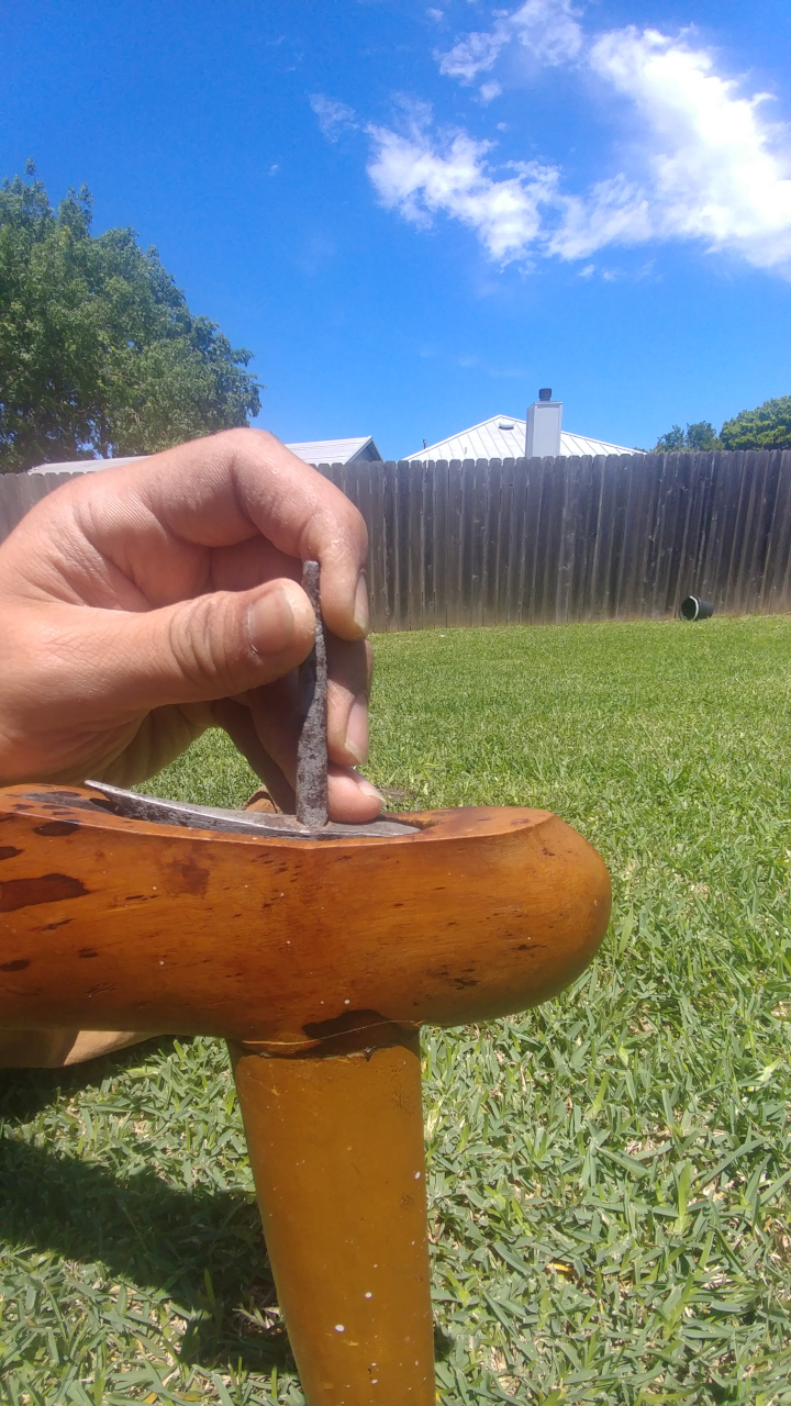

Fit:
QuisUtDeus is offline   Reply With Quote

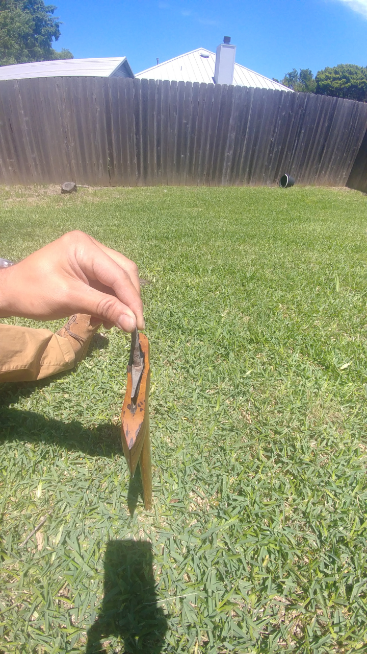

Sorry, I'm still not used to using the forum. This is how the blade fits:

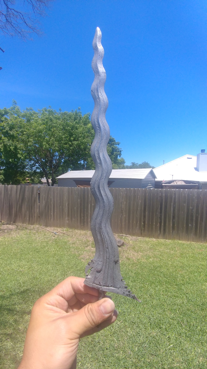

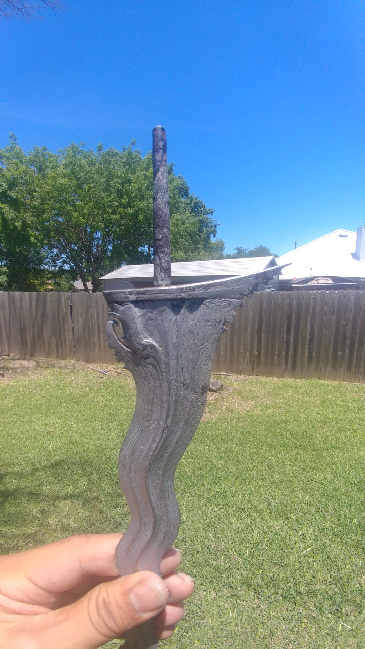

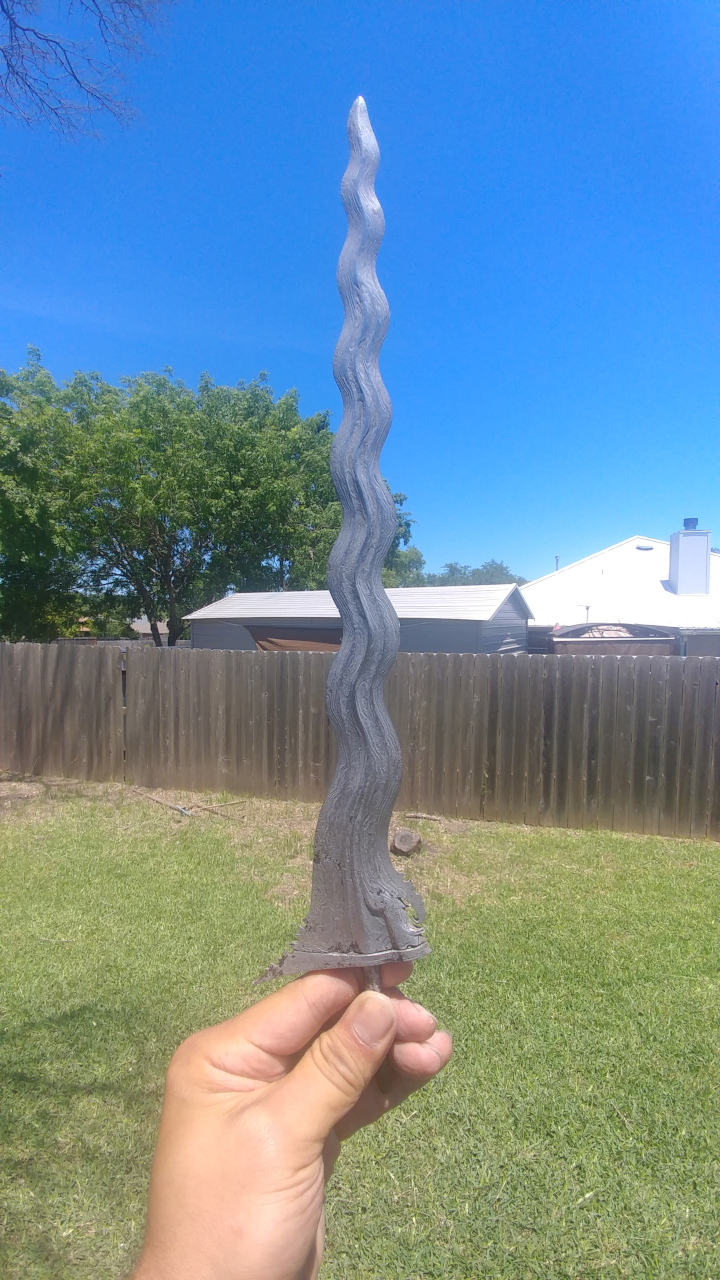

This is the blade cleaned up, for the most part:

Thanks for the additional photos. It doesn't look like you should have too much trouble adjusting the fit to this sheath.
The new photos reveal features that i hadn't quite noticed before, like the fullers that run almost 3/4 of the way up the blade. Frankly, the keris appears even less Lombok in these last shots. This isn't t say that it is not, but i feel like there are some Bugis influence working in there. Of course, that would not be completely out of character in Lombok i suppose. Anyway, certainly not a Bali blade. It does seem to be a nice keris regardless of its exact origins.

I believe that is a distinct possibility. But from where? Bugis is very moveable feast.
Old 24th May 2019, 09:34 AM   #60
Posts: 7,255
I have no problem with a Bugis influence for this keris.
The sorsoran, especially the indented gandhik and boto adeg blumbangan can be related to South Sulawesi, these features are also attributed to the Eastern Islands of the Archipelago, and the Bugis people occupied Eastern Lombok.
However, I personally do not know of Bugis keris with this very dramatic topographic treatment from South Sulawesi, or from anywhere other than Lombok.
I'd very much like to see examples of Bugis influenced keris that had this style of wilahan and that also had inarguable provenance for somewhere other than Lombok.
I know almost nothing about Bugis keris, I have never carried out research in South Sulawesi, so perhaps this style of keris can be found in South Sulawesi, or even in the Peninsula. But I do not know of examples that can illustrate this.
For me this is most likely a keris from Lombok, but most certainly we can accept Bugis influence.
