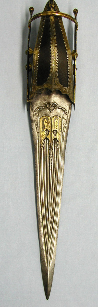

I dont have a Tooroom, and maybe what Ariel is thinking about is the one shown on p. 149 in Robert Elgood's book Hindu Arms and Ritual. I have never seen one, and it is the only time I have seen a picture of a gauntlet katar.
The hand guard on the katar shown over your last post is about 1½ mm, but made of steel, but I would estimade that it could take quite a blow without the hand holding it got hurt.
