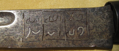

In respect of the sword that generated this thread, I have often seen this type of calligraphic ornamentation, and mock calligraphic ornamentation, on various types of Indonesian weapons. Inlay of this type has most often been done very recently with the sole purpose of increasing the commercial value of an otherwise unremarkable item. The two places where I know this "enhancement" to be carried out now and in the past are Surabaya and Jogjakarta, but it is undoubtedly done in other places also.

Michael, my remarks on calligraphic enhancement of blades is directed only at the particular type of calligraphic enhancement that we can see on this blade.
I believe most of us would be aware that it was not unusual for blades to bear other calligraphic enhancements that date from much earlier periods and which were placed on the blades for purposes other than the one I have mentioned.
However, I will make this further comment. Over the years I have often referred these blades to people I know in Solo for translation. One of these people is a very learned man who is able to read a number of different script variations. It is seldom that the inscriptions found on blades that I have personally handled are written accurately, in that sometimes the actual quotation will be wrong, at at other times the letters used to write the quotation will be formed in a way that makes a nonsense of what has been intended to be written. Sometimes the person to whom I have turned for assistance is able to guess what has been intended, at other times the opinion is that whoever put the inscription on the blade did not really know how to write and was putting on symbols that simply looked like letters to somebody who also could not read.
Therefore we need an explanation of the text by somebody.
From there we could say more about it. If somebody would use a "mock calligraphic ornamentation", I don't think it would be done so intensive and so fine as on this pedang.
If you have seen often "this type of calligraphic ornamentations" as you mentions, I would like you to post some images here for comparison if possible.
I also have images from pedangs (of other collections, and therefore not propriate to post here), of which I'm sure it's definately not as old and finely done as mine. Also it's done much more crudely, and not so intensively.
In comparison with the one in this thread, I never have seen a pedang ornamented as labour-intensive and decoratively done as this one. So I doubt it's only supposed to be a "mock calligraphy".
But this is only from my common sense and I would love to know more and it might be when we have a translation...

It seems that contrary to perhaps everybody else who has commented on this blade ornamentation, I do not find it to be particularly good. Previously I have referred to "this style" or "this type" of blade ornamentation, and by that I mean superficial applied silver ornamentation upon a very recently polished surface that has subsequently been false patinated. This type of work is most often produced by people who sell out of a particular market in Surabaya, and is also done in Jogja. The Surabaya source has been in existence for a very long time, the Jogja source for a shorter period, both have been producing since at least the 1950's.
It is rule of the trade in Jawa that when one had something that is very difficult to sell, for one reason or another, then action needs to be taken to enhance that object to make it a desirable product. This sword is badly damaged, and would be extremely difficult to find a buyer for in the Indonesian market, so it was enhanced to make it saleable. I do not know if the text on this particular sword is true text, or simply a mixture of symbols that looks like text, I can identify some characters, others seem to me like scribbles, but I am not at all qualified to give an opinion on this. However, whether it is true text, or whether it is a mockery of text, that does not alter the nature of this ornamentation, nor the reason it was done.
Maurice, you have requested that I post images of the sort of thing I am writing about.
I cannot do this. I wrote that I have seen this sort of thing, not that I possessed it. In fact I have very little interest in the various and sundry swords and daggers of Indonesia. My prime area of study is the keris, particularly of Jawa and Bali, and to a lesser degree the tombak. However, during any given year it is inevitable that I see and handle a very great number of keris, tombak, swords, daggers and other items of Indonesian material culture. I do not buy all these things, I simply look at them and buy a fraction of a percent.
Maurice, I do apologize for being brutal, but what I have written is my professional opinion, an opinion that has been formed by being a part of the Javanese keris trade for in excess of 30 years, and from being taught by a man who began dealing in keris and other traditional weapons in the late 1940's. What I am describing here has been going on since at least the late 19th century.
I know about the particular markets you're referring. I've seen their "work" for hours on the tv, as they're acquaintances of a friendcollector of mine who hang out with them a couple of times a year.
And I appreciate you're experience and it's of great value sharing it in this thread.
Concerning the pedang we're discussing here, there's a part which still has the old patina over the silverwork bedause it probably wasn't cleaned that well on that area as on the rest of the blade, as I mentioned before. And for my experiences with cleaning mandau blades with lots of silver or brass inlay, I know that I can clean it easily till the brass and silverwork shine like new, and the blade itself is showing the same patination as before, just by using a dishsoap and a scourer.
I know about embellishment of stuff which doesn't sell. But writing this sword down as badly damaged and extremely difficult to find a buyer for, sounds very strange to me. But again, everybody could have his own oppinion of collecting and I respect that in this forum!

Here's my only pedang with (limited) inlay. Just to get a bit of diversity in, not necessarily the pinnacle of quality though.

Posts: 1,637
Kai,
Your pedang has a djadwal (a talismanic table) and not Qur'anic quotes.
Have you posted it before on this forum?
If not, maybe you can start a thread about it?
Maybe it has other Banjar characteristics, too?

Hello Michael,
Yup, that's the reason why I feel more comfortable about it being genuine.
Not yet - will get some more pics and post them.
This one doesn't seem to have any obvious Banjar characteristics AFAIK. Am looking forward to more comments from you on this pedang!
