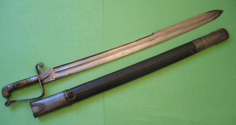

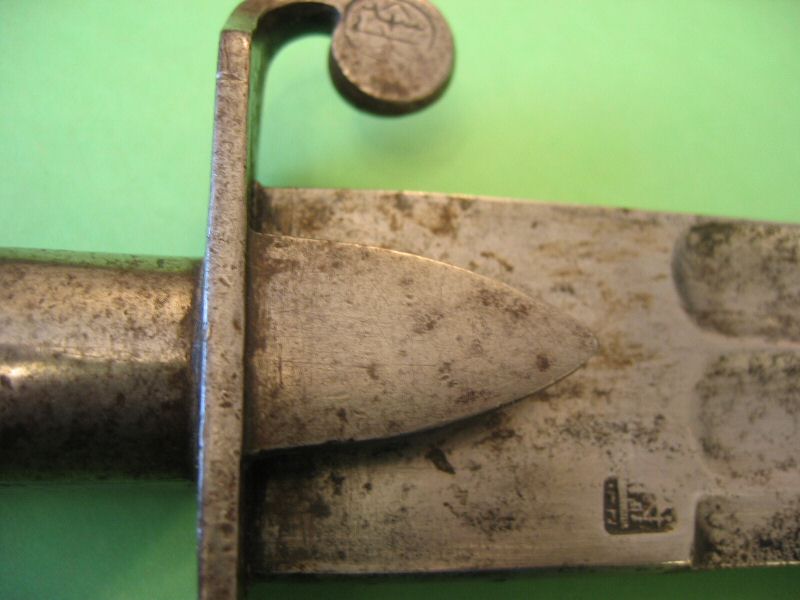

I have posted this sword before, but just to keep the thread alive, here are two pictures of a Central Asian shashka with the Mazar i Sharif mark next to a Gurda, with what looks like a 19th century European made blade.

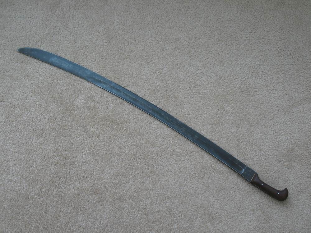

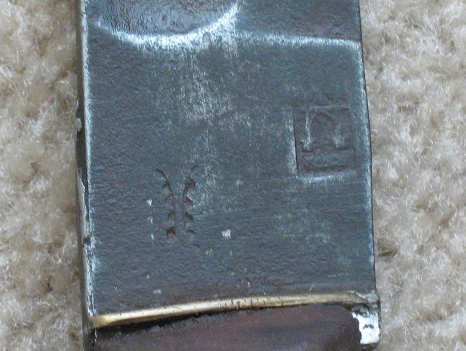

Here's a very similar Central Asian shashka I had. M-i-S mark, along with the year 1312/1894-5 , and another small mark on the ricasso. The blade is indeed a European import to my eyes as well. Not the most balanced sword I've had, heavy and unwieldy.
An interesting feature is that the grip scales appear to be of rhinoceros horn, which I find unusual for the region.

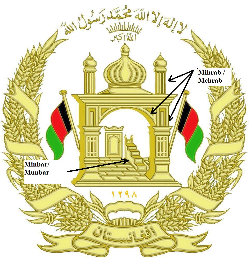

I thought I had corrected this b4. The mark is called Mehrab o Munbar, it is not a representation of a mosque but the representation of the ("alter area"/prayer area for the Imam) of the inside of a traditional mosque.
A search of Mihrab/Minbar would give you detail explaination and also more pictures. I just took one of the recent Afghan seals and marked the Mihrab and Minbar, The only time those 2 items were not part of the Afghan government seal was during the early part of the communist era. It signifies that the government is an Islamic government, again has nothing to do with the Mazar e Sharif mosque/shrine.
Brilliant stuff AJ! I realised years ago the mosque/armoury designation made no sense & tried to explain to evryone that it was a goverment mark as it occured on coins, weapons, flags etc.etc., not a mark of the Mazar al sharrif armoury as people used to say to me.
The info on shrine makes it all clear & is is easy to substatiate! Thank you for that info! Brilliant!

Kindly allow me to correctly name those objects in the picture of the Afghan seal, please!
1. Babu-l-masjid is the gate of entrance to the mosque.
2. Mimbar (Arabic: منبر‎, also romanized as minbar) is a pulpit in the mosque where the imam (prayer leader) stands to deliver sermons (خطبة, khutbah). The word is a derivative of the Arabic root n-b-r ("to raise, elevate"); the Arabic plural is manābir (Arabic: منابر‎).
3. Mihrab (Arabic: محراب‎ miḥrāb, pl. محاريب mahārīb) is semicircular niche in the wall of a mosque that indicates the qibla; that is, the direction of the Kaaba in Mecca and hence the direction that Muslims should face when praying.
