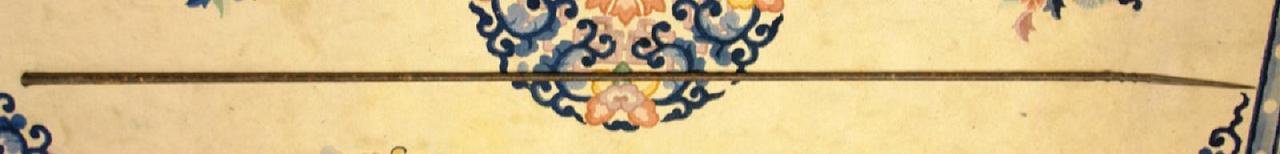

The unusual form prompted me enough to add it to the spear collection.

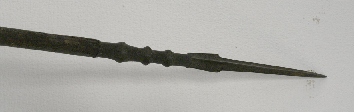

The thrusting tip does have some similarities to Song Dynasty spear heads but that's all I have turned up thus far.
Any one aware of the origins of this spear? An ID would be appreciated.
It is 8'6", the butt is a bronze cap and that's all I know other than the tip looks slightly off centre and the patina is very old. At the tip, I see a hint of an exposed tang going in to the wood but I am uncertain if this is so or if it is just age timber looking this way.
The images are the best I can do for now.
Gav

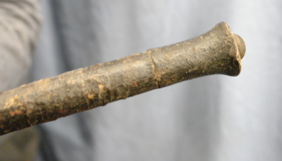

I do not think this is Chinese at all, just noting similar shaping to the head. The bronze butt is similar to Moro profiles but the large dome centre at the very end I can not recall seeing nor does the tip form fit Moro regions to my eyes.
Note too the thicker base area and tapering to the head, this too may indicate region

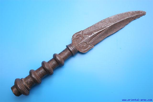

This maybe Rajput ....the Sang often have the 'ringed collar' and usually a pronounced central rib. Although most Sang are 'all steel', some variants have a wooden shaft. Rajputs also used camels .....and many lances attributed to the 'camel cavalry' are 8 foot or so long.....a similar length to yours.
I am wondering whether the blade on yours was more leaf shaped and has had a later modification either through damage to one or both edges or as an improvement (perhaps to improve penetration) as yours still exibits a strong mid rib
Below is an image from Artzi's site, although this is a curved bladed version the ring collar is self evident.

Well I have had about 30 spears and pole arms arrive on Friday and I've been enjoying going over each one in detail and this spear is very interesting.
It is long and it is very thin but strong and flexible though I'm sure I could snap it over my knee with ease today but it would have served as a very efficient weapon in its day when stronger and more supple.
The head, collar and butt cap are all iron with a heavy but perfectly stable age patina and the head is lethal with great piercing ability by design and the edges are so fine they would have been like razors in the day.
The shaft is bamboo which has been fully wrapped with a fine fibrous material and then lacquered thickly to smooth the surface which also shows a painted surface, this alone can point to India for many but...I'll come to that in a second.
The fine head has the iron collar which is actually four pieces stacked atop each other and offers great support for the tang in such fine thin bamboo.

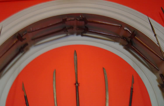

Thanks to those who have provided input this far....another step towards Thailand perhaps...I'm still looking down this road...
http://www.vikingsword.com/vb/showth...light=thailand
Note the spear of similar blade style, collar and thickness (and length if it rests on the ground) resting against this arch at the right (and one on the left)...
Has anyone other than Dan visited the Arms room of the Grand Palace Bangkok to comment first hand?? Nathaniel??

Missed your post on this thread otherwise I would have answered. Unfortunately, the three times we been to the Grand Palace, Chakri Maha Prasat hall that houses the arms room was closed. It's closed on the weekend and during the weekday it closes earlier than the temple of the Emerald Buddha which I did not know. I think if I remember right the building with the arms room might close by something like 3pm.
