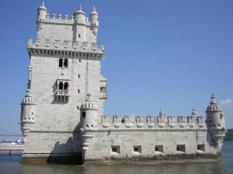

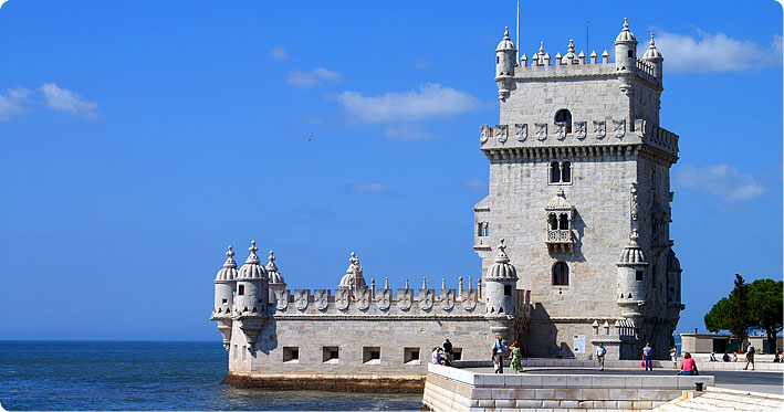

The Tower of Belem in Lison.
A stylized wealthy fortification, built during the discoveries period (1514-1520), to defend the entrance of the Tagus estuary.
It is now practicaly connected to firm land but, before the sand invasion, large ships could sail around it.
Fully adorned with stone crosses of Christ.

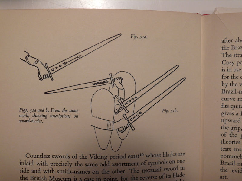

Pommel and blade inscription:
The pommel is indeed a final phase of the brazil-nut pommel. Oakeshott published in the sword in the Age of chivalry, a copper grave work of an alter made by Rodkerus of Helemeshausen in 1118. see picture.
Oakeshott quote"these inscriptions are not in the form of names,........,but of various apparently meaningless combinations of upright lines, crosses and circles,and in one case an interlaced pattern"Unquote.
the very short grip:
As can be also seen on this work the hand is too large for the grip.
Oakeshotts explanation is that the curve of the pommel in combination with the short grip gives a firm support to the hand and acts as a fulcrum to help an upward swing of the sword.
