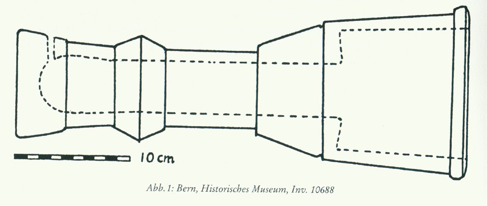

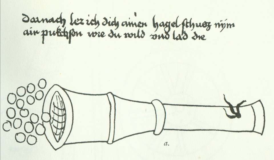

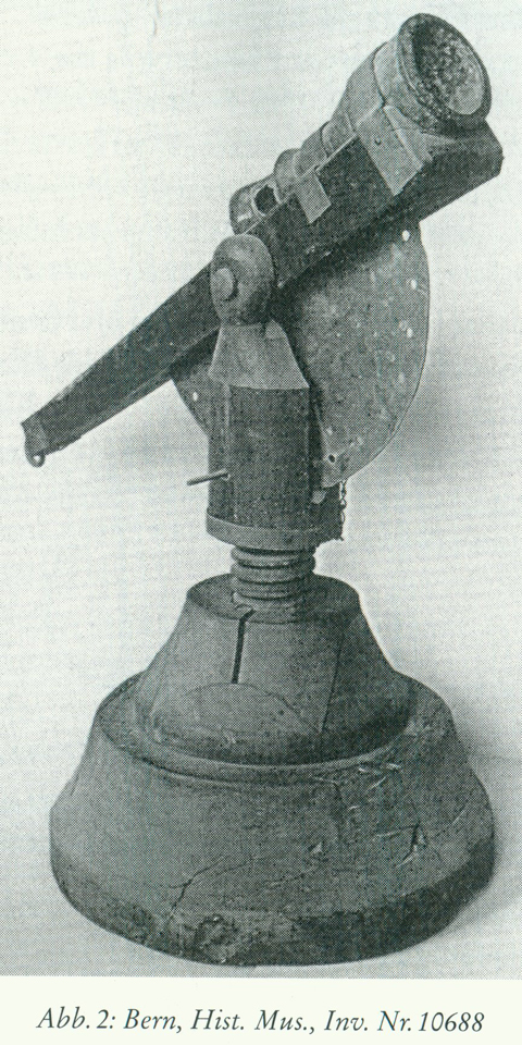

1. There was certainly no 'average' powder measure for each charge. In older sources we read that that the earliest 14th century barrels were loaded almost up to the muzzle so that the ball could literally be seen. Some of the Steinbüchsen of ca. 1400 which I recently posted, with their short actual barrels (Flug) and rather long powder breeches, seem to suggest a barrel length of ca. 2-3 balls imagined to be placed one above the other. No sure aiming ...

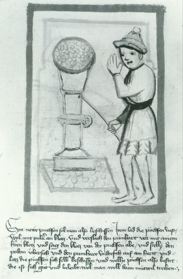

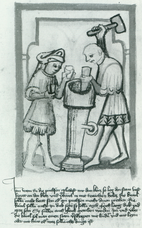

2. We know very little, if any, about wadding. Presumably in the 14th and 15th centuries, there was little or no wadding at all and most probably consisted of wooden or hemp plugs. There are illustrative sources of ca. 1400 showing a small stone gun (Steinbüchse) standing upright while being loaded by two men, with the ball seen at the muzzle and plugged by wooden wedges hammered in. This would mean that early plugging of loads actually meant plugging or wadding the ball rather than the powder load.

5. The actual load of powder I extracted from my 1481 haquebut barrel was not very much indeed, maybe 50 grams. I guess it was just the remnants of a bigger original load which, together with the missing ball, had fallen out long time ago. It would therefore be mere conjecture to make a section drawing.
