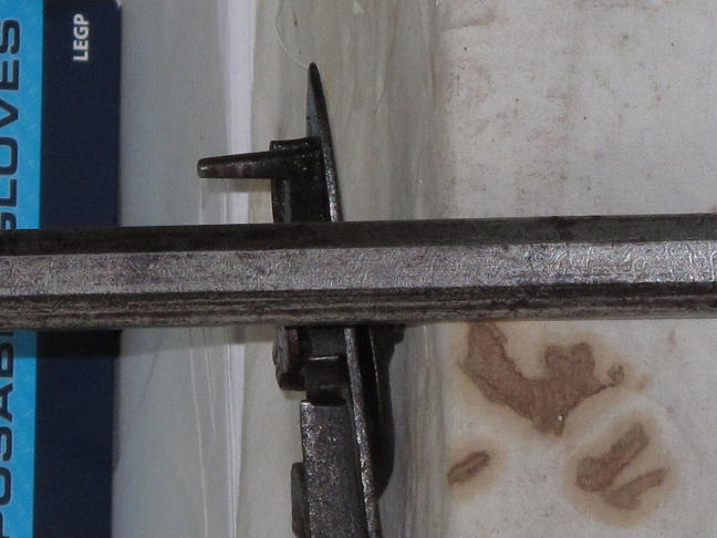

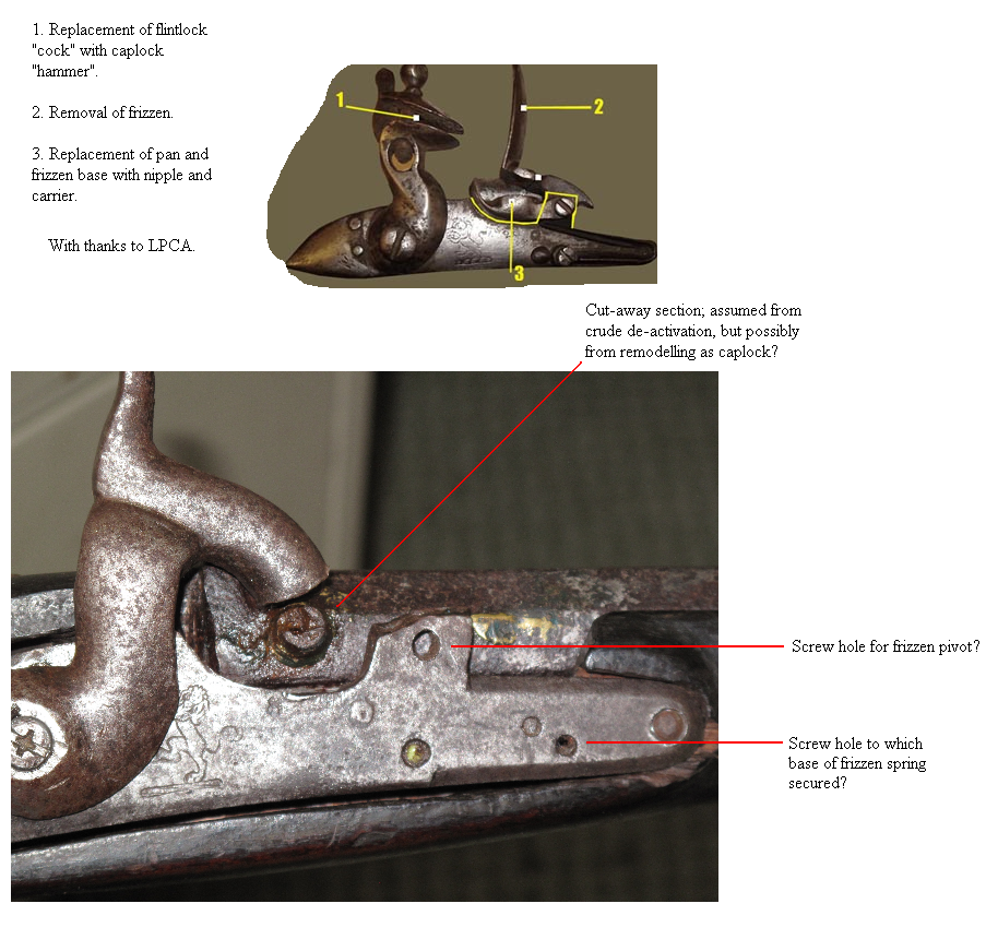

Ward, I hate to sound dense, but what do you mean by "watered"? Also, I enclose herewith a photograph of the reverse of the lock. It does appear that the barrel is only held in place by one screw, through its tang, so it might well be relatively easy to remove the barrel for work; there is, however, another screw on the underside of the bolster around the lock, perhaps for holding the trigger mechanism in place? Still not been able to get a decent shot of the lockplate, unfortunately.
However, regarding the lock, I remain worried about dismantling that. I'm very good, as you can probably tell, at finding things about which to worry!
Jim, I hadn't really thought of it that way. It had occurred to me that the markings were important, of course, but the aspect of assumed "transfer" of the original weapons' capabilities, and the strength of the forces armed with them, had not. I sort of assumed that the markings were treated much like a proof mark, i.e. as a sign of good quality of manufacture. It is, I agree, good to know that such comparatively ancient weapons as these are still in use to this day; if nothing else, they and the people who make them represent a fascinating insight into the pre-industrial processes of manufacturing, and their products, almost unknown in the modern Western world.

Watered means that the piece is damascus steel. Meaning it is a mixture of steel and iron and will show a pattern. As heavy as that barrel is I think it is possible. The contrast of the pattern is brought out by acid being used on the piece. People mainly use ferricc chloride now but just about everything under the sun has been used including urine.
regarding the barrel one screw at the tang should be all there is. The 2 on the other side of the lock should be there if not one is missing. I would not worry about a additional one near trigger you have no need to take it out. If you look thru the forum you should easily find some pics of other afghan pieces I have posted over the years. If not I can repost some

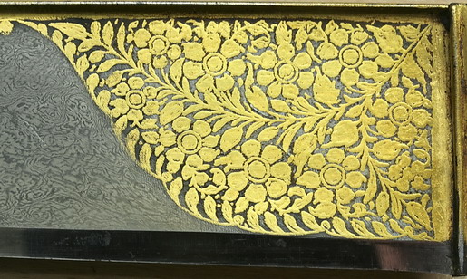

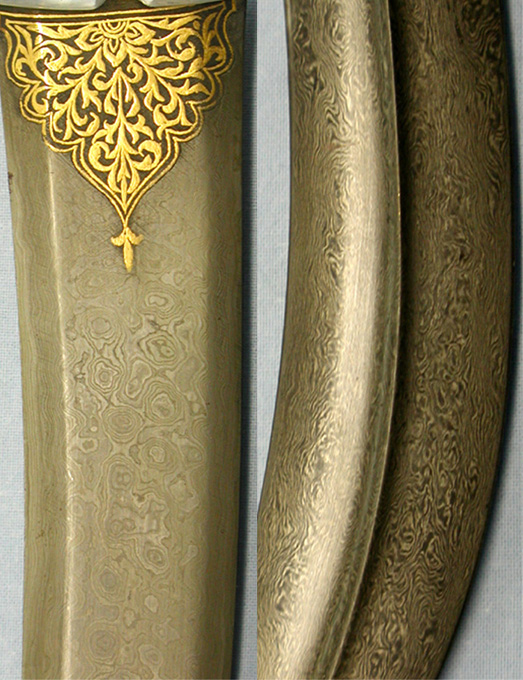

Watering or wootz you can see on the blade at the right side of the picture, the blade to the left is mechanical damask, but very skilfully done, it can be seen much cruder.
A steel blade keeps the edge very well, but it can be brittle and break, an iron blade is soft, bends easily but seldom breaks, and to this comes that it does not keep an edge very well – so to get a mixture of these two metals was important.
The last picture is from a Khyber knife, here the wootz is clear and you can even see how the koftgari was made.

Ahh, I see. Yet another term to add to my collection... I'm 99% certain this piece isn't damascus steel, though until I do remove the barrel and de-rust it, obviously I can't be completely sure. Having removed the foremost two barrel bands, however, I have had chance to look at an area of the gun that is largely corrosion-free, and cannot spot any obvious Damascus pattern. I note you say, Ward, that acid is used to bring out the pattern; I'm going to go out on a limb here, and guess that this is not something one should try at home?

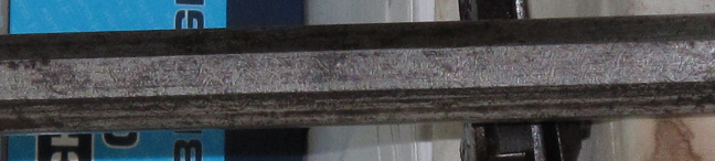

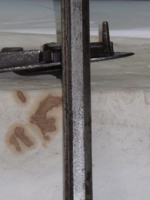

Well, I finally did it; I've dismantled the gun. No real surprises, I should imagine; the "ramrod" turns out to be a piece of painted dowel, inserted to keep the fore stock together, and the lock came away easily enough and seems, happily, to be in working order; at least, it certainly does a damned good impression of it! Having determined it was at the half-cock, I decided to cock it fully and fire, thereby releasing the tension on the mainspring. With the aid of a little WD40, it worked like a charm. My compliments to the maker!
The biggest surprise, however, is that the barrel steel does show a pattern! It might be damascus, I suppose, but then again it could just as well be faked damascus patterning. I'm trying to get a good photograph but this damned camera is still defeating my efforts; however, some select pictures can be seen below.

ok I see pattern. A quick and dirty way to see if it might come out take the strongest vinegar you have put in microwave and apply to the underside of the barrel. when you are finished use hot water or baking soda solution. It will not do anything bad to the outside appearence as long as you are reasonable carefull. If you see the watering that I expect I can talk you thru a better watering technique

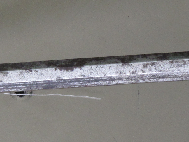

Right, I've done the vinegar-and-water acid etch trick. I can certainly see a difference; the pattern is very distinct, with many swirls and whorls, and even appears to have a tiny bit of a texture to it - though I can't feel anything through latex gloves. I've taken five pics and I hope they've come out all right, but if not, I'll work on getting some more done.
Incidentally, any tips and tricks on rust removal? I've not yet really embarked on de-rusting the barrel, since it seemed pointless when I was about to apply acid and water to it anyway, but hopefully I can now move onto that stage. So far I've tried a small area, using some reasonably fine glass paper, which seemed to produce results. With the lock, I've restricted myself to 3-in-1 oil and a soft cloth, removing as much excess oil as possible and leaving only a small amount as a film to inhibit further corrosion.

A small update. I spent a fair portion of Saturday working on the underside of the barrel, getting off as much corrosion as I could; gun cleaning oil, a good cloth and a great deal of patience have produced some result, with one patch of rust now down to the black, inactive stuff beneath. This area still has a film of oil upon it, so for now it's protected.
However, I really do need some advice on de-rusting wootz/Damascus; if it is indeed either metal, I don't want to destroy the pattern by over-enthusiastic attempts at rust removal. Furthermore, I'd ideally like to remove even the inactive rust. It strikes me as a shame to leave the beautiful metal beneath obscured by great black blotches. There is also a time factor at work here, in that the piece should ideally be ready for display by early May, and I'm away all of next week on a Curatorial course in London, so advice and assistance will be most gratefully received.

You may want to stop at this point removing heavy black pitting can be made better by using brass dental style picks along with oil.It is time consuming. To correctly acid etch a full barrell you need to submerge the whole barrel. You can get various other results using a quick ferricc chloride etch. If you are feeling brave you can do it with a full hydracloric bath but I would suggest you may want a chemist or a similar type of person with you to do it. It is a little dicey

Been removing the active rust, and have found that it's been working long enough to leave big, very ugly patches of black inactive rust all over the barrel's upper surfaces. I'd love to remove these but gather that inactive rust is bonded with the steel pretty firmly; noting Ward's recommendation of brass dental picks, would a brass brush do the same sort of job? Also, discovered that the green "copper" corrosion is indeed attributable to brass - consultation with a nearby expert on Oriental (i.e. non-Occidental) arms suggests it's part of the brazing that held its pan in place back when it was a matchlock (!); in the same area, the nipple carrier is seemingly screwed into the touch-hole, and the breech plug looks to have been (very crudely) welded in place. Eesh. Makes one leery of trying to shoot such a thing.

And a belated reply, with a minor update: browsing around the forum for further information on these creatures (I'm now thinking of buying one myself - it's everyone here's fault, I tell you!) I came across http://blade.japet.com/B-afghan1.htm - which got me thinking about this lock. I had attributed the cut-away section of the lock to a crude attempt at de-activation; is it instead possible that this was a native-made flintlock, modified to become a caplock? I present my hypothesis - with thanks to LPCA - in the form of this magnificent illustration.
I also attach a couple of better pictures, which might show the watering more clearly than did my previous efforts.
