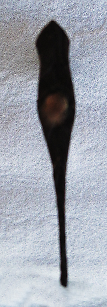

Made that picture of the crest a bit bigger .

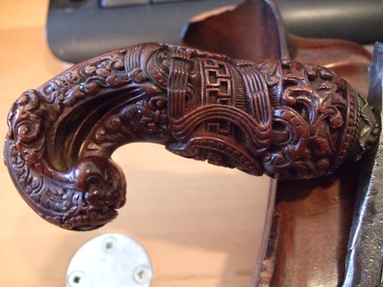

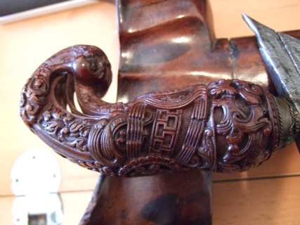

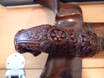

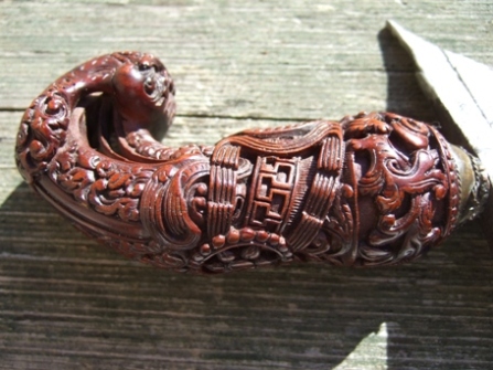

Default more pics of the hilt
My first thought was that the hilt was plastic...

A lovely maduran keris to start with. Congrats on this find. I would leave the dress as it is. If possible the blade could be etched in the traditional way with warangan.

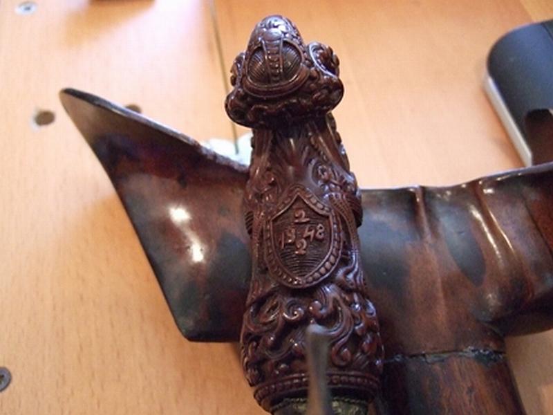

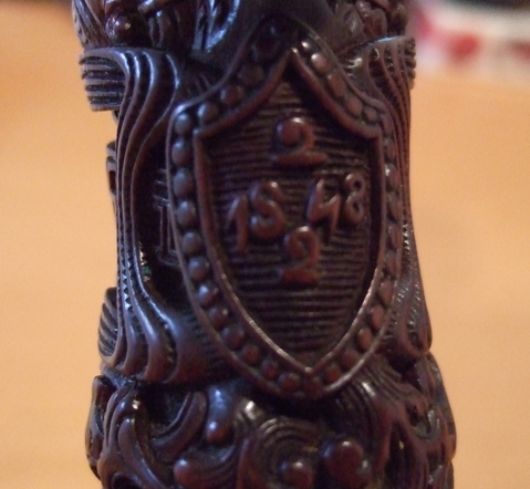

I found the date of 1848 on the hilt
Isn't that 1948?
Looks like good quality carving though.

Originally Posted by kai
Isn't that 1948? Looks like good quality carving though.
It is hard to tell given the angle that the photo was taken, however, i don't believe that the date (if it is a date) can be taken as an actual date of creation in any case.
It is both an unusual and nice carving though.

1848, new picture.
OK, so I get it off and take the picture.
How do I reattach it?
Probably won't get to this until the wekend...

A very nice well made rather old and unusual handle. Without doubts a very good carver

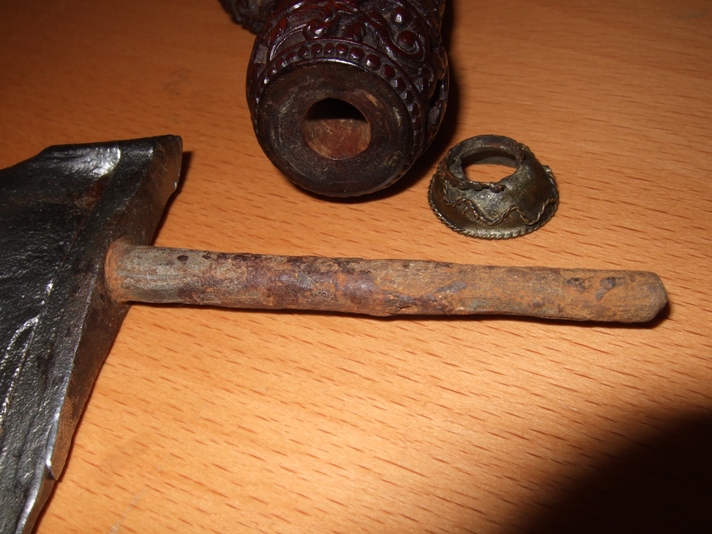

Cool Success
got it off, some old wrapping around the tang.
Once I got it off I noticed there is a definite offset in the axis of the tang and the blade. I read that the blade was supposed to point slightly downward when held level? If that is so, I think maybe my hilt was on 180-degrees off?
That level of cleaning I am up to...

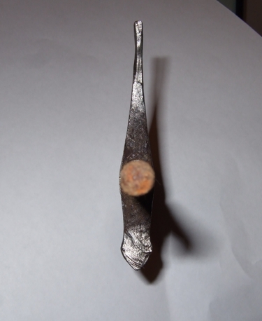

Thanks schmoozer.

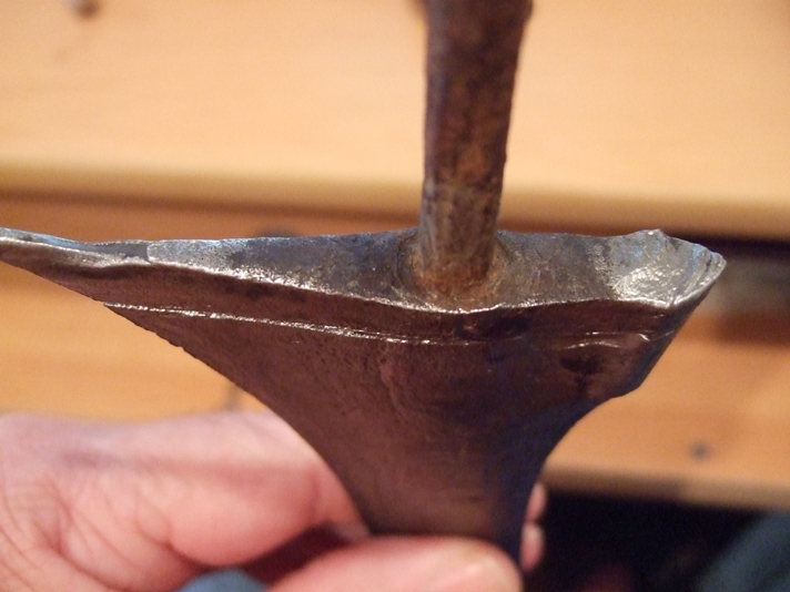

We really need to look straight down onto the top of the gonjo, because the angled shots do not always give a correct impression of the outline or the proportion.
We need to see the shape of the thick end of the gonjo (the sirah cecak), but we also need to see the outline of the top of the gonjo between the tang and thin end of the gonjo.This is important, because if there is even the slightest inward curve in the line of the gonjo here, it is not Tuban.
Can you confirm that the line along the sides of the top of the gonjo, between the mid-point of the tang, and the thin end of the gonjo does not have any curve in it?

new view

Anyone care to take a shot at what that silver material on both sides of the top of the gonjo might be? Remnants of some sort of silver "kinatah".

Thanks schmoozer, that's great.
This cannot be a Tuban blade.
The length of the gonjo from the pesi (tang) to the buntut urang (narrow end of gonjo) is too great, there appears to be a very slight curve in the side of the gonjo, and the buntut urang itself is the wrong shape for Tuban, additionally, many would not accept the sirah cecak form (wide end of gonjo) as Tuban.
I am not prepared to give a classification on this blade from a photograph.
David, I think that that material may be the remnant of a separate layer that once covered the top of the gonjo; it has eroded and broken away. I've seen this type of construction a number of times, sometimes in a pamor that matches the blade, sometimes in plain iron in order to conceal the pamor.

I dug this up talking to Brad in PM about dated hilts. The only other one i have seen was posted on this forum some time ago. Same kind of number orientation with a number both above and below the "year", if it is a year. We didn't really come to much conclusion on that one either.
http://www.vikingsword.com/vb/showth...ght=date+keris
