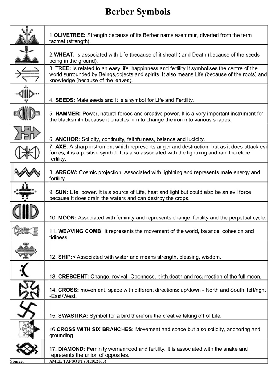

While gathering material on Kabylia and the Iflissen, I found these pictures of motifs used on traditional Kabyle pottery. Notice that one symbol, the double drum means "axe", while the double zigzaging lines could mean "arrow" or "mosquito". I will keep looking at the various symbols we sometimes see on flyssas.

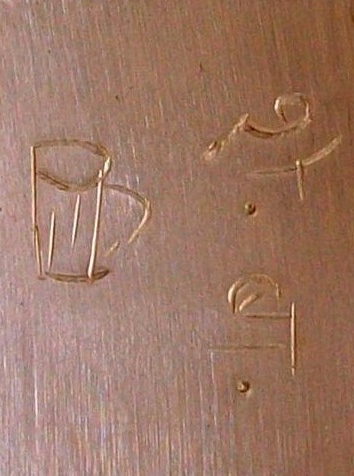

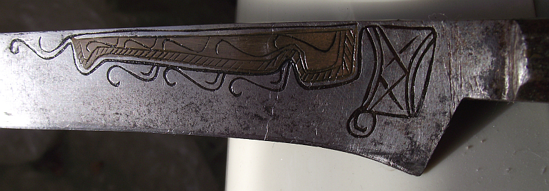

there is a drum-like object on the port side of my flyssa near the integral bolster. the carry strap is on the bolster side of the 'drum' (1st photo attached)
interestingly, there is a khukuri kami (blacksmith) in nepal that uses a similar Madal Drum (<-linky) mark (2nd photo) with the strap. jokingly referred to as the 'beer mug' kami. More Madal Drums <-linky - shows vertically displayed drums with cords curlicued off in similar to the curled lines off my flyssa 'drum', they appear to be the ends of the cords used to mount & tighten the drumheads, left long but curled up.

Just a few observations of the symbols shown by Emanuel....and a few thoughts 'outside the box' ....so bear with me
The symbol for lune (moon) and that of marteau (hammer) are very similar (related ?). Which makes me wonder about several possibillities.
If this symbolism is widely accepted across the Saharal regions ....could this indicate the reason of the the moon symbols on Tabouka ? It is interesting that the moon and hammer symbols seemed linked perhaps because...
The hammer is the main tool of the blacksmith/bladesmith.
Forging during the day with the heat of the sun and forge would be 'uncomfortable'....perhaps dusk/evening would be prefered ?
Whilst heat treating the steel the 'colour' of the steel would need to be acurately gauged....dusk/night time might be much better conditions than direct sunlight ?
Could evening be the best time to forge blades ...hence the hammer and moon link ?? Could a blade forged at 'night' be considered a better blade and the moon mark be a sign of quality ??
My other observation is the Soleil (Sun) symbol ...it is almost an interpretation of the famed 'eyelash' mark ???? Perhaps coincidence ....but interesting never the less.

Excellent observations David! The sun mark's similarity to the gourda mark had come to mind but I didn't make the connections to the moon marks. Note that those are usually back to back )||(, not front to front (||) . Very nice extra-box thinking

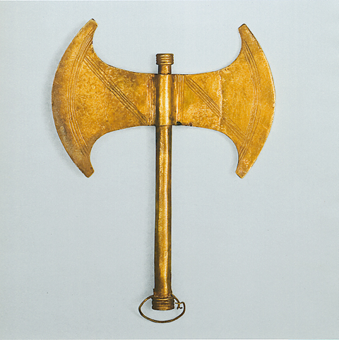

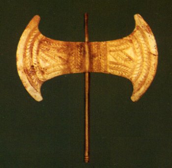

Here's a thought that's been bugging me since I saw the axe symbol. I haven't found pictures of any similar double-headed axes used in north Africa. The symbol does however remind me strongly of the "labrys" the axe symbol of the Minoan civilization (see attached).
As always, this can be simple coincidence, but it's fascinating to think that such symbols should persist for so long in cultural memory.

found this ...
".........The labrys is a double headed ritual axe. It is found in ancient Minoan depictions of the Mother Goddess, where its symbolism is related to the labrynth. The word “labrys” is Minoan in origin and is from the same root as the Latin labus, or lips.
Similar symbols appear on Norse, African, and Greek religious objects, where it is most often a feminine symbol, most likely lunar in origin........"
".....lunar in origin " ......the moon, yet again ??
Regards David
