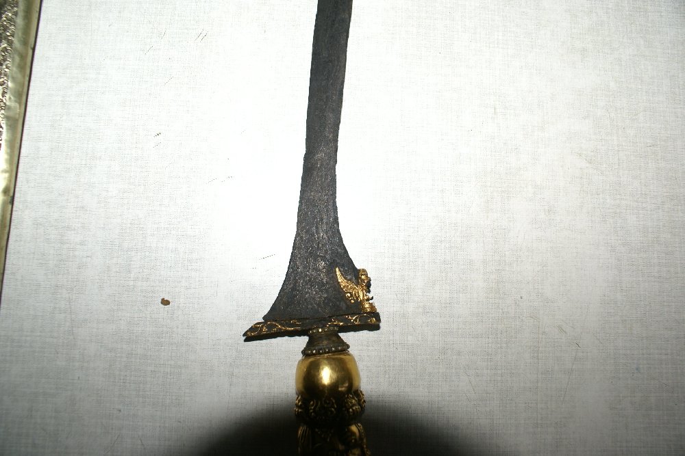

hello this keris I bring with me this vakantie from indonesia ho can tel me more about this keris thank you guys
semar is offline   Reply With Quote
Old 10th November 2009, 03:21 PM   #2
Posts: 7,303
Well it's Palembang, Sumatra for starters. Well carved old hilt. I'm not sure when the gold foil was added. There doesn't seem to be much craft in it. The selut/pendokok doesn't look right for this keris.
Have you tried pushing the pendok up into place?

Hello Semar,
David is correct, Palembang keris with nice hilt. The gold is original I think, this sort of gold work is like this, look my keris in this thread:
http://www.vikingsword.com/vb/showthread.php?t=10998
A thin gold sheet was put over the gandik part and the up from the ganja. I have a other one where all gold is missing.
You can't push up the pendok?
I agree the selut seems recent to me and does not quite match the quality of the rest of the keris. Still a nice piece IMO.
It's not the quality that is the problem for me. I might be mistaken, but i don't think this is the proper style for a Palembang keris. It looks Peninsula to me.

Originally Posted by Moshah
Hi Detlef,
You mean, the gold is originally and purposely being applied overlay the ganja like that?
Or was it overlayed because the original kinatah gold are missing there? Was that is the real purpose of the overlaying?
Hi Moshah,
yes, I think that this is original. What I have seen until now is that the way of kinatah work on Sumatra is different than on Java or Bali. Look for example my blade in the link in up. Here a picture from the Sumatra blade where all gold is missing, you can see how the gold have been affixed before. And a second picture of an very old Madura blade with kinatah.
Sorry, the first picture is the Madura blade and the second the Sumatra.

Old 12th November 2009, 05:26 PM   #9
You mean, the kinatah from Madura and Java is bold, while Sumatran style of kinatah is like a simple gold overlay (like a watercolour painting)?
BTW, nice kinatah on your Madura blades!
Thank you for the compliment of the Madura blade.
No, I mean that the kinatah from Sumatra isn't so strong attached like by Java or Bali blades. This is what I have seen by my both blades and some other blades. Would be interesting to read the knowlegde from other members.
Old 12th November 2009, 08:50 PM   #10
Posts: 7,255
What we are looking at here is a variation in technique, and a variation in quality, rather than a variation based on geographic origin.
Kinatah is where the individual elements of the motif have had gold applied to them. There are several ways that this can be done, some are better than others.
Where an overlay of gold has been applied to an entire section of metal, we are not looking at kinatah work.
The best kinatah work I have ever seen is on a Balinese royal keris; I have seen and I own several keris and tombak from South Sumatra and from Jawa that all have very good quality kinatah work.
It is a matter of the level of quality and the technique of ornamentation that has been used, rather than a matter of geographic origin.

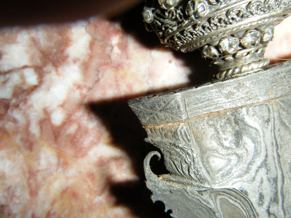

hello this i have teak from my last vakantie ho can tel me the name of this pamor
regards semar
regards semar
I would call it Beras Wutah.
