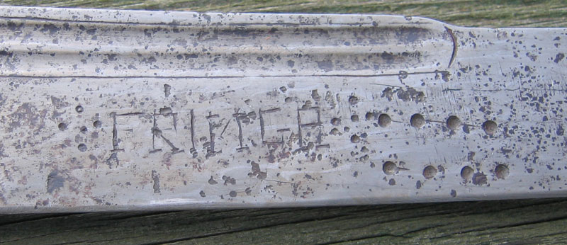

Default FRINGIA
On sword blades typically of Austro-Hungarian origin it seems, this word/name? appears, sometimes with the familiar 'sickle' marks. It would seem the period of occurrence extends from mid 16th century to mid 18th century, and it would be interesting to know if anyone has ideas on what this word might mean.
Of course I know this has been discussed before, but this renewed effort is simply to provide material for the readers, and as an exercise for those who participate regularly......our stalwart legion!!!

Thank you so much Manolo and Jens!!! Exactly what I was referring to...you guys always step in to help out, and I am very grateful. One never knows where key bits of information might be found, and sharing anything might be the key.
I first encountered the word FRINGIA on sword blades noted in Eduard Wagner's "Cut and Thrust Weapons" (London, 1967) in material on pages 348-349. It appears as early as the blade of the sabre of the famed Polish king Stephan Bathory (1532-86) and seems to have continued to be seen on Eastern European sabre blades through the 18th century.
Many of these blades seem to have also carried the magic/talismanic motif which became popular on blades in these regions as well, including sun, moon, stars in varying number, style and arrangement. These features are represented in this nicely done sabre you posted Jens, and reflect the consistant use of these motifs.
Manolo, I had never heard of this word occurring on Islamic sword blades, nor the presence of Persian blade factories in Turkey, and assume this would be noted in "Arms and Armour from Iran", by Manoucher Mostagh ? I do not have this reference but it consistantly gets good reviews, as it is one of the few reference works in English on these weapons. It seems to make sense, as the Persians did send bladesmiths into other regions, India and Central Asia, and particularly I would imagine into Ottoman regions.
The FRINGIA marking seems to occur along with 'sickle' marks as well, with these devices well known on trade blades which became commonly associated with the Styrian swordsmiths. Sir James Mann, in his 1962 work on the Wallace Collections notes that not only FRINGIA, FERARA and GENOA appear framed by these markings, but some of the accompanying motif as well. Since these representations seem to be applied on trade blades to extol the virtues of the blades quality, perhaps the word FRINGIA occurs in that sense as well, and is of course equally elusive.
We still do not know conclusively the details of the mysterious ANDREA FERARA, but know that the 'name' appears on Solingen blades, often with the sickle marks. GENOA of course derives from the port of departure in earlier times for quality Italian blades from North Italy.
That FRINGIA appears in this sense on Ottoman blades seems surprising, but understandable in that by early 19th century this faltering empire was leaning toward the west in Turkey's adoption of its military fashion and weaponry in degree. Persia had become more commercial in production of trade blades (as discussed by Oliver Pinchot in his outstanding article on Assad Adullah) and certainly Turkey had similar designs in its trade oriented weapons.
I think it was Ariel who once suggested the word might be associated to the term 'ferangi', often used as we know to describe certain weapons in India with trade blades (ferangi, phirangi= foreign), which I thought brilliantly astute. The earlier use of the word on the Bathory sword would unfortunately appear to defeat this possibility, and I'd like to know more on that.
On a more contrived note, Wagner (op. cit. p.348-9) suggests that this term is actually an acronym "
FR= Fredericus III, Holy Roman Emperor 1415-93
Rex= Hungariae
IN
Germania Imperator Augustus
FRINGIA
Plausible? Yes.......but, conclusive, far from it.
The many variations of spelling ; FRINDIA, FRINCIA , FRANGIA may be the typical instances of misspelling characteristic on trade blades carrying spurious markings and names, but in earlier examples in context might weaken the acronym theory.
Well gentlemen, these are what little I have known on this curious word that stands on so many blades to taunt us, and my thoughts in line with the posts Manolo and Jens have added along with the known material I have seen.
I encourage all out there reading to think on this, and try to recall perhaps a place name, linguists, a word or term, perhaps a historic figure.....any of these that might offer clues.
All thoughts and ideas will be gratefully received, please join in on our little mystery!!!!
Thank you again guys!
All very best regards,

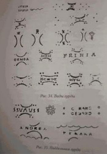

Buendia posted ( sword markings thread) a scan of a page with several sword markings ....mainly various configurations of the 'eyelash' mark. One has the name FRINIA ....Buendia does not cite the reference but he is 'based' in Poland and the reference could be Polish ....not a million miles from Hungary
Best Regards

Hi David, and thanks for the note and adding that page illustrating this term and variants with the 'sickle' marks!!

I am note sure where the picture of Buendia came from, but a reproduction is found in Askhabov, ”Chechen Arms” Pg.68 to illustrate the “Gurda” mark. I can’t tell where the original is from, but, I would guess Astvatsaturyan. I would check if I could but I am still waiting for the English version .

The picture of the multiple "gurda" markings with a word Frinia indeed, comes from the Astvatsaturyan's book " Weapons of Caucasian nations"

Fringia is on a lot of saber blades spelled different ways.
I asked Oliver Pinchot about it and he wrote
"You can pretty well shave with Occam's Razor on this one. The appearance of the word FRINGIA, variously spelled though it is, almost certainly refers to Thuringia in Saxony for two reasons:
1) the iron ore mined there during the Middle Ages was reputed to be of very high quality, in fact it is still famous for it; it supplied the major arms-making center at Suhl.
2) it is common for the letters T and TH to shift to an F in many languages and dialects. So for Thuringia to become Fringia was a pretty short walk, orthographically speaking.".
Ward
Old 11th December 2009, 03:55 AM   #25
Posts: 10,865
Well there ya have it!!!! Excellent Ward, and very well put by Oliver, in his very distinct and wry humor! He has always had a brilliant way of putting things that melds superb scholarship with devious wit, leaving you with a permanent understanding of the subject, that makes you smile every time you remember it. A scholar extraordinaire.

Personally I really do not believe the word Fringia refers to a specific area in Central or Western Europe. To me, it simply means a sword with a Western European blade (and by Western European, everything West of Vienna is meant).
In Bulgarian folk songs it is mentioned as frengia, pronounced fraen-gee-ya, such as:
Тънка пушка бойлия (Thin rifle boyliya)
Остря сабя френгия (Sharp sword frengia)
In Dr. Elgood's book, on page 49, we find another evidence that for the Ottomans, Frengi was just an adjective denoting European origin:
In a list of arms, dated 1009/1600, from a Vizier's cebe-hane, we find, among 75 tufenkler, the following types: [... ], Frengi (from Western Europe), [...].
So to me the meaning of Fringia, or Frengia is just "from Western Europe", in this case a sabre. Similar to how a "damaskiniya" referred to a sword with a wootz blade.
Teodor
Old 20th December 2009, 05:09 PM   #27
I am with Teodor here.
First, if Thuringia gave birth to Fringia, what happened to the "u" sound?
Second, transmutation of Th to F usually goes from W.European to Slavic languages. As an example ( just to make Teodor happy), Theodor became Fyodor in Russian. I thought for quite some time about a reverse move, and could not find an example. Anyone?
Third, the Fringia blades came from different places in Europe; why would ( for example)Italians be influenced by a German locality? German blades in India gave birth to a curved saber called Alemani; but the name is French in origin.
A crazy thought: was Francia ( another popular label) just a result of a mis-spelling, whereby the horizontal tick in G was missed and the letter became C ? Either Western masters were not exactly literate or the Eastern ones just copied the mark without understanding of the meaning ... Kind of like me re-drawing Chinese hieroglyphs :-)
