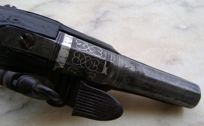

A little (pocket?) pistol with 19 cms (7 1/2") total length.
Patilha (Miquelete) lock.
Barrel, part three upper faces and part 16 faces.
Breech florals, side plate, trigger guard, estucheon, buttcap and grotesque face mask all in decorated silver.
Caliber 15 mm.
Ramrod missing.
Questions:
Age ... 18th century?
Origin ... Portuguese, Spanish or French with a Spanish lock?
Anyone care to comment?

Though this is not as old as most pieces that am headed for I like your little pistol, especially the nicely constrasting blackened stock and the embossed silver inlays. Most of all, however, I admire the perfectly homgeneous surface patina.
I tend to assigning it to either Spain or Portugal, ca. 1730-50 but will look up what little I can find in my humble library (not a joke because I am not really overfed with books on Italian, Spanish and Portuguese arms). Also: I should not totally rule out Southern Italy as a possible provenance.

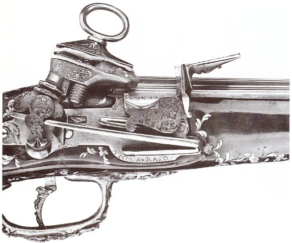

Beautiful piece. Caliber?
I hace seen identical verticsl stripes on the striking face of the frizzen in Spanish Migueletes.
Any punzon/poincon armourer's marks?
M

Fernando, there seems to be indeed a certain French influence in both the decoration of the barrel and the embossed silver on the stock. As there is no doubt that the lock originally belongs because the figured stock closely follows its characteristical contours, especially at the bottom line, the thesis of a French export model in the Portuguese or Spanish taste is worth considering in my opinion.

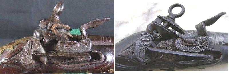

BTW, let me tell you that, to my ignorant eyes, there is a great resemblance between the lock of the pistol you posted above and my example.
Is that pistol yours? Can you post pictures of the side plate? I heard that if the plate is fixed with several little nails, it could be a Rippol weapon.
Can you establish its origin ... Spanish? Ripoll? this is very important ... please tell.
I have also detected a pistol attributed to Ripoll production, with the barrel in a fashion similar to mine: first section with an upper 3/8 faces and the rest with 16 faces all round:
http://www.armasantiguas.com/avancarca/htm/1086bls.htm
I wonder if this barrel profile is a Spanish (or even Ripoll) exclusive fashion; that might also be a way to confirm the origin of my piece.

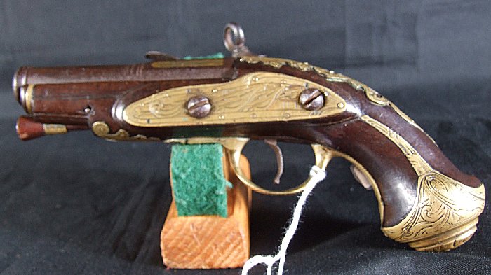

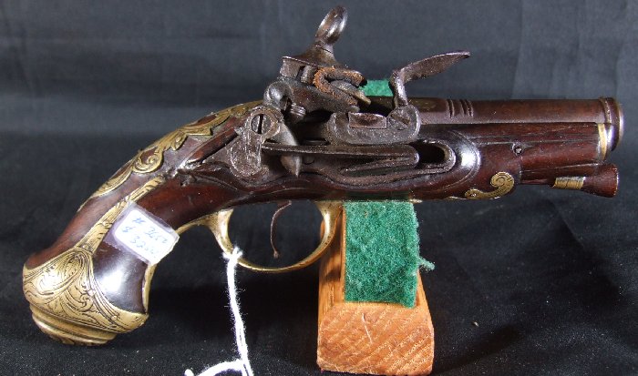

Hola Nando,
Michael suggested the french provenance.
Your portuguese source and me share similar opinions.
Zorry! The pistol's images I provided belong to a Spanish pistol found at an online auction service. Sadly, mine was not the winning bid, but I did keep the pictures for future reference.
Now, this one is mine (click on the thumbs) :
Portate mal!
M

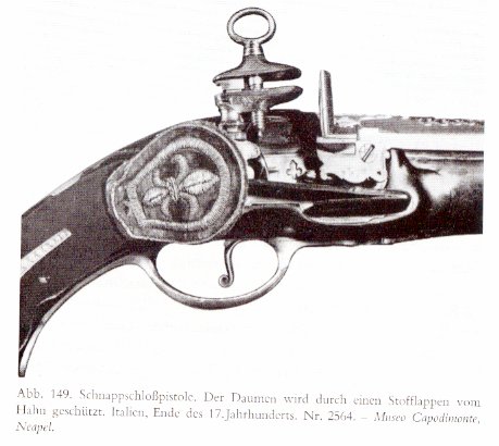

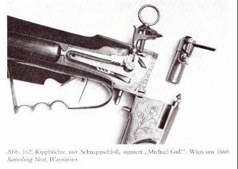

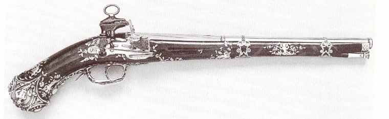

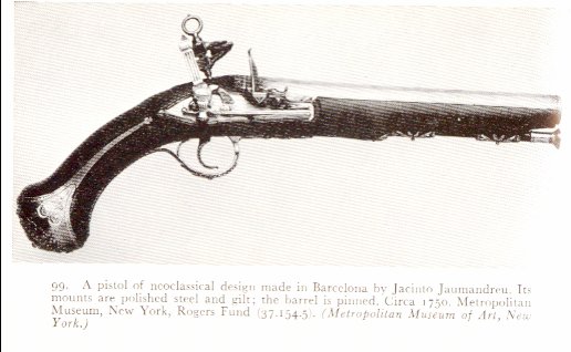

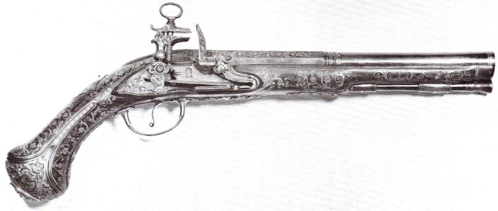

I attach scans of Italian miquelets, and even one from Vienna, Austria proving that these locks 'alla catalana', and of mediterranean origin, as Arne Hoff put it (Feuerwaffen I, 1969, p. 233) were widely copied while the rest of those guns mostly kept their national characteristics.

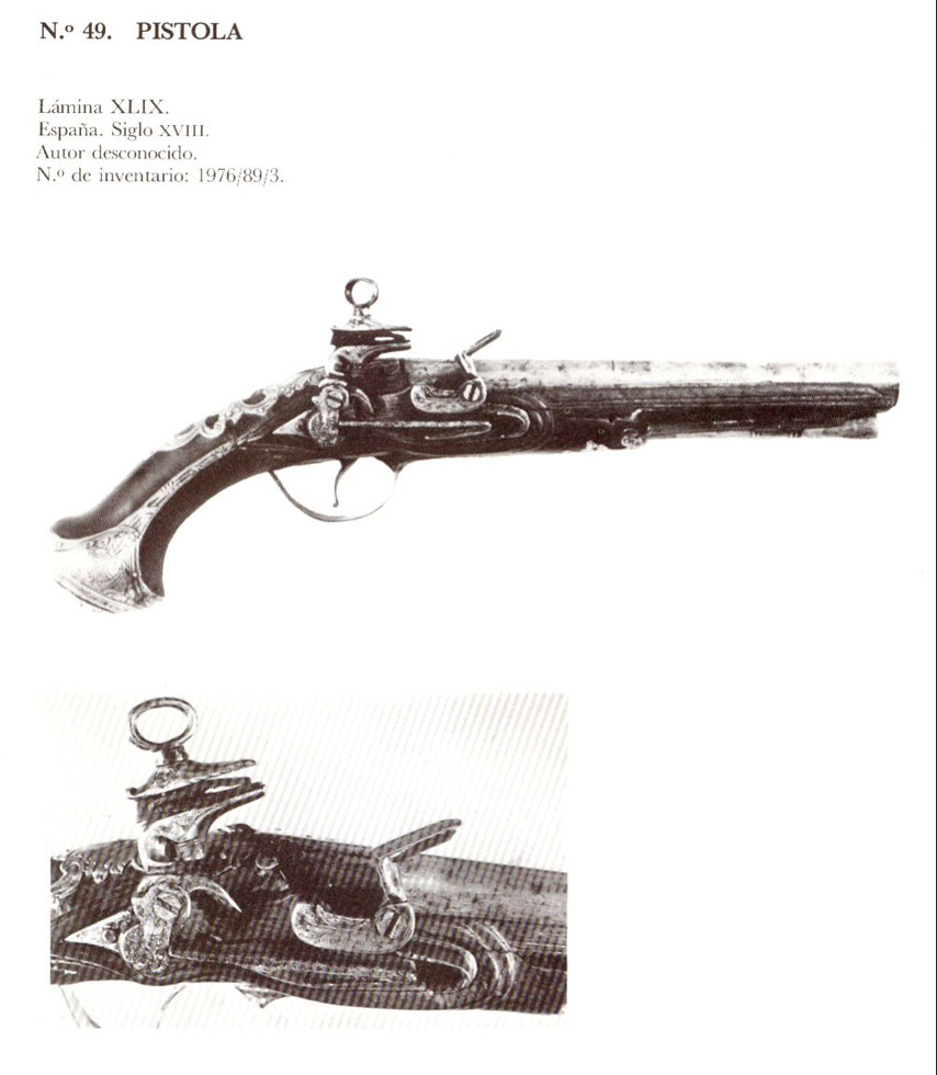

Finally I found two Spanish pistols very close to Nando's in the firearms catalog of the Museo Arqueologico Nacional, so please enjoy.
Mike(y)

Yes, pistola #49 has a cock foot similar to mine, which is not the (more)usual straight profile. Same goes for the frizzen spring.

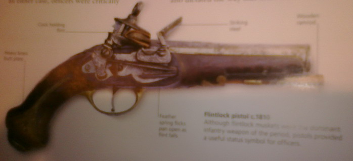

From a Borders bookstore book. It's dated to 1810...
M
