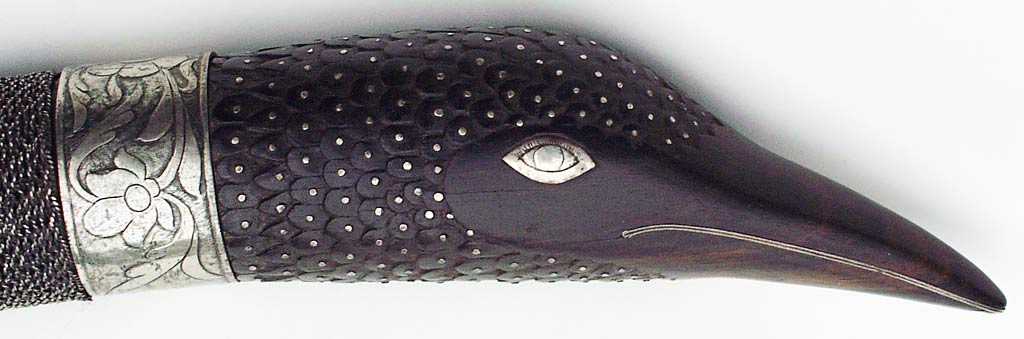

Question Bird-head Panabas

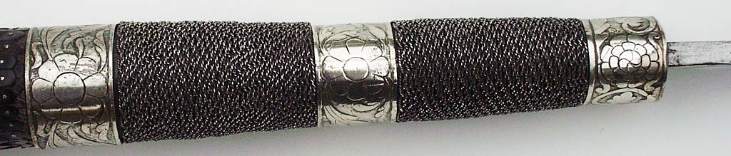

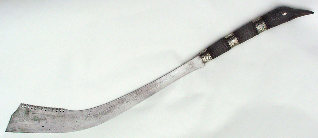

Very much as the last moment I decided to go take a walk through the Hartford show and found the below odd bird at the table of a dealer who is clearing out a large ethnographic collection assembled a few decades ago for an estate.
This hilt is 12 and 1/2 inches long. The hardwood does not seem to have much age on it at all, but the silver ferrules and wire wrap are a bit loose, testifying to some shrinkage. I seriously doubt these are the first mountings for the blade.
I will, in due course, borrow a camera and get some photos of the blade taken and posted. For now, though, I would like to ask for your opinions on how much age this hilt has on it and whether it was made for local or tourist taste.

Old 11th October 2009, 02:10 PM   #4
Posts: 7,297
The motifs on the silver bands look suspiciously Indonesian to me.

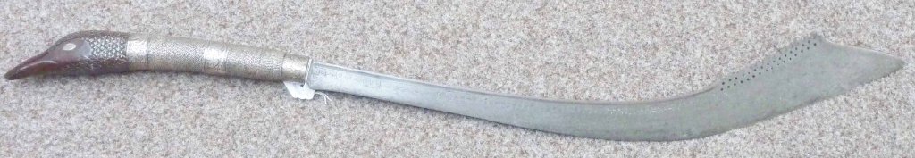

Two Ricks here Lee .
Here's this Rick's opinion .
Blade length: 23 3/4 inches
Overall weight: 1.2 kg
I'm not sure Lee, sure looks like a Panabas with perhaps a swapped out Thai handle; married piece ?
AFAIK The Moro peoples never did hilt work such as this ...
But there's something a bit strange about the 'Panabas' blade also ...

I don't think that hilt is Thai or Burmese, Lee. Some similarities to silverwork of the area, but different.

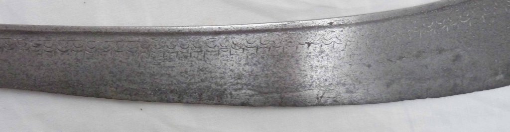

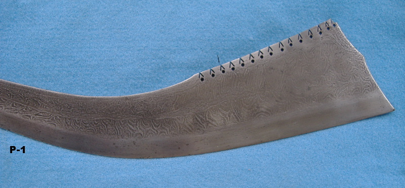

Red face Blade fretwork
Here is a closeup of the fretwork towards the tip of the blade. It is quite crisp, though not overly so, and I wonder whether it dates to the forging of the blade or may be contemporary with the handle.

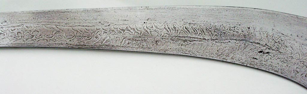

Lee,
Hideyoshi has good eyes not only to recognize the similarity of blade shape between his example and yours but also notice that your example most probably has a twist core central panel like that on Hideyoshi. You can see the clear line of demarcation and hints of a twisted pattern in between those lines. With this blade being twistcore and of general panabas shape, I strongly suspect the blade is Moro and the hilt is a later add on from who knows where. Very neat blade and you don't see twistcore panabai very often!

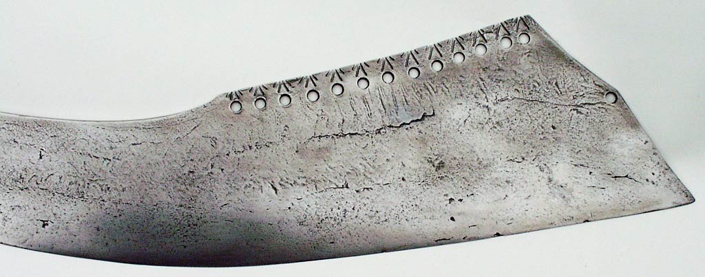

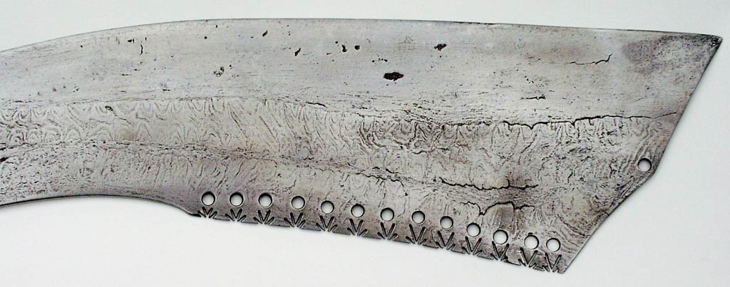

Wink Yes, a twist core
Rsword, Hideyoshi and you both have good eyes and are entirely correct in your suspicions. The blade was in a rack perpendicular to the front of the table with only the face I have previously been showing on view. Somehow I had just enough of a hint or the piled construction to ask to pick it up, and the opposite side - pictured below - was much more overt. I think some persons more expert than myself bypassed it without closer inspection owing to the enigma of the hilt.
My own suspicions are that the blade may well be 19th century or early 20th while the hilt has likely been made since the time of WWII. Personally, I do not believe this hilting to represent a tourist item or a Western bladesmith's fantasy piece - the hilt allows for an excellent grip and the balance is favorable - and the work is either too good or not good enough to recommend such classification. So I guess I will just have to live with the enigma until someone recognizes the style and can place the origin of the grip.

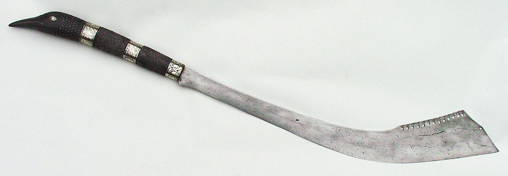

Old 17th September 2011, 10:06 PM   #14
Gavin Nugent
Gavin Nugent's Avatar
And now you all know it is not alone in the world ;-)
Gav
Old 17th September 2011, 10:57 PM   #15
Posts: 7,407
I guess I come in late on this piece (and some how missed it) I think this hilt is late and not truly Moro. Moros would have traditionally used okir to make the hilt in an animal shape but not like this. Yes this is a little odd with 2 of them, but still I'm not sure the hilt is Moro or at least it is late in origin.
I would however place the okir bands and twisted silver bands as Sulu. I'm thinking therefore this is a later work on the hilt.
Old 22nd December 2011, 05:15 PM   #16
Lee
Lee's Avatar
Posts: 998
Thumbs up Thanks for the updates!
Gav & Battara - Sorry, I missed your replies of several months ago until now. I believe the hilt on mine is very recent and clearly not original to the old blade; Gav's hilt may be a little earlier than mine - but they really are 'birds of a feather' and it is nice to know that mine is not alone. Hopefully we will find out where these are coming from in due course. Probably a living artist.
