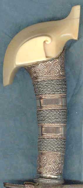

Hi folks. First I want to thank you Ian for your kind feedback. Second, I will try to upload the pictures in the right places:
INLAY:
Deep grooves are cut into a harder material (ideally at different angles) and then a softer materal is inserted. For example, on Ian's barong, I had to re-engrave the grooves - cut deeper into the grooves - into the steel. Then I took softer brass wire and hammered it into the grooves. This method of decoration makes the softer metal more permanent and thicker. Often it is then polished down to the level of the harder material. Here is an example of the brass inlay I did on Ian's barong blade:

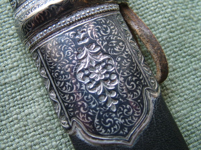

neillo:
Neillo is a completely different animal. In use of silver, one may engrave or hollow out the background sections of silver to make the others stand out. In the recessed areas a special lead-sulfer-oxide solution is applied that blackens the recessed areas of the silver. This is more than simple oxidation because it develops a thick plaque of oxidation that lasts longer than just black or brown patina on silver (which enhances value when taken off unlike bronze). This is a very common method used on Russian shaskas and kindjals. It can only be used on silver. Here is a picture of some common Thai jewelry where neillo is used as background as well as on the shaska from Oriental-Arms. Both cases are of course made of silver:

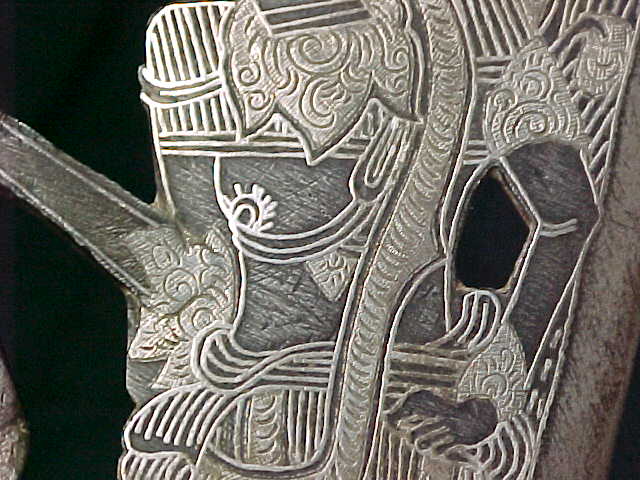

koftgari:
Koftgari is a technique that first scars the hard metal, say steel, by incising or cutting lines into the surface. Then the artist takes very thin or flat wire made of soft metal, like silver or gold, and hammers this "tape" onto the cut area. The metal "tape" will be hammered into the incisions and thus will be held in place. It is important to note that these incisions are not as deep and thus the soft metal decoration can wear over time if not careful. Although not as permanent as inlay, the artist can produce more elaborate designs. Most of the examples of koftgari come from 15th-16th century India. Here is an example of heavy silver koftgari on a steel Balinese ceremonial axe (notice the lines on the steel):

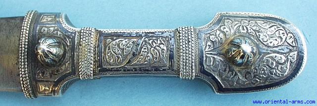

Gentlemen The throat of the scabbard of a caucasian kindjal. Chassing in center, niello all around
Old 16th December 2004, 09:55 PM   #17
Posts: 7,416
Yannis, that is some beautifully repoussed and neillod work. Excellently executed. Thank you for sharing this.

Default Help
Yannis
Thanks for the suggestion to share our good stuff for review!
I was going to make an attempt to say just what type the inscription was, after studying you information, but chickened out! Would you please tell me what type the inscription on the blade is and maybe even the hilt and sheath in the back ground.
Thanks
Mare Rosu is offline   Reply With Quote
Old 19th December 2004, 08:15 PM   #20
Posts: 7,416
Yannis
My apologies. I think I was seeing an optical illusion (or a senor moment ). From this other computer screen, I can now see that in fact it is chased. You're right in that chased is exclusively from the top down onto the metal.
Mare Rosu
Your inscription appears to possibly be a bismallah ("name of God") and done in gold koftgari with some line engraving around the borders of the bismallah. You can even see a little of the koftgari wearing at the edges. Overall, excellent condition of koftgari.
The scabbard in the background is difficult to see. If you could post clearer pictures, that would be helpful. I would take a stab at a possible mixture of soldering of silver pieces and silver stylized wire with perhaps some chasing, though again, I would need clearer details.
The hilt section in the foreground appears to be repoussed, although I have seen and done some chasing work that, if done the right way, can appear to be repoussed like this silver scabbard section that I chased years ago (my second attempt at a scabbard):

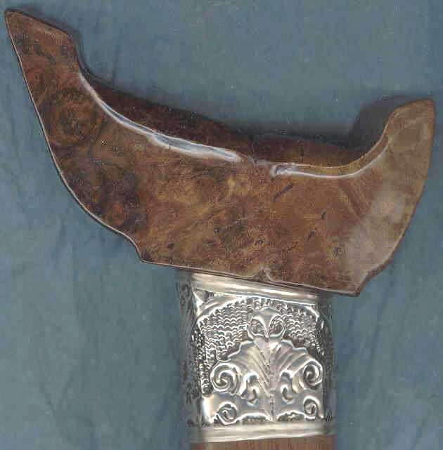

As you can see, one can be fooled because the metal is pushed back in parts allowing only the none hammered parts to remain looking like they are pushed out. It can become very confusing at times.
Another note: to repousse something one needs to use thinner sheet metal. Chasing, on the other hand, can be used on almost any thickness.
Old 19th December 2004, 08:25 PM   #22
Posts: 6,441
Thumbs up Nice Burl
What kind of wood Jose ?
I really like the design on the band also !

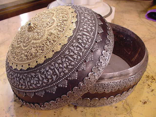

The wood is burled walnut on top. Thank you. I extrapolated the design from the kris hilt patterns in the kris shown as my avatar. I tried to match the theme done in swassa on the hilt:
