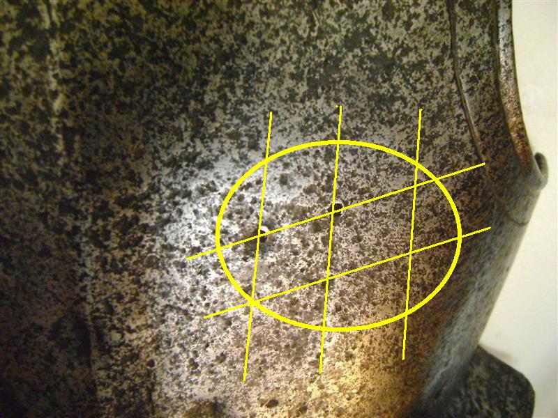

those holes seem to be lines of three indents / holes .....a trident attack / damage

But then, it would have to be a 'fivedent' .
Don't know ... aren't the (five) holes too round for that ? wouldn't trident spikes be of angular cross section?
What sort of tridents? was there such weaponry around this cuirass environment?
Fernando

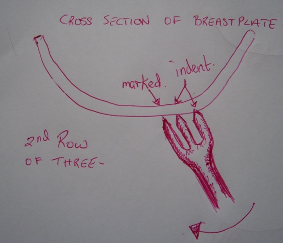

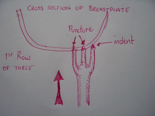

Hi Fernando,
the idea of the 'trident' was alittle 'tongue in cheek' but, I hope the pictures and quick (but poor ) diagrams may explain my reasoning....
Regards David
Old 10th July 2009, 06:05 PM   #11
Hi David,
The diagrams are excelent and self explanatory.
I just wasn't swallowing the combination trident vs cuirass in the same scenary. I would also expect that trident perforations would leave an angular mark, not roundish. But that was only my reflex reaction, not necessarily an everlasting one.
I had a feeling you would react ; not with the sketches, which are super, but with a link showing period soldiers handling a trident. This is actually my main problem with this hipothesis.

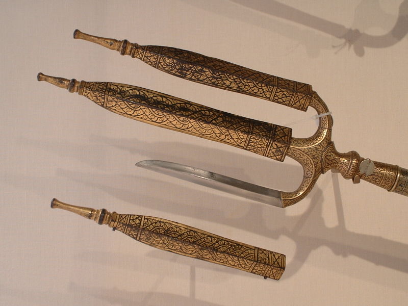

perhaps not necessarilly a 'trident' but a trident 'headed' polearm. Millitary forks were a popular form, commonly two pronged ...but not all were. Usually used against horsemen but also foot soldiers.
The trouble is .....googling 'trident and weapon' usually brings up the nuclear missile ...and I suspect the armour would be little protection against such a weapon
Regards David

casually browsing the web ....I came across this picture of a magazine....dated circa 1850 .....entitled Bornean weapons.
The Spanish were in Borneo, I believe, late 16th to the 19th century.....notice one of the spearheads
Regards David

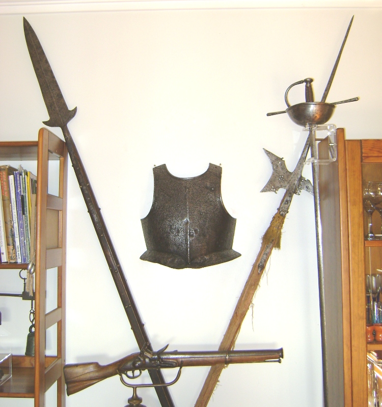

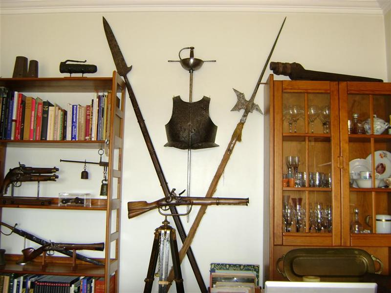

By the way, i have recently unhanged this item from the wall, to rearrange some weapons display, and noticed that the riddling holes only perforated the first layer of steel, having not gone through ... for what it matters.
Much of a coincidence if they were made by the prongs of a weapon .
... More likely a mechanical operation, for the hanging of whatever ? . Not much logic in my reasoning, is there? .
Case not closed, anyway.
May i show you the new rearrangement?
Have a sunny Sunday, my friend .
Fernando

your display is a bit 'cluttered'......GET RID OF THE FURNITURE
Could the second 'layer' (of the breastplate) be a later addition ? repair ?
Sunny Sunday ... In England
All the best
Old 18th July 2009, 07:21 PM   #21
Originally Posted by katana
... your display is a bit 'cluttered'......GET RID OF THE FURNITURE ...
I am working on my wife for the due agreement .
Oh no, i don't think so ... at all. Just the way to make these things on a reinforced basis, i would say.

The trident-thesis is quite fascinating, but I'm not sure if these marks could have been made by any form of weapon. Don't want to spoil the show, but I doubt that any hand-held weapon could do that kind of damage...
a) Imagine the setting: A spanish soldier is in close-quarters with a native let's say Indian fighter who is using his trident to stab at the soldier. He must use an awful lot of power and speed to procure this kind of punctures. Because normally the metal would either bend inwards (three spikes transferring its energy on a broad area) or the trident would just scrape the metal (which should leave visible scratches). The last case might not happen if the Indian is stabbing at an angle close to 90 degrees in regard to the breastplate. But referring to the sketches this seems unprobable.
b) The form of the punctures also speaks against a battle damage. There are two sets with 3 marks each, which are nearly paralell.... the Indian must have had good eyes to execute the second stab just to get this design
And now comes the really hard part:
I must admit I have no other explanation
All the best
William
P.S. Perhaps some kind of marking that the piece was sorted out of the regular armoury equipment. Similar to the X used by the english
War Departement to mark gund which are to be sold to civilian distributors...
William V. is offline   Reply With Quote
