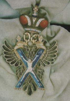

Posts: 6,027

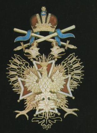

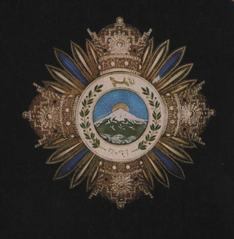

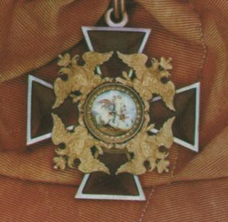

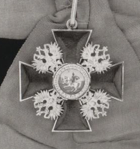

I found these pictures of orders. The crowns on the Russian orders are similar to the crown on the scabbard of the knife. The sticky out side bits are prominent on the scabbard crown but it is still more like the Russian crowns than the persian crown on the order that shows a mountian and has Persian text. Is there Persian text on the blade?

I asked friends at the russian forum.
The crown is that of an un-titled Russian aristocracy ( kind of who had a right to be addressed as "sir", but had no title of a baron, count etc).
The letter is obviously Russian Sh, but no relations to the Sh-ah of Iran: just an initial, first letter of somebody's last name.
The date ( barely seen) isn't it 1331? 1912 Gregorian. Last good days of Russia.... It went downhill from there on....

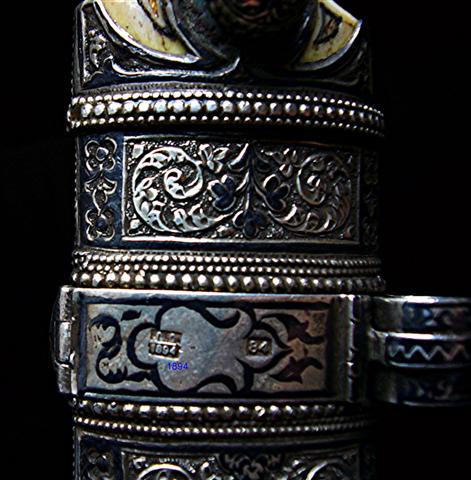

Here is a photo of the other side showing a date of 1894, that would clearly be an indication the numbers/letters on other side are not a date.

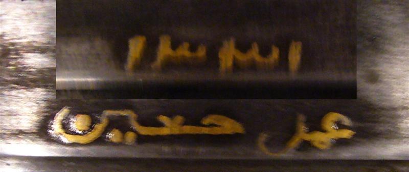

Sacre Blu!! When you mertioned 1331 I was thinking you were talking about the silver repoussee!!! Here is a close-up of the inscription on the blade with as you pointed out is 1331 and also has an owners or makers name. Interesting to note the silverwork is stamped with a date 1894 and the blades inscription is 1912-1913.

It's usual thing that the blade could be changed during period of use

Stamps on the scabbard are the probirer's marks. 84 is purity of silver.1894.. I will have to look in the books.
