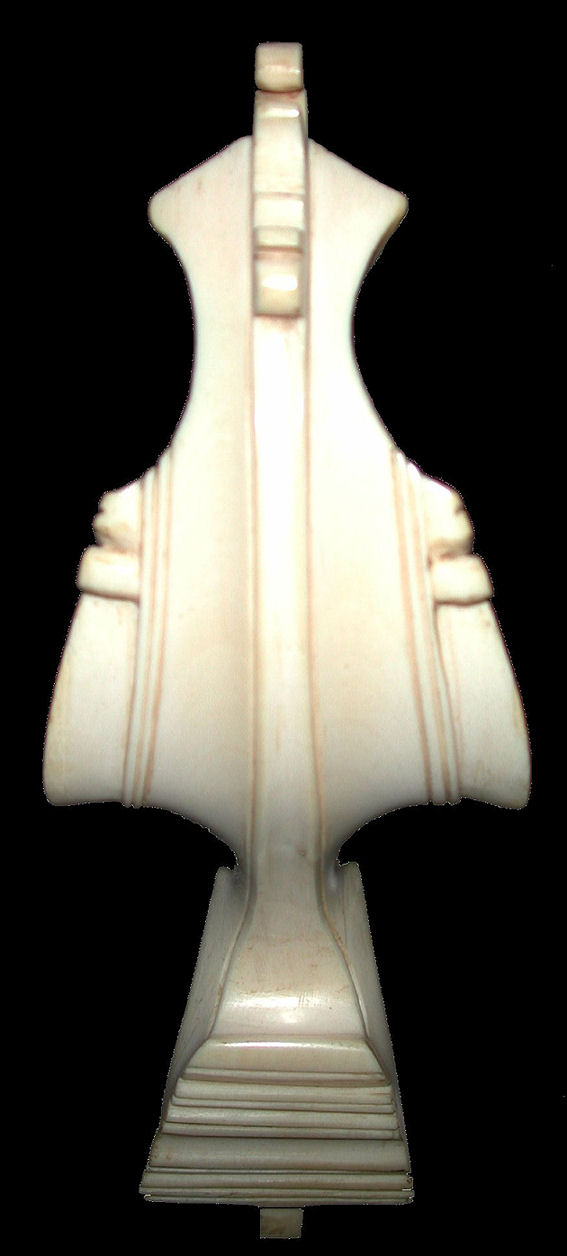

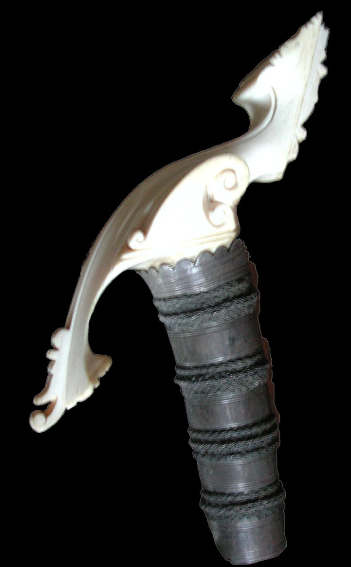

For those who like it (sorry for the poor picture quality) both side of the Knaud kriss and a famous handle.
Knaud's kriss is dated from the beginning of the 14th century...has been lost and found back in a drawer...

Wow!!! Thanks so much. I had no idea that this important keris had been found again. Of course, the idea that it could have ever been pushed into the back of some museum storeroom draw is just plain nuts! Perhaps more research can now be done on this piece. I have heard that some experts have suggested some doubt to it's reported aged.

According David van Duuren
"it's a present from a javanese prince to the dutch physician Charles Knaud in the end of the 19th century. It is dated, engraved in the iron, 1264 (i.e. 1324 Christian Era) but of course it can have engraved later on."
For sure, the shrine of Candi Suku is from the 15th, so we have at least this thread to go with...

Yes it's copper on both sides. As I said, I'm sorry for the quality and that include the color. I had to make the pictures through the glass and with the fixed lights of the museum.
I have now a better camera and will try to bring back some better pictures next time I go there.
And for Battara, yours not bad too.
here are larger pictures
