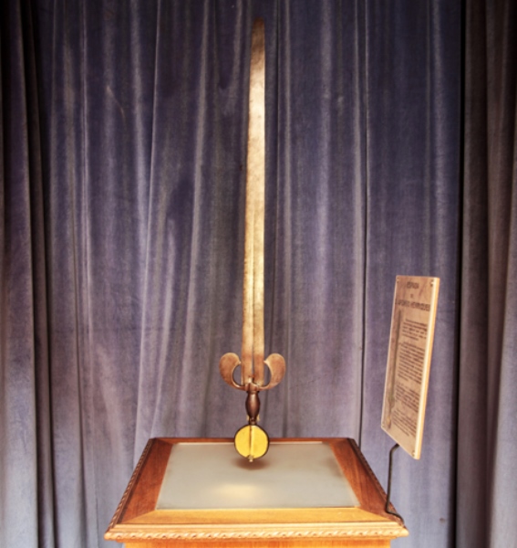

In 2007, the Spanish noble owning Tizona, though it had been on display in the Royal Armoury in Madrid since 1944, decided to sell it to the Cultural Ministry to display in Burgos near El Cids burial location. The authenticity of the sword was contested, much likely due to the hilt form which was of style much later, 14th to 15th century in Hispano-Moresque fashion. As that battle ensued, the metal of the blade was tested metallurgically, and again...one version claims the metal corresponds to 11th century Cordoba, while other views hold to the 14th-15th century assessment.
The Colada, also in Hispano-Moresque mounts of that period, remains at the Royal Palace, seeming to attract much less conflict, as it seems generally held that its authenticity is probably questionable at best.

Let´s stick to the facts. The Tizona was mentioned on literary sources only, in the times of El Cid. Latter, on the year 1503, Gonzalo de Bricio, by mandate of the Queen Isabel La Católica, makes an inventory of the weapons existing in the Alcázar of Segovia, and among them describes the presence of the Tizona". Fray Prudencio de Sanvoval, in his chronicle of Kings of Castilla and León, mentions the Tizona, which is kept on the hands of the Marquee of Falces, since it seems it was gaiven to them by the King Fernando El Católico as a reward to their services, with the condition to bring it to the royal palace on the swearing of Kings of Spain. The Marquee kept the sword until 1936, when it "disappears" from their residence, along with the probatory documents. The sword "reappears" after the Civil War in the Castle of Figueras, in 1939, and it passes to the Army Museum in Madrid.
We don´t know if the sword on the hands of the kings was really the Tizona, we don´t know if the re-appearded sword is the Tizona, and I personally don´t know if the legitimacy documents, signed by their Catolic Majeties, were also found.

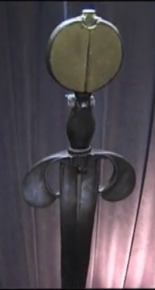

Of this sword, it is said that the hilt is not original, but rehilted in the times of the Catolic Kings, almost five centuries latter from the times the Cid lived.
The hilt is clearly european, and the blade, according with the clasification from Oakeshott´s book Records of the Medieval Sword, seems to belong to the XIII type, though all the hilt with guard and pommeal from this sword are clearly from the Reanaissance. Not like a sword taken from a moroccan nobleman, though you stated, without references, that frankish swords were exported to North Africa. You have to take on account that the almoravids were berber specifically.
Is this sword autentic? Are the laboratory sudies from the Complutense University trustworthy? Are there some valid proofs which relates this sword to the Cid? It exists the possibility that this sword was used as a symbol and for propaganda purposes in times in which new regimes were beginning to consolidate, and there was a need of national symbols to create a sentiment of unity on the country. Curiosly, the Cid seem to be fought more time at the service of the moors or for his own interest, than at the service of his catolic king, against who also fought. Something Hollywood and other "sources" conveniently forget to mention. Colada means "cast" in spanish. It is mentioned as taken as a battle trophy from Second Count of Barcelona, Ramon Berenguer, so it´s origins before are not clear. We have to mention that Barcelona was a county in which the metallurgy was at the higher level on all the christian iberic area. The catalans or catalonians, inhabitants of the County of Barcelona, were the first to produce casted iron (iron very pure for the standards of those times in liquid state, produced in the fargas catalanas or catalan forge), in what today we call Spain, though the arabs were more advanced in this sense. Please see from Fernando Olaguet-Feliu Alonso, Arte Medieval Español hasta el Año Mil (Medieval Spanish Art to the Year 1,000, pags. 285 - 286). We continue.

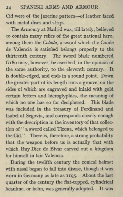

The excerpts below from Spanish arms and armour, being a historical and descriptive account of the Royal Armoury of Madrid (1907) will be my humble contribution to this very interesting topic!
What surprised me in browsing the said book is the dearth of info on the colada and the tizona. Perhaps somebody can tell us the 'inside story' there?

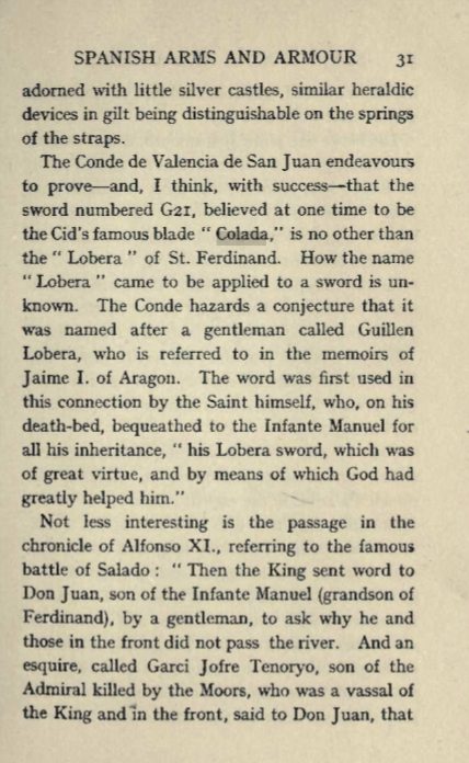

While I could not think of any specific reason for the brief mention of these two most important weapons, it does seem that Mr. Calvert was amidst considerable sensitivity as he was a guest in this cataloguing and description. In the assistance provided to him by the Conde de Valencia de San Juan, some of the material discussed reflect the degree of concern toward the sword once thought to be Colada, now considered the Lobera of Ferdinand III.
The sword next to it was noted as having been attributed to Roland erroneously, but now 'possibly' one of Ferdinands swords (G22).
Tizona was mentioned, but at this point without going into greater detail, only suggesting the sword there was quite likely the true Tizona.
I think that with weapons of this stature, Mr. Calvert wisely limited his review of them to the levels of information shared by the Conde, and avoided further speculation.
Moving on, I think what is most interesting here are the entries on the G21 sword formerly thought to be Colada, and now believed to be the 'Lobera' of King Ferdinand III (King of Castile and Leon, reuniting them in 1231).
It is noted by Calvert on p.32 (...how the name Lobera came to be applied to a sword is unknown).
What is interesting to me is why the question about the Lobera name for a sword, and speculation about the name of a person reflected in memoirs . It seems worthy of note here that in this reference, the sword is referred to as a "lobera sword" and of its great virtue. Somehow there is key focus on the naming of this sword, yet the names of Tizona and Colada are not really reviewed here or it appears in any depth in other references I have seen.
One thing I would offer here for consideration, is another reference in the Calvert text (also p.32) referring to the virtue of ones 'lobera' sword, in a seemingly more general reference.
In looking into what I could find for translation of 'lobera' it seems that the term in variation refers to a wolf pack or wolves lair. While admittedly reaching at this point, I find it interesting that roughly in this period, the concept of using a wolf as a marking guaranteeing the quality of a blade was about to become a known practice. This would be in the established arms making location from earlier Roman Noricum that became Passau. In trying to locate a place name in Spain that would have the name Lobera, it seems that in Zaragoza there is a municipality named Lobera de Onsella.
In later period the famed swordsmith Julian del Rey is said to have used the wolf marking, working in both Toledo and Zaragoza. While it is unclear whether the image used is actually a wolf, or possibly a lion, it has been generally held that it was a wolf (actually referred to as a perillo =dog).

Well, if Calvert´s descriptions are as erroneous or ambiguos as the mentioned in many pages, we have serious problems. Calvert speaks of a coat of mail composed of "scales" (pag. 19), and his lack of knowledge of castillian does not permit him understand many words from the poems related to El Cid, like "lóriga", which designates in fact a scale armour, and he translates as "riven mail", meaning rivetted mail and "huesos", which means "bones", as leggins (pag. 23),.
Also, Jim, "Lobera" in spanish means two things. The place, den, cave or hole where the little wolves born and are raised, and if referred to a sword, it could mean a sword to kill wolves. It does not necessarily designates real wolves, as the word could be used in a poetic sense. Lobera is the equivalent of the italian word "lupara", which designates a shotgun to kill wolves, a shepherd´s shotgun. Also, there is a mention of this sword as belonged previously to a chevalier who´s last name is Lobera, and this is also a very plausible and acceptable explanation of the name given to the sword.
The Colada is actually mounted in a 15-16th Century style and the blade looks of a newer model than the Tizona, IMHO.
Gonzalo

According to my sources, the blade contains a large ammount of damascus-steel.
I'm relatively sure, it was forbidden to export damascus-steel raw material in these times(!).
So it is possible, that Tizona was forged in India or maybe Iran and later conquerred, bought by or given as a present to Europeans.
The sword got two inscriptions:
IO SOI TISONA FUE FECHA EN LA ERA DE MILE QUARENTA
"I'm Tizona, made in the year 1040"
and
AVE MARIA ~ GRATIA PLENA ~ DOMINUS TECUM
"Hail Mary ~ Full of grace ~ The Lord is with thee
